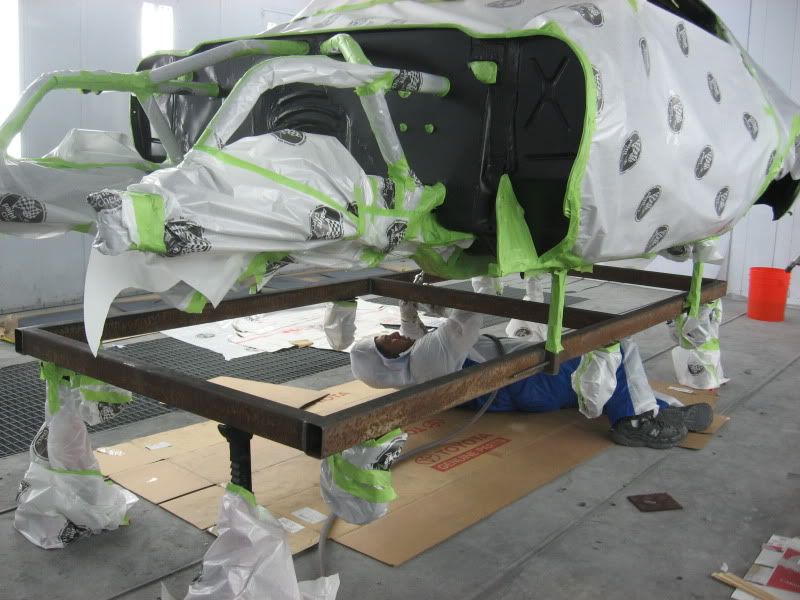

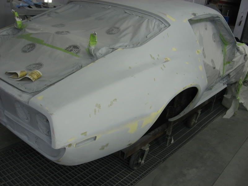

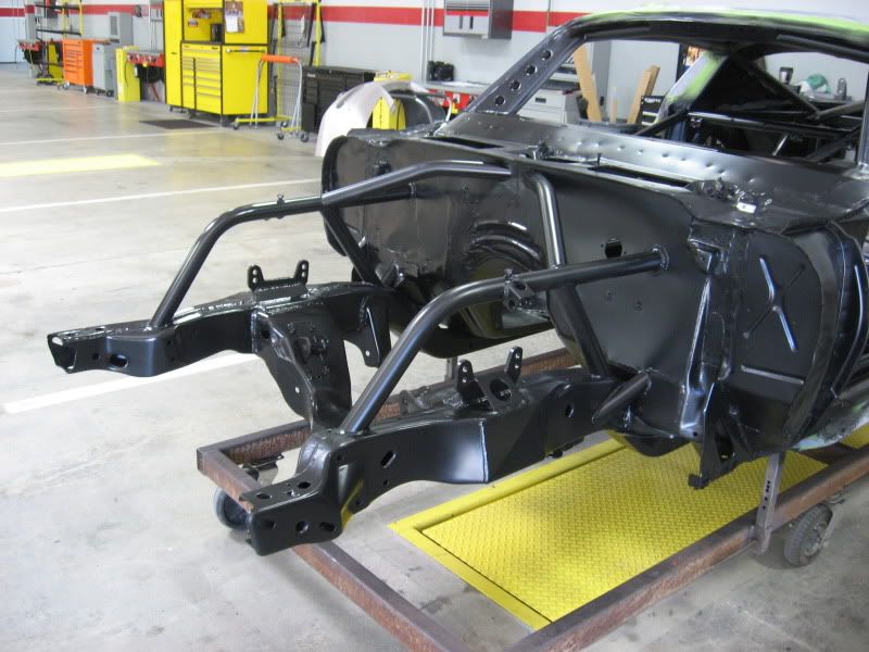

The body is back in the booth after blocking for round 2.

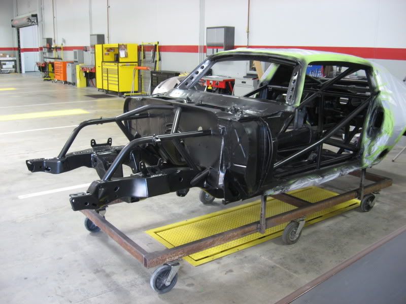

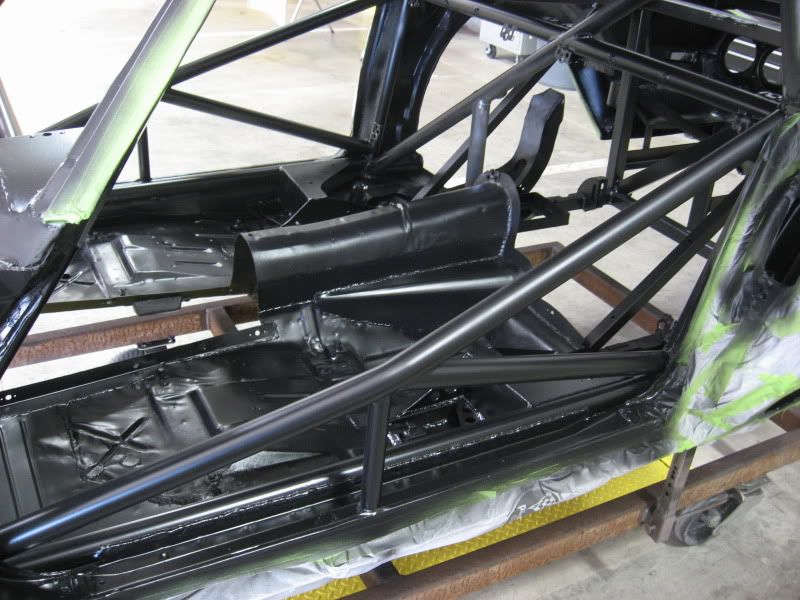

The cage, floor, and firewall are now primered. The next step is lizard skin will be applied to the firewall and bottom of the floor. The firewall will then be sanded smooth. The inside floor will be coated with UPOL bed liner. Finally, the cage will be painted grey.

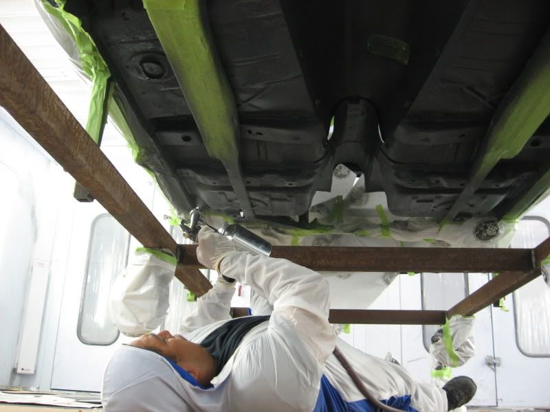

The first coat of the Lizard Skin got applied today. This was the sound deadoning coat. Ceramic to go next.
