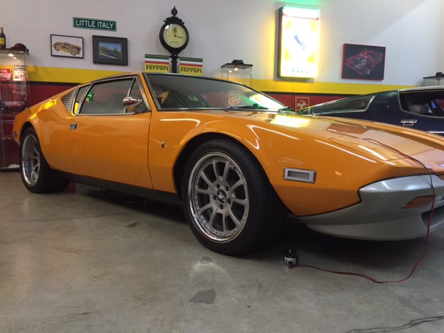

I had the opportunity to poke around a pretty bitchin Pantera over the weekend and got to thinking.....How the heck does Bob fit in this thing? If I remember correctly, when we talked at Thunderhill you and I see eye to eye. How'd you do it?

Didn't matter how much fancy beer I drank, I barely fit.....maybe I should have had wine. This seat has been dropped three inches and I couldn't imagine working with a suit and helmet on. Still love them!
