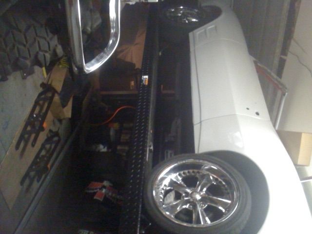

Here is the 67 400 coupe pic form a couple weeks ago (still ways to go)
and since you are into 90210 body changes, here is what I did on the 68 vert (Lolla), shaved rear gills, and incorporated 69 front fender scoop insert sections:
not the best shot but close to how she sits now:

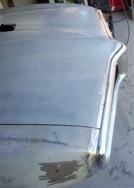

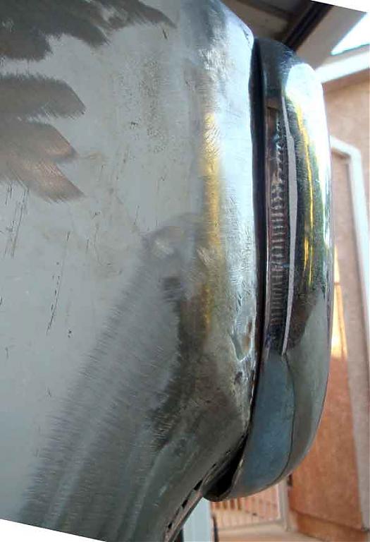

The front bumper is still a work in progress. I also had to shorten the lower bumper brackets to get the bumper to sit closer to the body. I spent most of the weekend aligning the body to the ends of the bumper. I also added flanges on the inner edge to help eliminate visible gaps and light shining through. I also had to push some of the fenders out along the bottom edge to sit closer to the bumper. I have some "before" and "after" pics. you cna see the improvements. From that I now need to reposition the header panel as it's causing interference with the hood shutting fully. It got pulled inward as I attempted to get the bumper to sit where I wanted it. After that I need to add some material along the edges of the hood itself and the bumper to get those gaps right. They just don't align to my satisfaction.

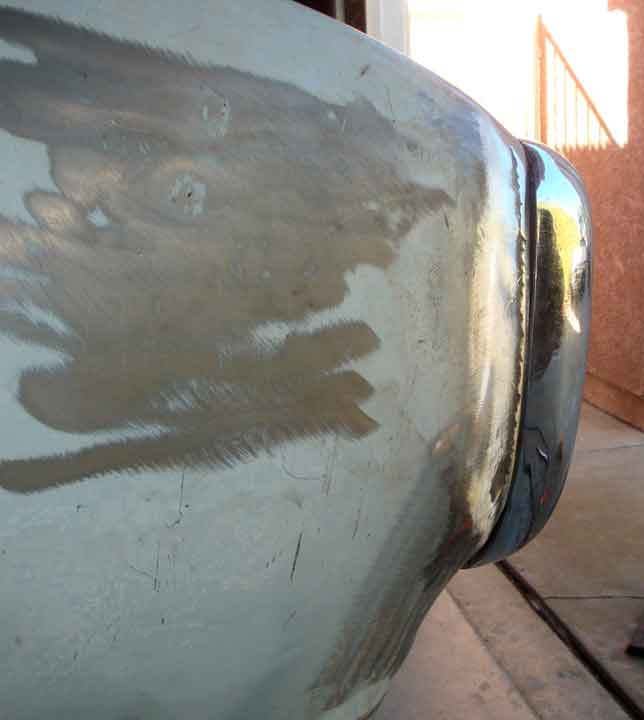

I had some time on Sat to work on the front bumper fitment more. Not done yet, it still needs tweaking. Attached are images of the flanges I'm making to help the front bumper stay put and not let light through as I'm not using those rubber gaskets anymore.
