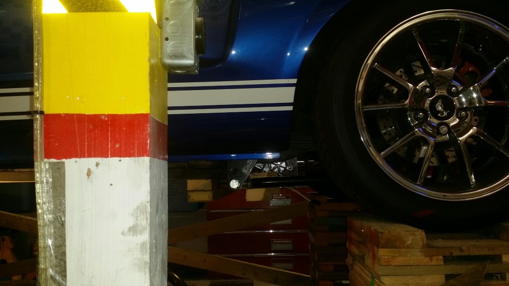

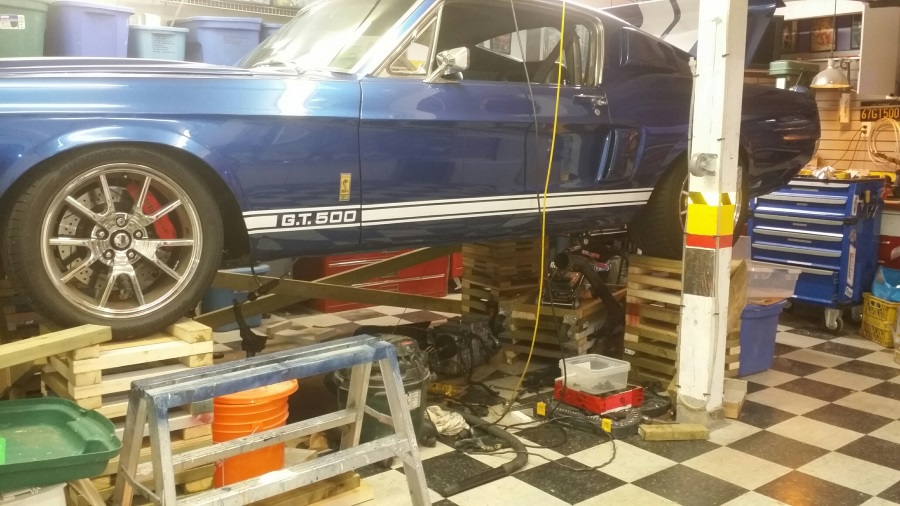

An annoying vibration was present in the clutch/flywheel. I decided to get off my butt and find out what was going on.
I made up some cribbing to get the car nice and high, and pulled the trans.

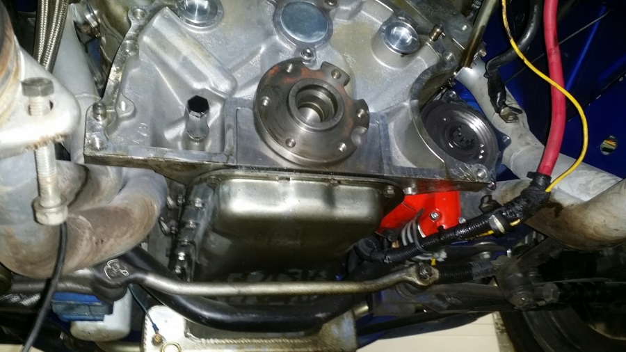

1st the pilot bushing fell out. So that was not good but common with the FE's
So fixed that, and put the dial indicator on the bellhousing. It was perfect, after spinning it several times.

I got the starter working properly again.
When I checked one bolt seemed fairly loose and another slightly loose.
I just backed up all three bolts, juggled the starter and then snugged everything back up.
All back to normal.

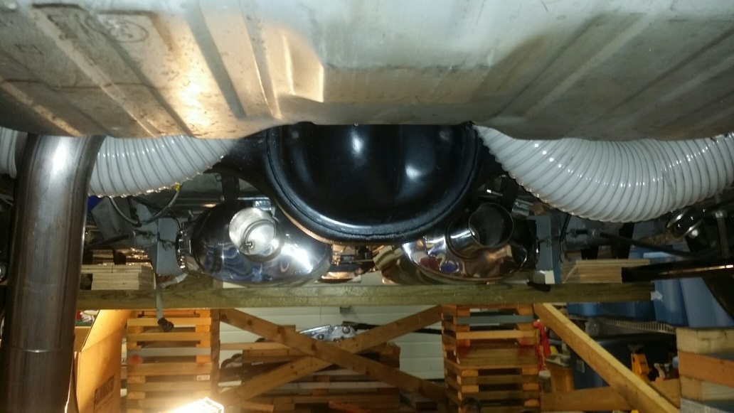

Well I ordered the new mufflers that I want to use. Similar to what I have now, except the patriot varaflow mufflers are much too small for the stroker FE.
Too loud in the car, actually deafening at times (I must be getting old lol)
I just have to see if I can find someone that makes a 3" tailpipe set that I can order separately (not a whole kit.)
These will be a 3" in 3" out, with some very custom oval pipes around the trans and x-pipe to work with the low to the ground chassis

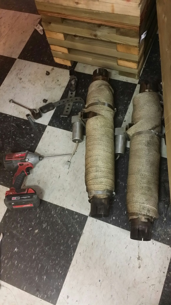

Started working on replacing the old 2 1/2" exhaust and too small mufflers, with the 3" exhaust system.
I have demoed the old exhaust, and am mocking up the new mufflers.
I have bought a flex coupling to put inline in the system somewhere, to reduce transmitted vibration. I have to put it up in an area that gives me enough ground clearance.
I'm looking forward to having it done, already and I am just started
