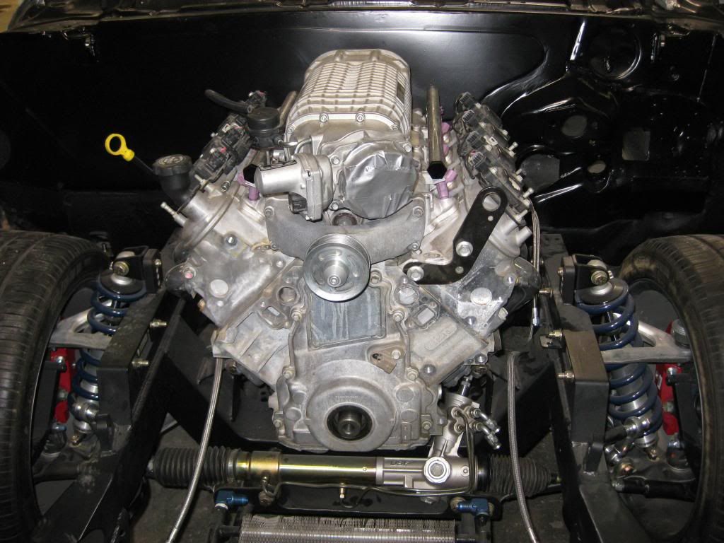

I've had alot of PM's an Email's about my new build.It's a 1966 Chevelle that I found on Craig's-List.It was already painted the right Color (Silver).No chassis work had been done to it,Just a 383 400HP small Block.I pulled it and gave it to Brandon for his Javelin.I am dropping in a Mike Norris tuned Super charged/cylinder headed & cammed LS2 & T56.I cut off the stock chevelle frt. suspension and welded in a C-6 clip Fully boxed the chassis,ABC performance rear frame notch kit & mini tub's.Ride Tech triple ajustable coilover's,Ridetech rod end A-Body rear 4-link,Moser FullFloater 9" W/3:90 gear's &posi.Forgeline's 18 x 12's ZX3's w/titaninm center's/polished lip's PS2's 335/30/18's,ZO6 brake's,Vintage AC,3" Stainless Exhaust,Borla Muffler's,Rick's stainless Tank,Eddie Motorsports Frt Drive and Billet hood hinge's,American Atowire Harness,Stock OPG interior,Kirkey or Scat Seat's,1.75x.120 DOM Roll cage,Full custom auto sound Radio/XM/CD player,Trailer hitch w/2" stainless Ball.Diff,Rear end,oil,Power steering Cooler's

It's just about ready blow apart and start the powder coating & underside painting.

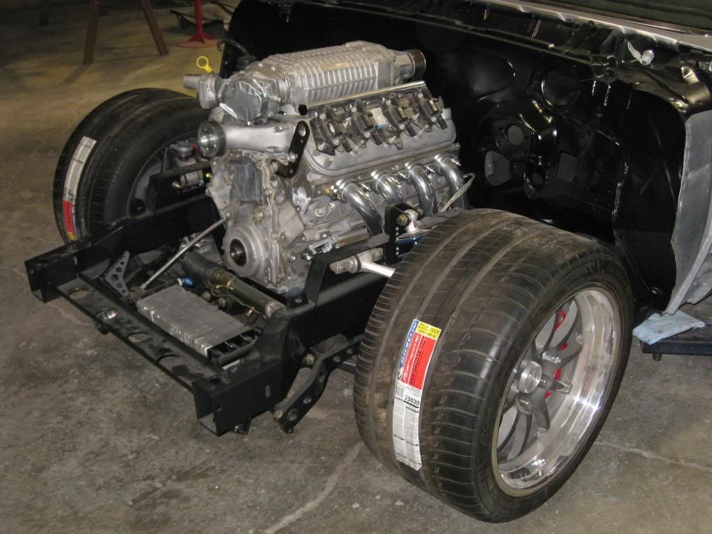

Old 09-09-2012, 05:53 PM
coolwelder62's Avatar
Join Date: Aug 2005
Location: Vinland Ks.
Posts: 4,315
Front tire's
