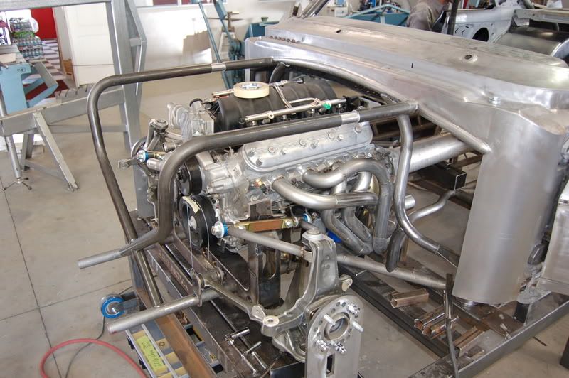

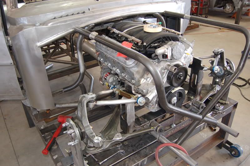

Got the Front UCA geometry all set up. Tubular UCA's are for mockup only. We wanted to make sure all the measurements were right on before we started CNCing the UCA's!
Drivers Side UCA Pick up point.
Brycen putting the headers back on! LOL!
We had to figure out how we were going to get the Transaxle and diff out if they needed to be fixed so we used some Step Joints(Thanks Pauza!)
The guys wanted to get car off the jig and on the floor so they've been finish welding a lot of the joints on the frame. Forking it off the Jig!

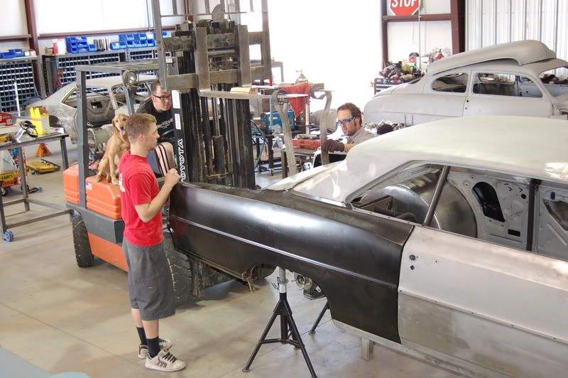

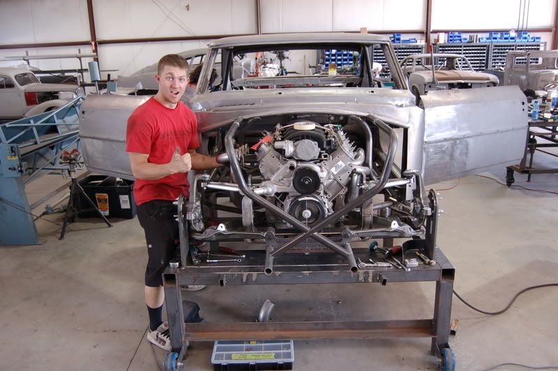

Rodger borrowed some wheels, since I'm a dumba$$ and I can't decide on what wheel I want, and put them on the car! Jake the wonder dog taking it out for it's maiden voyage!
Whatever Sean may lack in stature(Yeah! like I'm some basketball player!!) he certainly makes up for in his fab skills. He's 5' 7"! The man is magician and the TIG is his wand! Sean standing next to the car to give you a perspective of ride height!
What do you think?

is that ride hieght? Looks nose up? BUT......dont get me wrong...its going ot sit real good. it has a killer stance in the rear.

Still need to do some adjustments since we just got it on the floor!
What's wrong with 5' 7" - not all of us picked the right parents for height or the ability to tan but that's another story.
The car looks awesome. I love the stance.
I would love to see some pics from the front end looking down the side. I am curious to see how much the front tires are tucked in.
