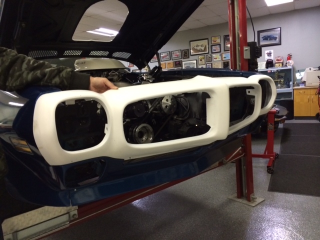

Bob, does the upper cross piece unbolt or did you cut the top of your core support off?

Trey,
Cut it off Going to fab some alum up
and more than likely cut the sides down and use
Aluminum there also. Need to put the glass hood on
to see where things line up
Bob

Finally got back out in the shop and looked at the new
Fiberglass nose from Classic Industries... good to see it has
most of the stock places to bolt things up... I am going
to ditch the heavy main brackets and fab up some alum
pieces with a new alum cross piece... I am going to reuse
the sheetmetal pieces that hold the lights as they are really light
Trying to figure out where the brake ducts will be going
Hope to pickup some alum tomorrow so I can begin the process
Bob

Did some weighing of things last night
Old Euro type bumper 41.7 lbs
Old upper cross piece 11.7 lbs
Two Big steel bumper supports 7.15 each = 14.3 lbs
So total is 67.7 lbs
New Glass bumper is less than 5 lbs.. misc alum 3-5 lbs
So thinking over 55 lbs off the nose
Need to see the difference on the hood next
Bob

Bob,
What upper cross piece are you referring to? In one picture, it looks like you removed the top of the core support... What did I miss?
