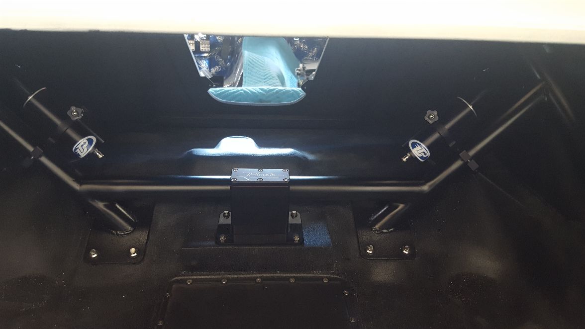

Fitting the rear spoiler Step Four:
Find yourself an extra set of billet hood adjusters you have laying around along with some steel tubing you also have laying around. Cut tubing to proper size, weld in a nut and recess them into the tail panel. Insert hood adjusters and make sure your trunk closes the same every time.

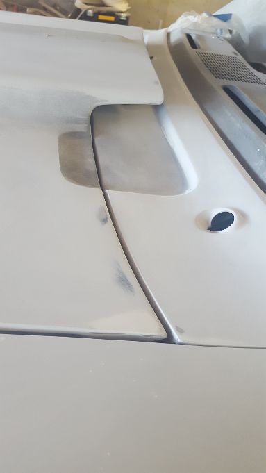

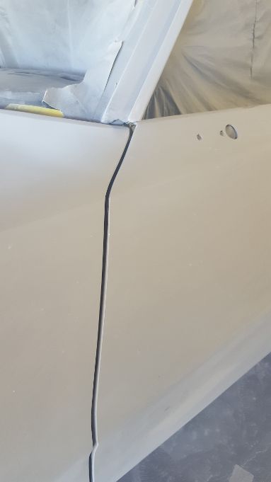

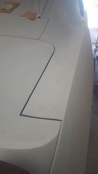

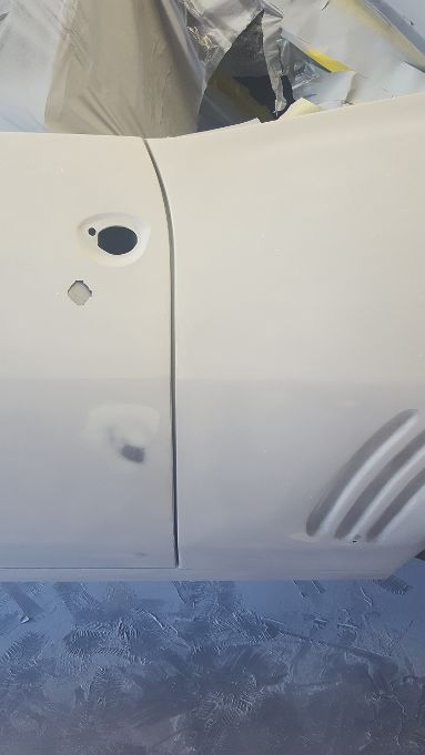

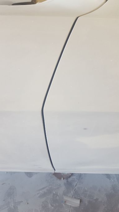

Fitting the rear spoiler Step Five:
Re-intall trunk lid. Hammer and dolly the ends of the spoiler to match the contour of the quarter panels. Add metal or trim metal where needed for perftect gaps.
