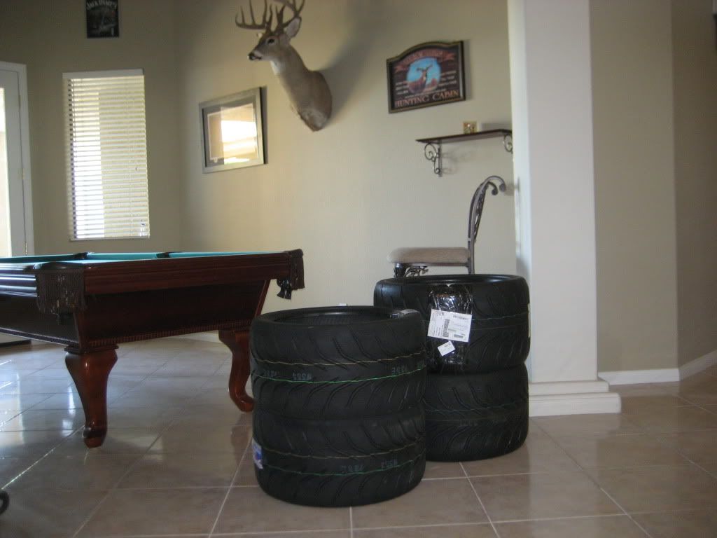

I've got some new rubber that's going on this week as well. My rears are heat cycled out really bad. They are noticably harder than the fronts and I've noticed a really loss of lateral and forward bite lately. They are just plain wore out. Fronts aren't far behind so I decided to replace all four at once. Picked up a good deal on the rear thanks to our resident liberal Ronnie..
