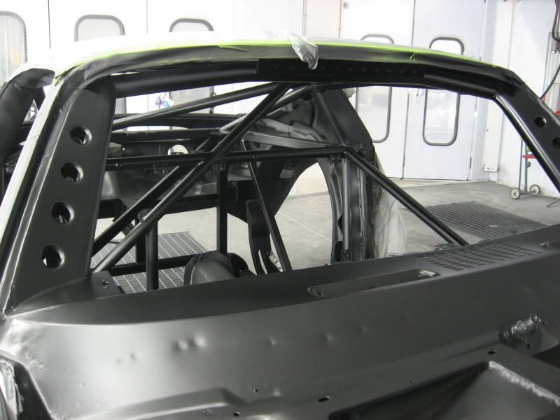

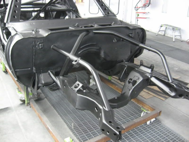

All the Lizard Skin has been applied and everything has been painted satin black. The bed liner will be sprayed tomorrow on the inside floor and trunk.
As the paint shop has been taking care of the inside and underside, the body shop is getting the front end ready to fit on the car. We made it so the entire front end will unbolt and leave behind the radiator support.

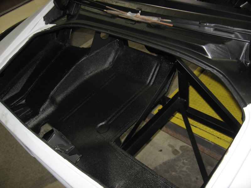

Today, we got the trunk and interior floor completed. Bed liner material was used to give the floor and nice texture and toughness.

Brian what brand of liner did you use.Will the car have iner wheel well's.Look's great.Scott.
  #250
Old 08-17-2010, 05:18 PM
73CPCAMARO's Avatar
73CPCAMARO 73CPCAMARO is offline
Join Date: Dec 2008
Location: Nor Cal
Posts: 570
Thanked 5 Times in 4 Posts
We used the UPOL Raptor liner. Easy to use and looks great. We have used this for truck beds and have been very happy with it. I have done a lot of research for our shop for bedliner material, and the UPOL seams to be the best of all worlds. No special equipment needed except the spray gun.
The rear will have some liners in the quarter panels. Maier Racing will fab those up later.
