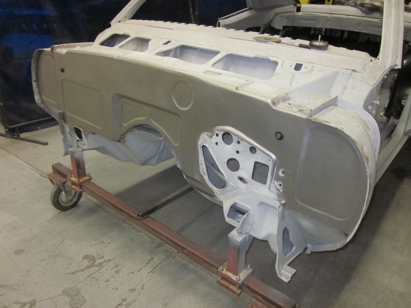

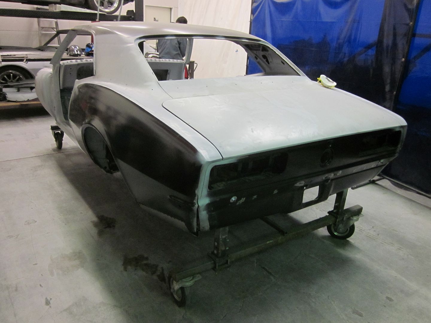

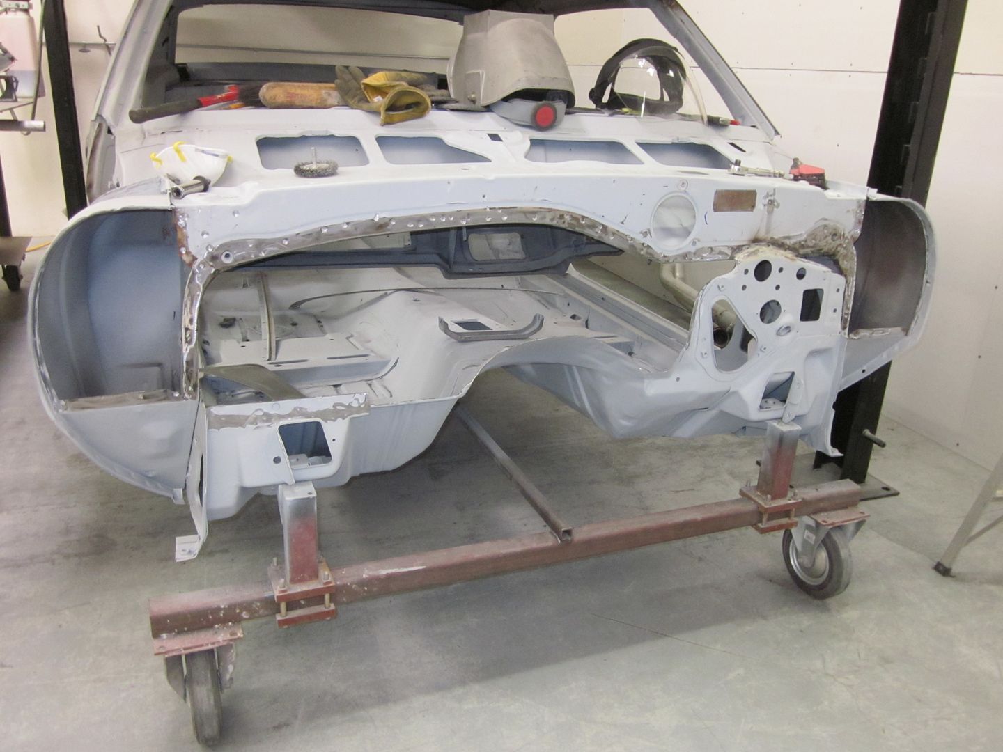

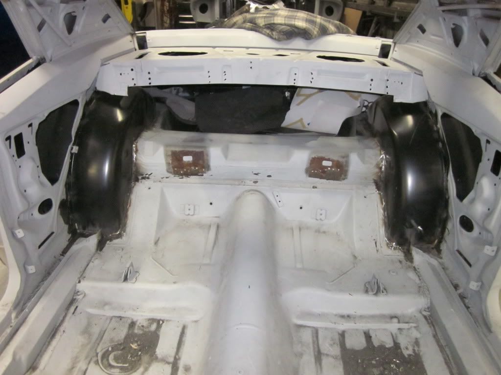

Here is some progresss pics of a 67 Camaro we have been working on...
New roof, qtr faces, tail panel & trunk pan.. The firewall is one of our now standard custom ones.. The mini-tubs are complete.. The first gen Camaro's have a taper towards the rear.. I like to remove it & pull the lower rear of the qts so that when the tire sits with lowered stance.. it will look straight.. Barely noticeable.. but it makes a difference..
This car is an orginal 4P SS car.. We made sure that we put the holes back in stock location for trim tag..
We have something new coming for front & rear suspension!
Cris Gonzalez
