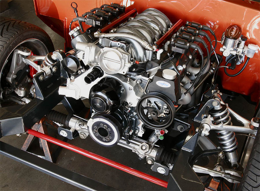

Nope, adding a u-joint won't work. I would need to add a heim pivot joint that would have to be attached (welded) to the frame.. no no on that.
The modified headers fit perfectly and the steering hooks right up. Next week we just have to wire it, fuel it, water it and fire it up.

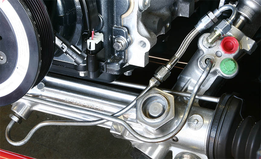

Long day today.. There's a price to pay for trying to have what you want. lol
I wanted to run the f-body LS1 pulley system since I feel it's very compact and has a nice clean look. Instead of the alternator being mounted way high it's down low and tight to the block. I just like how it looks. On my '69 with a regular gear box it was no problem. However with the power rack/pinion it hit the upper hard line. The problem was that he line make a big looping bend and that bend was hitting the back of the alternator.
I cut the tubing so I could use the section with the flare and then drilled and tapped the nut and added a ninety fitting that had a #6 AN on one end. I then had a #6 male welded to the other end of the tubing. This allowed me to get rid of the loop and use a short braided line to give the alternator the needed clearance. As luck would have it the post on the back of the alt perfectly lined up with and hit the new fitting (couldn't have engineered to hit more exactly.. lol). I took apart the alternator and we made a shorter stud that now gives me a wopping 1/4-inch clearance.
Everything fits very tightly, which looks sweet but is a PITA to get right.
Tomorrow the Camaro goes on the rack so we can plumb the fuel lines, secure the tranny, install the driveshaft and we will also run the wiring. The car needs to be done next Tuesday so it can go back to the body shop for the front end re-installation.
Here's the modified steering line:
