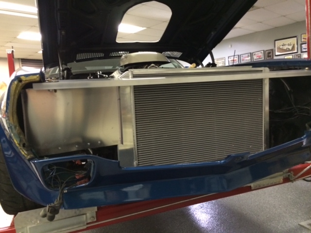

Yes the upper core support
I am going to use an alum C-channel or tube
then alum sides with maybe a couple of angles
It will let me move the top of the radiator forward
slightly as it was tilted back due to the bottom needing
to move forward to clear the steering box
Bob

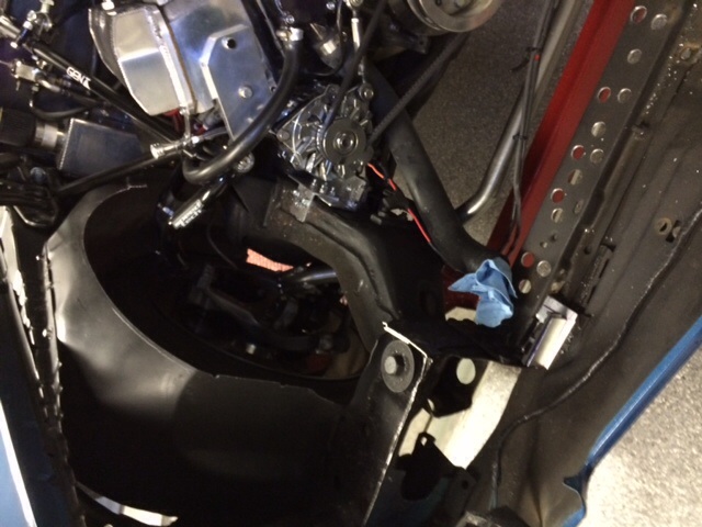

Car was 3710 a few years back according to Ride Techs scales
at the Good guys event.... way too heavy
I have taken a lot of weight out of the back of the car
Now it is time to get it off the front... although I am thinking
of getting rid of the Steves SS tank as it weighs a ton
Will also trim back the inner fenders and maybe remove them
altogether... will see how things go
My buddies and I are planning on buying a set of scales
so we can see where weight is going
Bob

Did some more cutting and prep work today

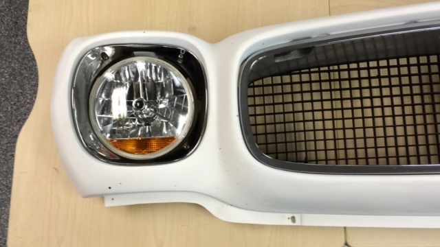

So the front turn signals are going to be the new
brake ducts.... Ordered up a couple of new lights
with turn signals built in them.. and they are plastic
so of course lighter than the originals
Bob

Started fab work on new Radiator supports last night
Bob

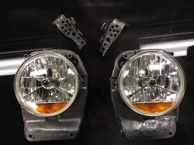

Cleaned up my light supports
and mounted the new lights
I had to open up the back to get them
To fit. Also lightened up the bumper brackets
Bob
