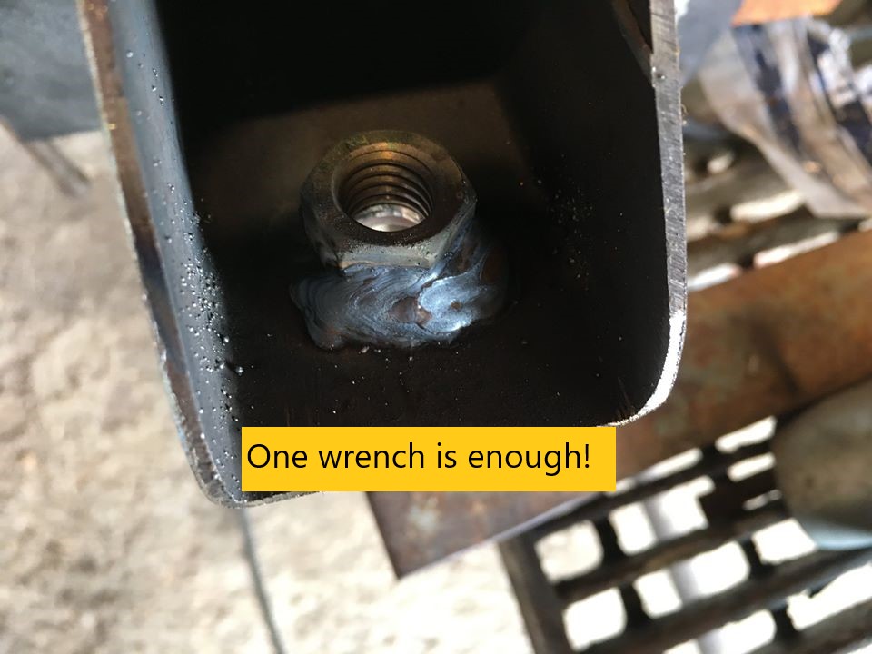

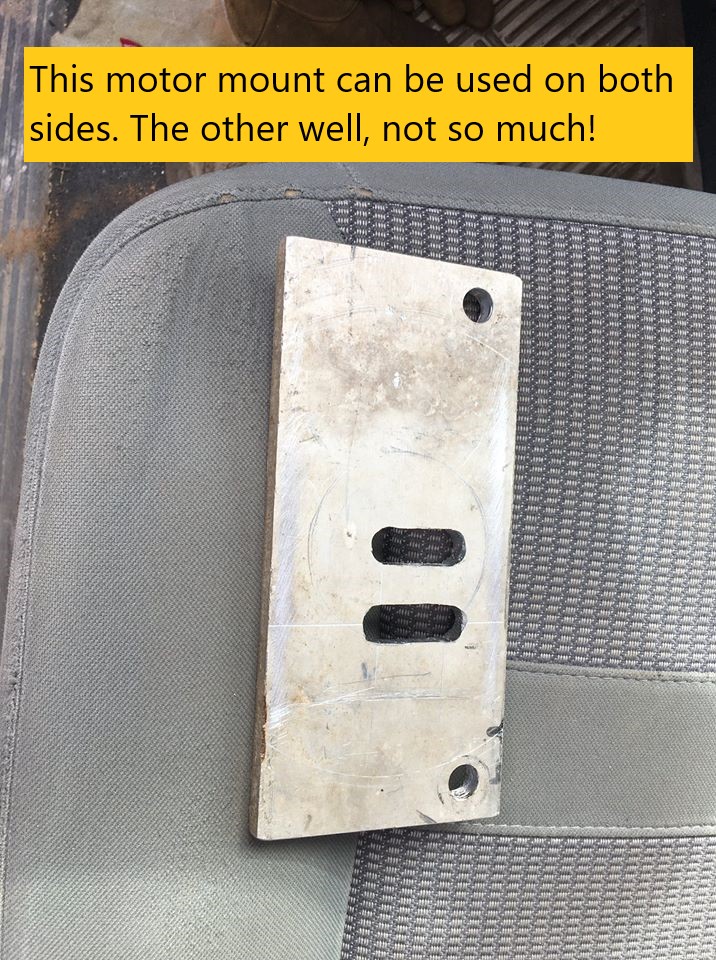

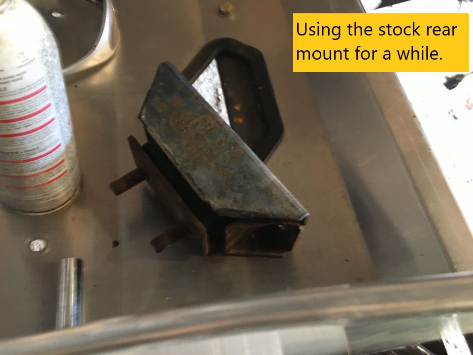

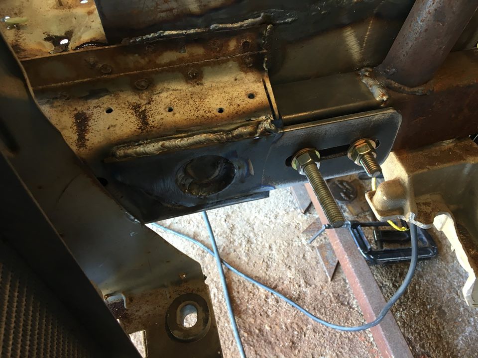

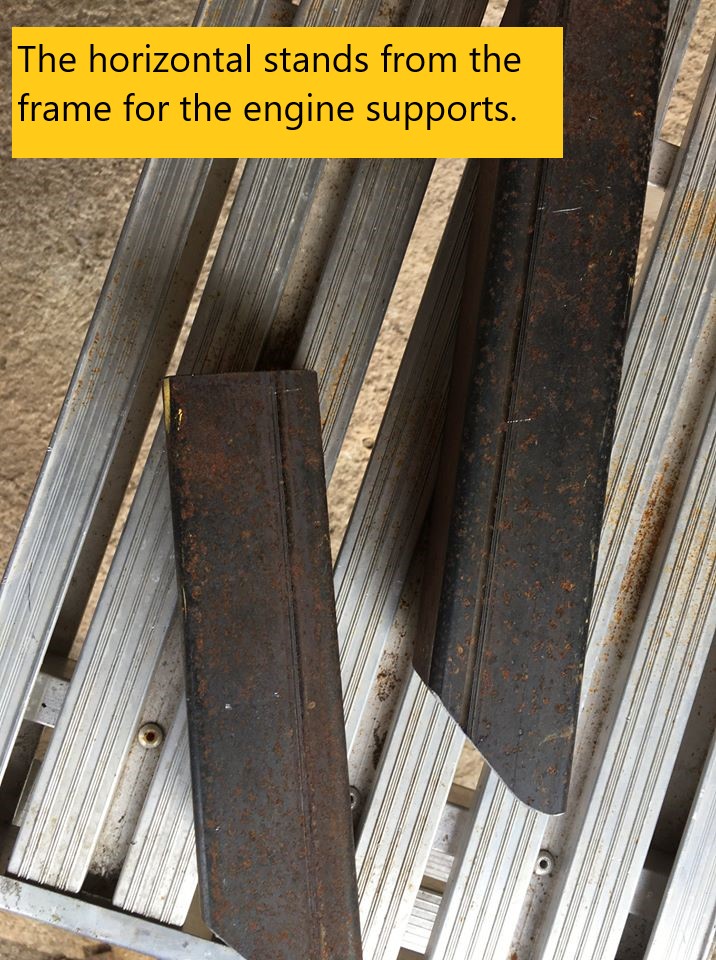

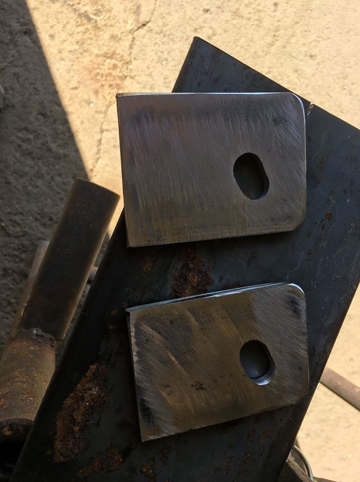

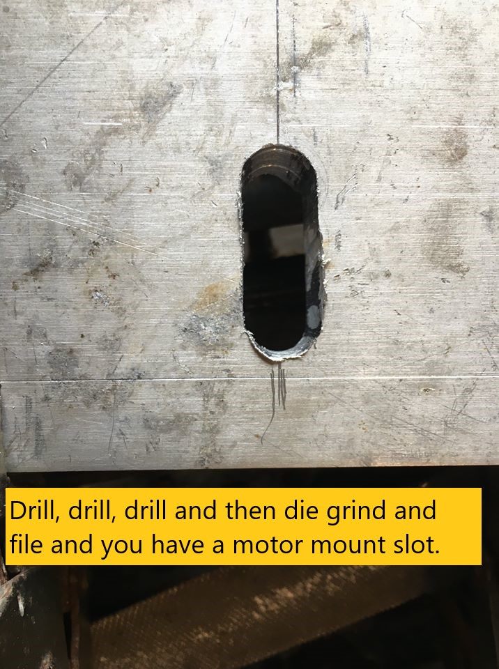

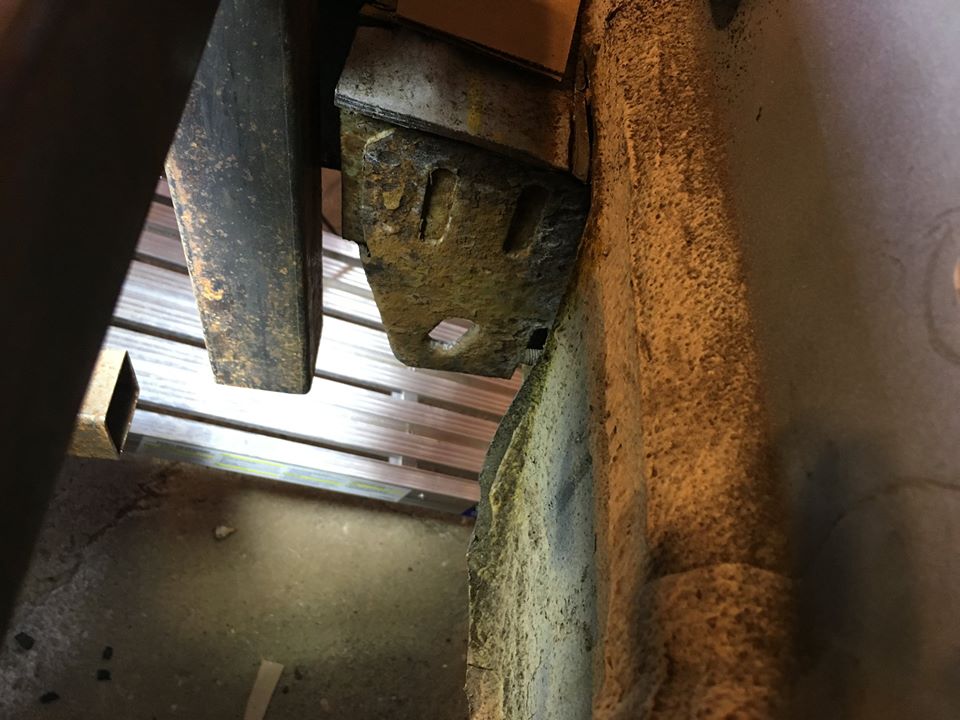

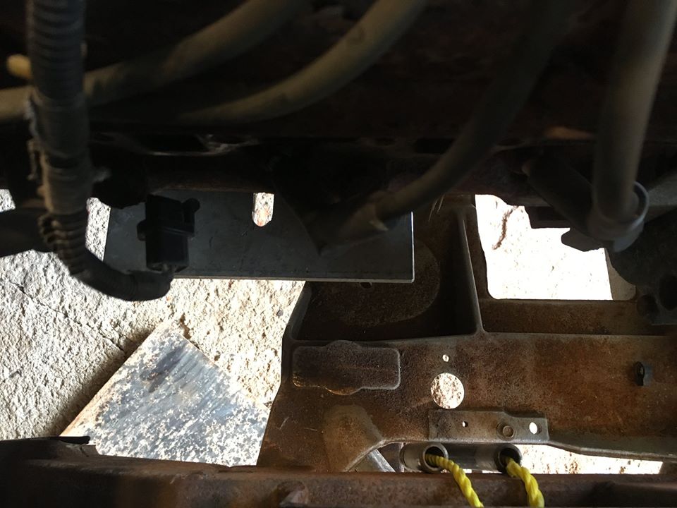

Motor mounts for a SBF are quite easy as they are a flat plate. I would have preferred to have some flexible motor mounts but with limited clearance under the cowl I have chosen solids for the engine.
https://lateral-g.net/forums/attachm...1&d=1631069574

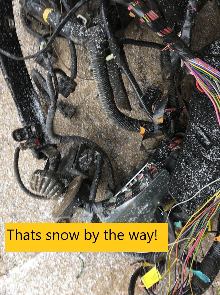

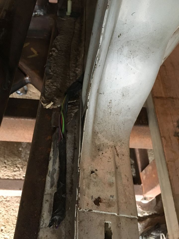

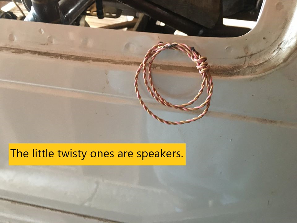

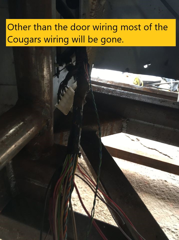

Needed the wires gone so I could continue with more work on the car. I didn’t lose any blood and I don’t have any deep lacerations so we can call that a good day then!
https://lateral-g.net/forums/attachm...1&d=1639285298

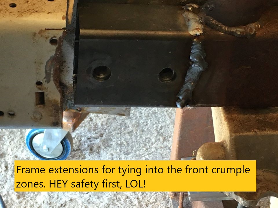

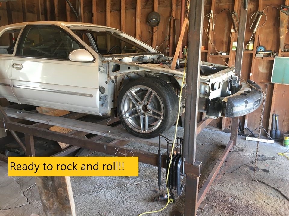

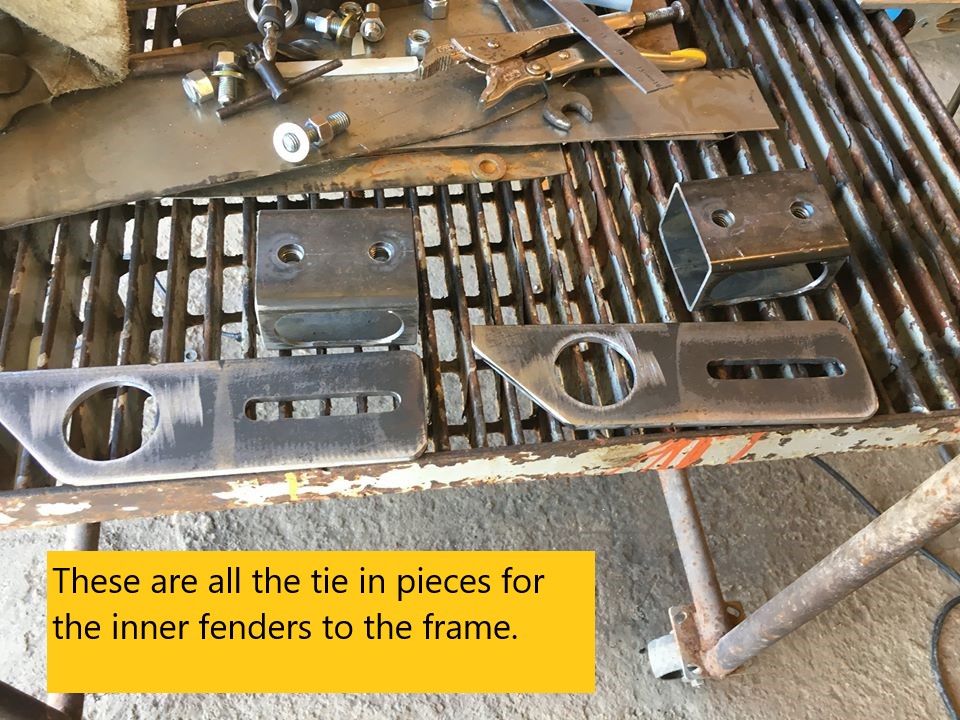

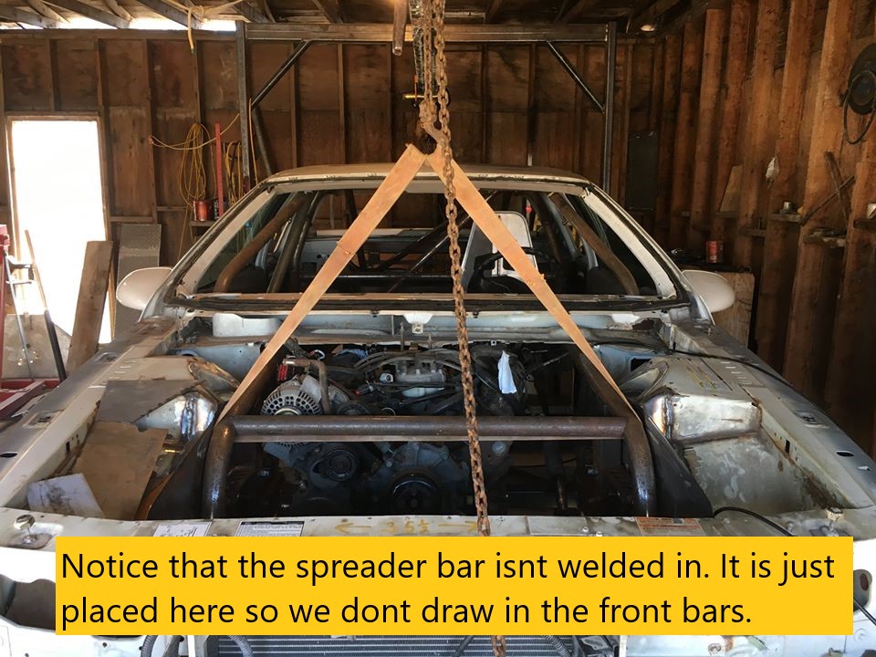

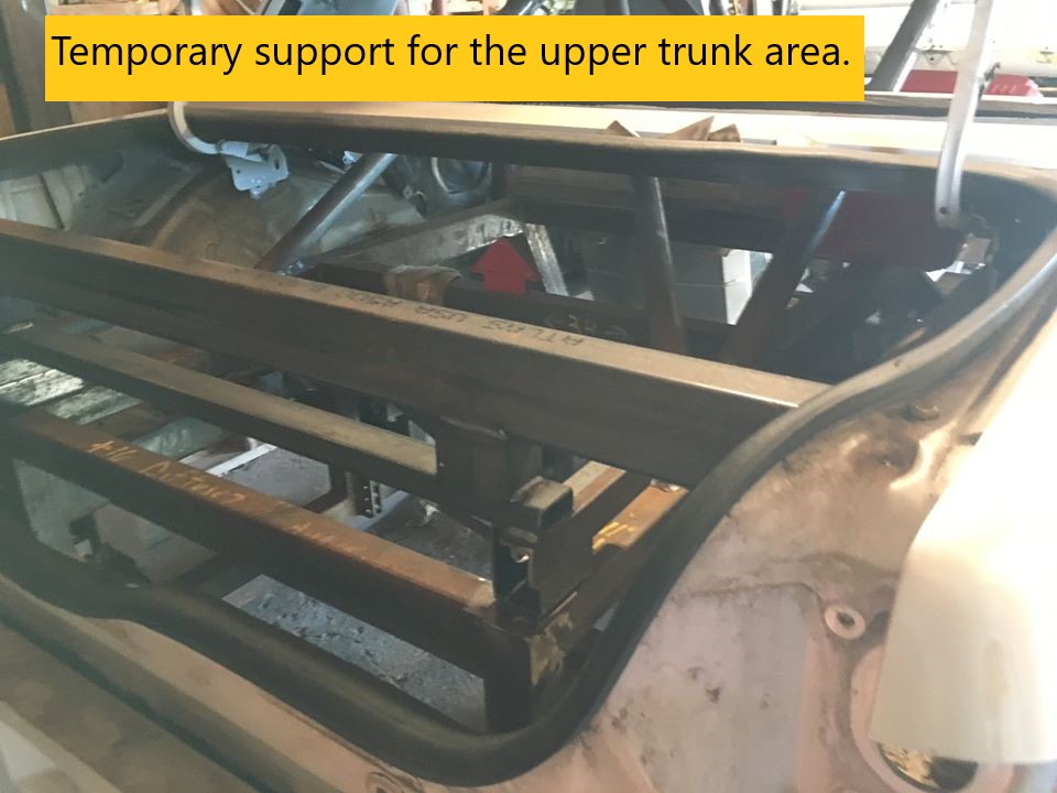

We are doing the last of the body positioning details so we can remove the body from the frame. This will make running all the lines and new wiring harnesses much easier. It isn’t just a matter of removing the body because we could do that at any time. The important part is to make sure it can go back in the same position.
https://lateral-g.net/forums/attachm...1&d=1639705492

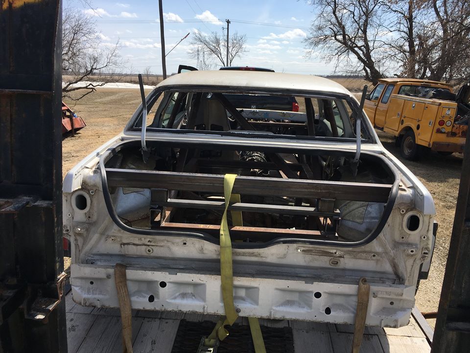

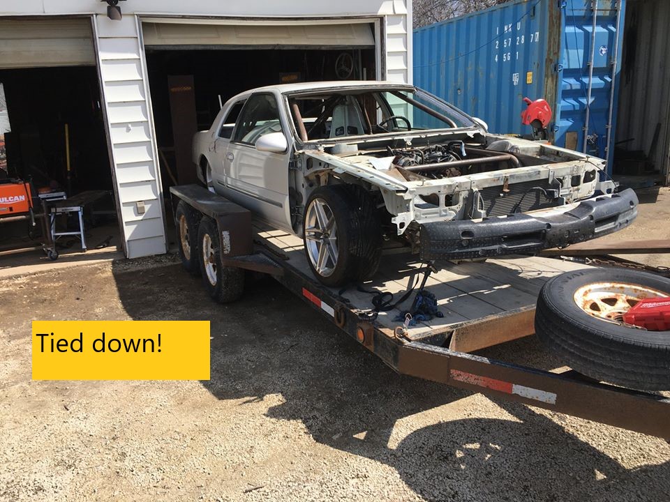

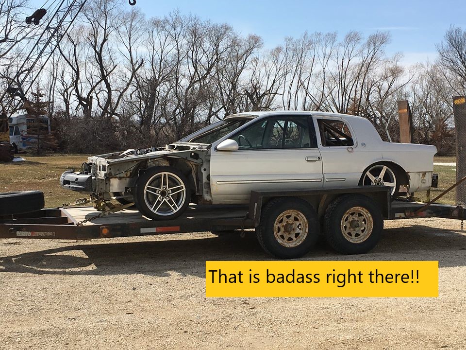

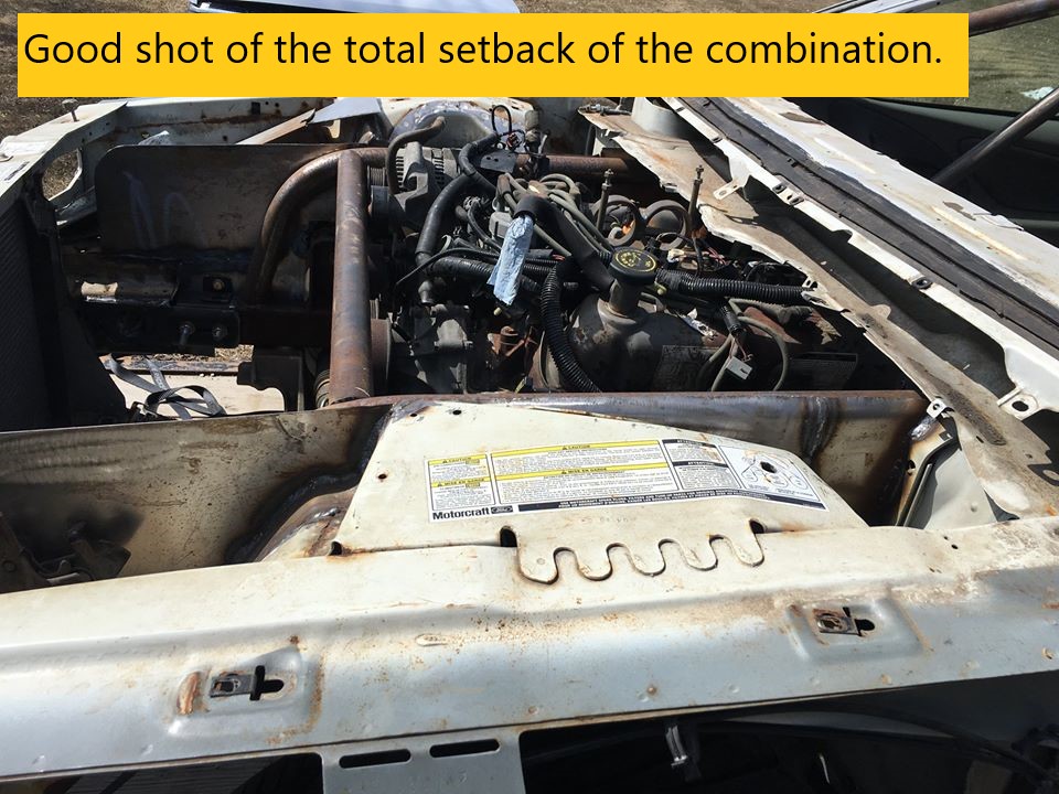

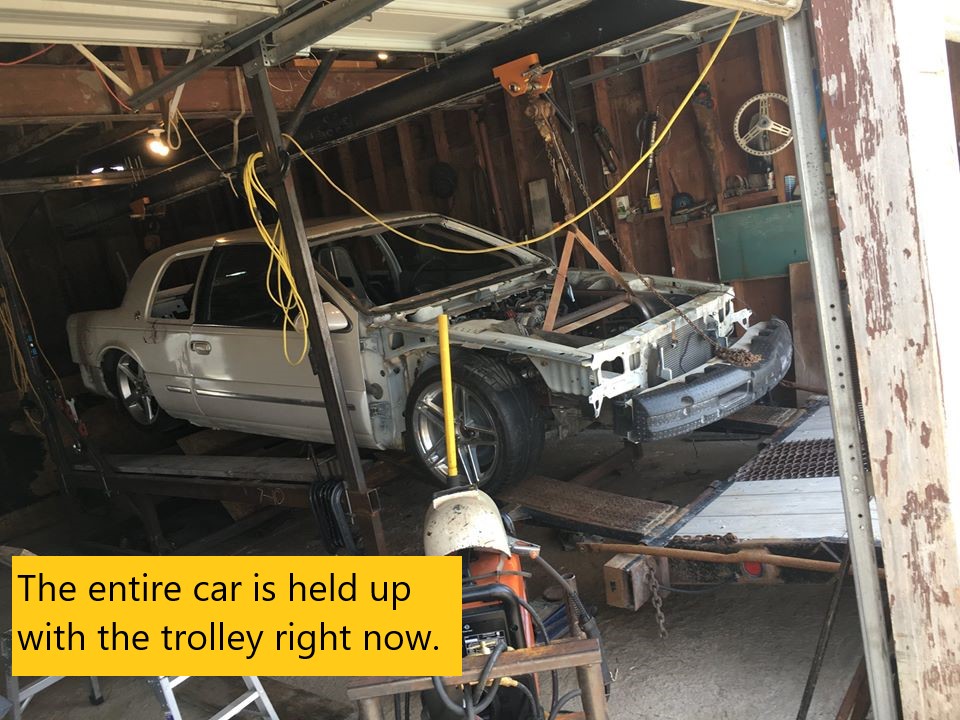

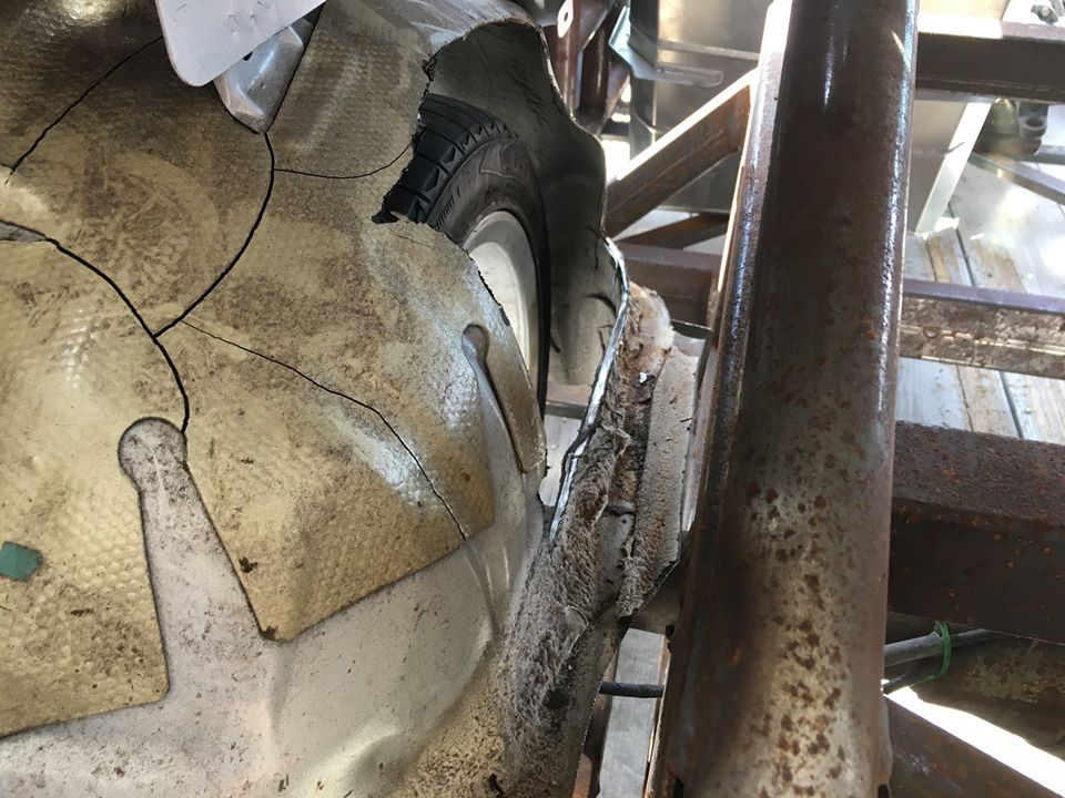

Decided that today was the day that the car would get out for a ride. That ride would just be on a trailer but a ride nonetheless. Backing the trailer in and running the ramps under the car but trying to catch the edge of the jig was an adventure.
https://lateral-g.net/forums/attachm...1&d=1639967029
