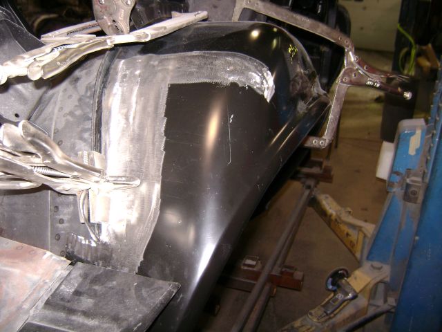

This has been my struggle for the last few weeks! I had to cut the back side of the well so the bottom of the quarter will sit right. Now mind you the left side fit with no modifications just shows how crappy this aftermarket junk is ! This is the third set so I had to give up and just make this set work. Now this may look okay but I have to tell you it shows how much pictures lie. If you put the well up to the light it looks like swiss cheese. I have to make sure both sides look good you can see the back side from the trunk and you can see from inside the well so I want to make sure both sides are finish nicely. Easy right, F-ME what a battle. But I have one more set that I'm fitting much tighter so will see what happens.

Let's see if you can weld that gap!
Ain't old cars fun?!
Mario,
I can be one anal F**k but I think you maybe beating yourself up to much. If the welding has strength and there are pinholes dont worry. Spray it with good epoxy primer and use high build primer and or skim coats of filler for esthetics, after all these are areas that will be hard to see. Remember you want to drive this and enjoy it. I'm just saying..........
