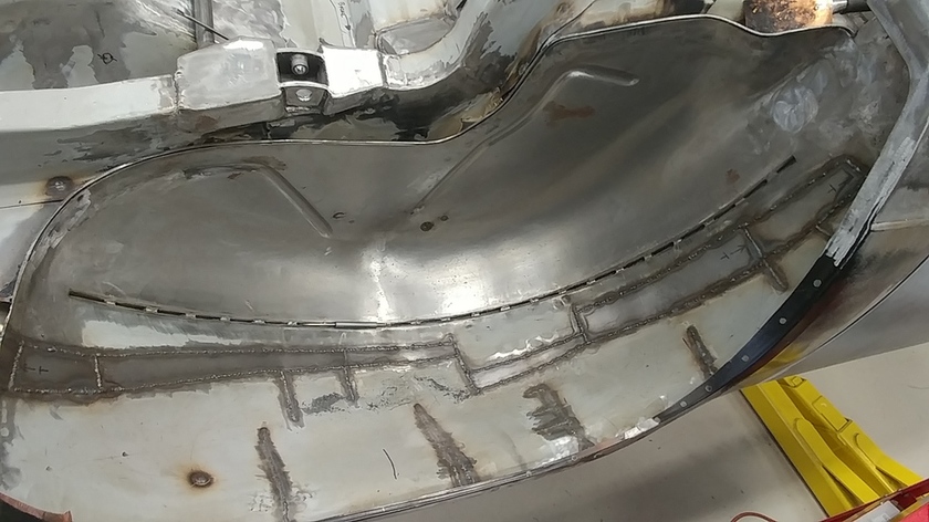

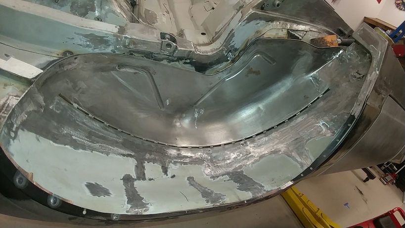

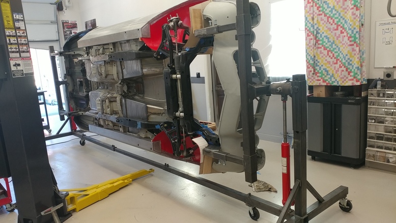

Back on the rotisserie so I can finish the welding on the underside and laminate the fiberglass inners.
Finished widening the rear inners.

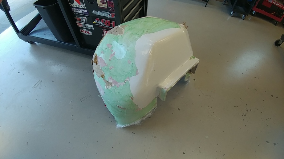

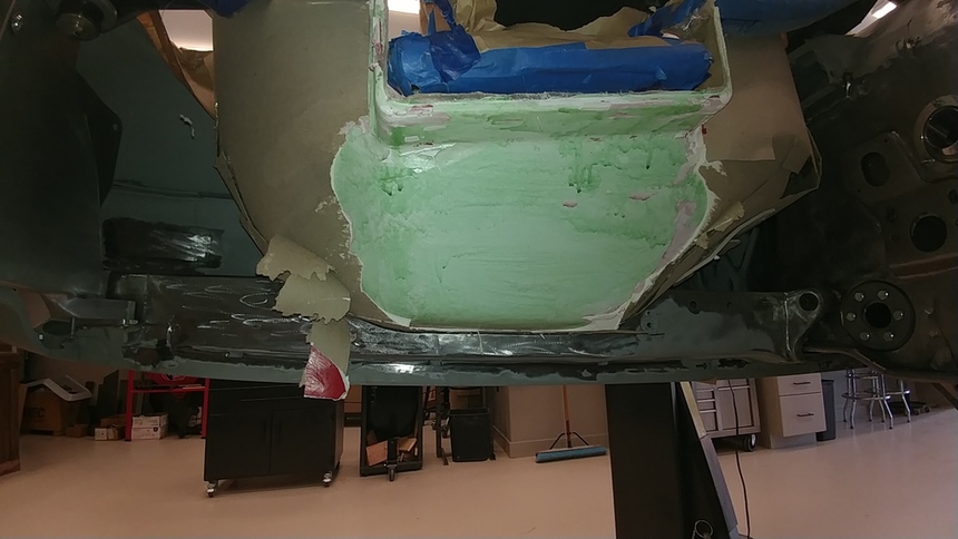

Starting to get cold here so I took a detour from welding so I could laminate the fiberglass front inners while it's still relatively warm.
You can sort of see the green PVA mold release on the mold. I left some of the edges of mold run a little long so I can decide later how to trim the inners, especially where they will tie into the front spoiler/splitter.

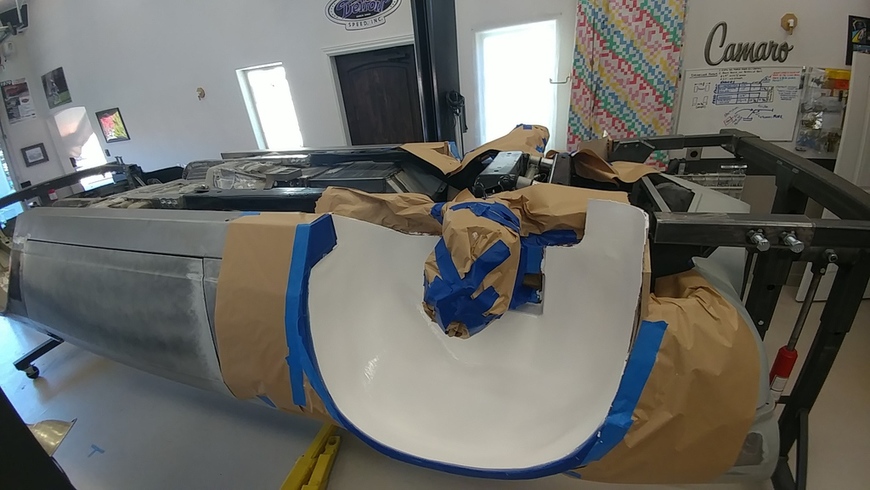

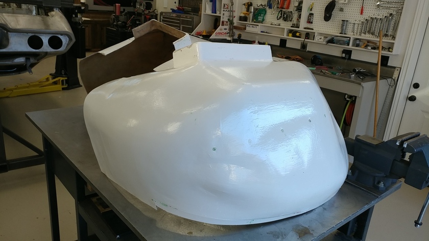

White Gel Coat on the mold. I will laminate in a day or so. For sure, this is stretching how you should properly build a mold/part but it will work and allowed me to build the mold and do live tests with the wheel/tire on the car and at full suspension compression. The inner is only 1/8" away from the fender flare.....pretty frick'n tight...needed to be to keep the tire clearance. Will use some Kevlar for strength especially in front of the oil tank.

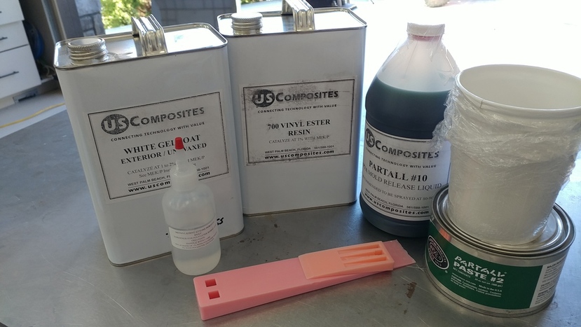

Resin: I like the 700 Vinyl Ester Resin.
¾ Ounce and 1 ½ Ounce Chopped Strand Mat. When ordering your fiberglass, make sure you choose the “rolled” instead of “folded” shipping method. Folding damages the glass strands.
Kevlar: I used 5oz Kevlar.
Mold Release: Get a small can of Partall Paste Wax and a ½ gallon of Partall PVA.
Get a handful of their resin mixing cups, a good supply of single use paint brushes – large, medium and small and get a few part-releasing-wedges for prying the part out of the mold, USE a BINKS respirator – you will be breathing this for the better part of an hour and be right up close to it in order to see the air bubbles. I don’t use gloves cause they are a pain but a respirator is a must. As you know, Acetone is a must for clean up. Eye protection is also a must.

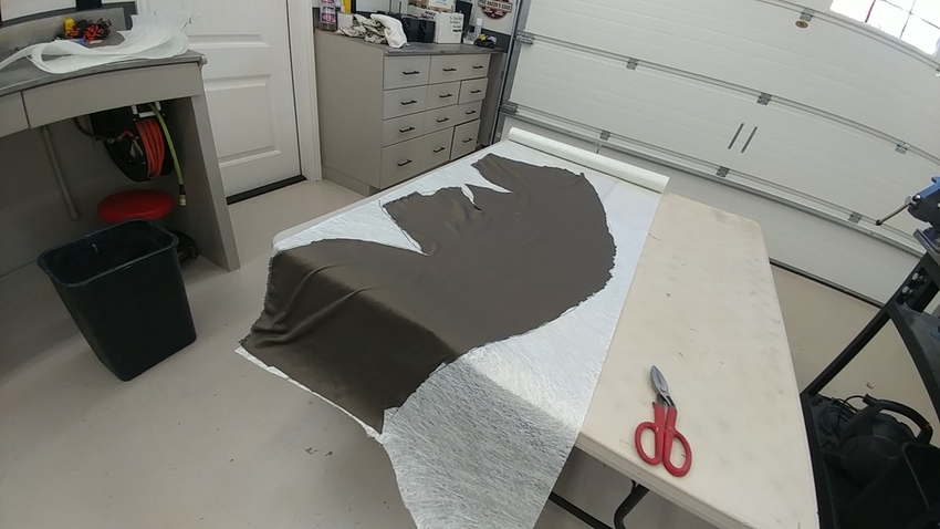

Step 1: Before you prep the mold, get a piece of cloth or an old sheet and cut it into the shape of the inner fender, let it overhang a few inches and cut it so that it lays flat in the mold. Then use that piece as a template to cut out the glass from the rolls. Put these cut individual layers of glass into the mold, one at a time and “tear” it so that it lays flat. Do this now, you won’t have time when you are laminating. And tearing glass that is wet with resin is not good. Tear it, don’t cut it with scissors, this keeps the part flatter and stronger. It’s OK if you do this in a “patchwork” instead of one full-size piece as long as you let the “torn” edges overlap. Just do all of this up front before mixing the resin and have the pieces set aside in an organized fashion so you know exactly what goes where and in what order. Time is not your friend after you mix the resin. It’s lame but I do a rehearsal before mixing the resin, always seem to find something that saves time.

Here is some of the supplies
Here is the cloth template

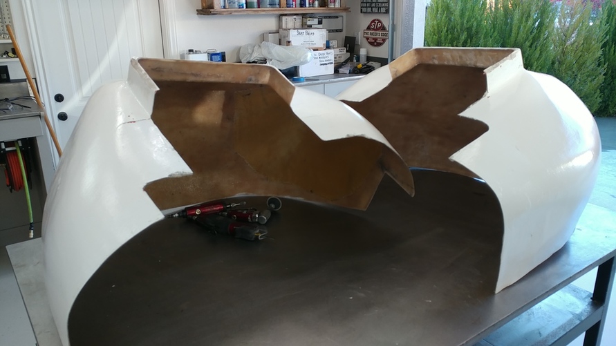

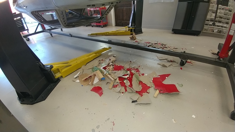

Here is the beginning of breaking out the mold.
Busted up mold.

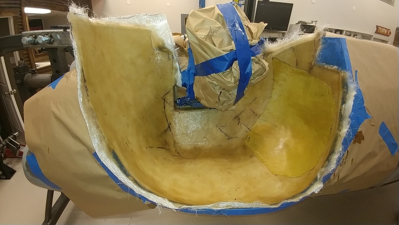

Here is the part right after removing from the mold. The green is the PVA, you can peel off most of it, then just wash the rest off with water and a little scrubbing.
Ready for finishing.
