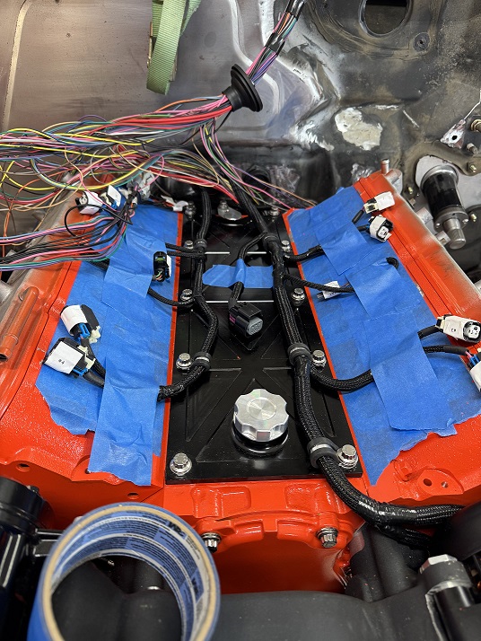

Originally Posted by ScotI View Post
Intake swap..... From what to what?
The PSI Intake, which I beleive is their proprietary intake, to the Holley Brand intake. It allowed me to use the Lokar covers, and turn the injectors to the inside of the fuel rails, where the other intake was a little different and didn't allow the connector of the injector on either side of the rail.
Thanks,
Bill
Thanks,
Bill
TY for the response.
I intend to so an LS swap but want to maintain the carb/old school visual. I didn't realize a certain intake might be an issue over others if wanting to use the faux BBC covers so the clarification helps.

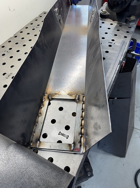

So it has been a while since I posted, but there has been a lot of work going on in the garage. As I have been working on wiring, getting it routed under the intake and such. Then moved to the trans tunnel. I had made a template, and a friend was going have his metal shop that does work for him to bend it up for me. Waited for over two months, and nothing. So, I went and picked up some metal, and decided that since another friend has a metal break, then we would give it a try. I will say, it worked.

Before I welded it in, I put the seat belt bolt backers in place, and also cut the hole for the shifter. I also welded in thicker material under the shifter opening, so that I can put on a rubber boot.

Moving on, preparing for the engine harness to go through the firewall, I decided to use bulkhead connectors. If I ever need to remove the engine, just twist the plug and remove.
I then got the engine reinstalled into the car, to do more test fitting. Now, it is time to cut the harness and work on getting it all in place under the dash.
Bill
My Build Thread;
https://lateral-g.net/forums/showthread.php4?t=40557
