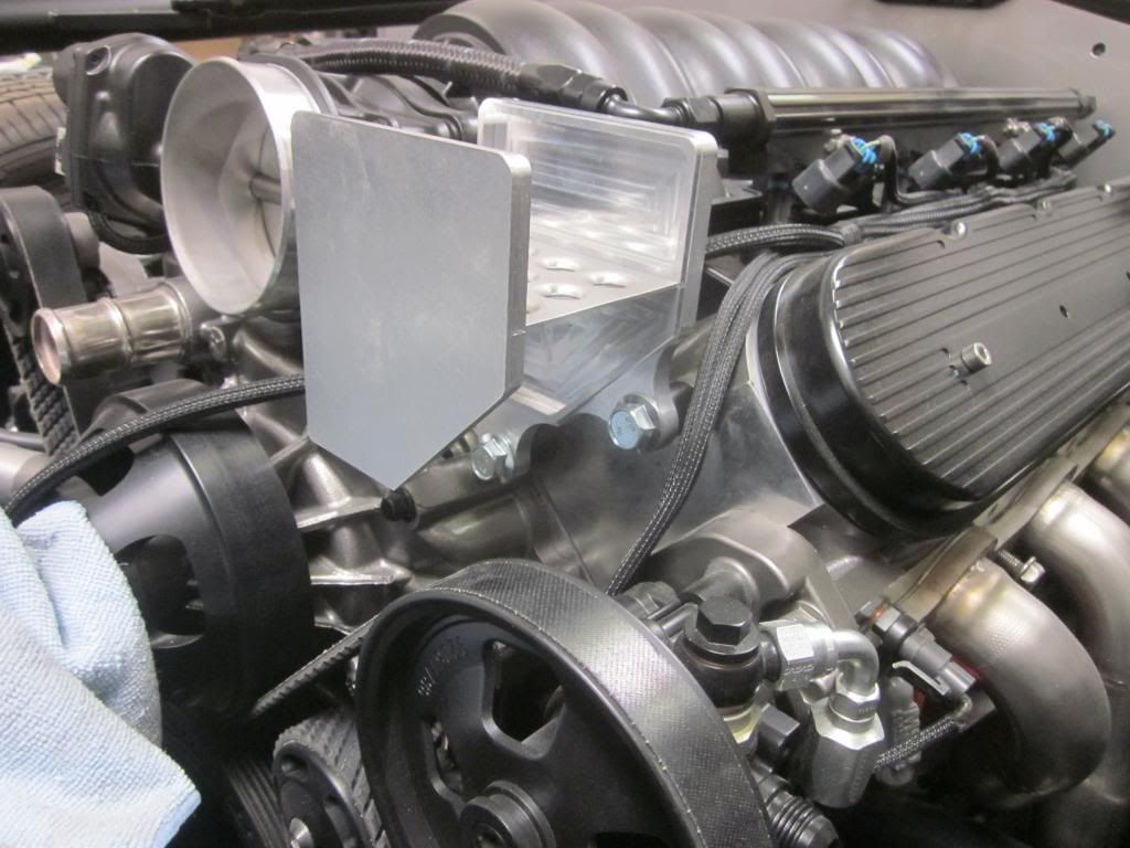

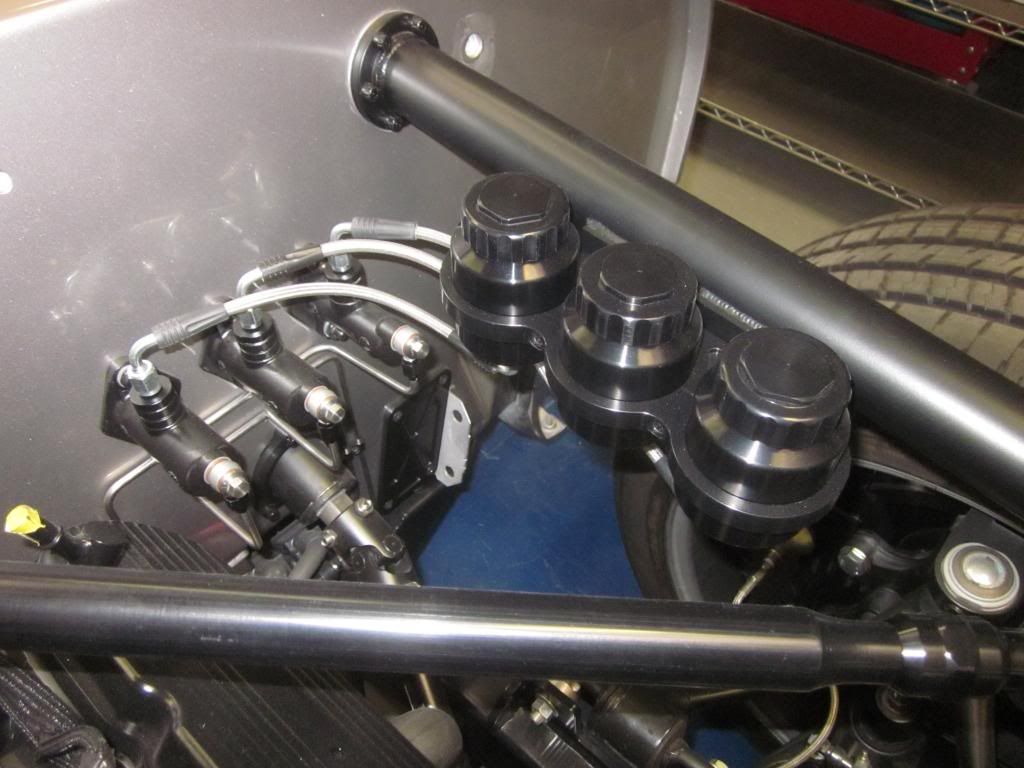

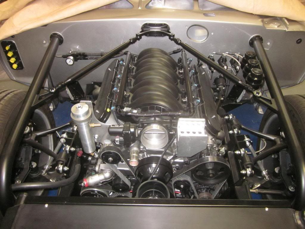

It has been awhile since we had any updates on the Firebird.. Sorry! Here is the latest on this build.. Getting the engine bay assembled & detailed.. Still designing a few more pcs…
Got a new power steering reservoir we will be making tomorrow.. just got pcs from the machine shop.. The pass side reservoir is a new air oil separator that we will be testing on a car next week.. just used the bird for mock up..
Got the new brake reservoirs that Wilwood is now making…
The factory oil dip sticks needed some cosmetic enhancement… Use the factory tube.. cut it & silver solder a new end with shortened tube…. Cut the dip stick indicator & use our new t-handle…
We got the rear section of the car assembled! Got a few more adjustments to do…
