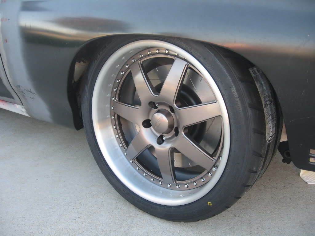

here are the pics of the new wheels. 3 piece rushforth wildsides. 20x11 315/35/20 rear, 19x9.5 275/35/19 fronts. rear has a lot of room to come down, but it would be a reverse rake. i have about 4.25" to the front crossmember. i may come down another 1/2", but thats the limiting factor on how much more i could drop for an actual ride height. i wish i could do more, but its really not possible.

great looking wheels. I need to go back to see if you put tubs in there. the rears look huge.
I also spy the grille on top o the roof. Did you post finished pictures? Still wanting one.
tubbed the rear. no way to get these in there at this ride height without. even with the tubs i had to push the wheels in more than i wanted. plenty of clearance at ride height, but it tightens up real quick when under compression.

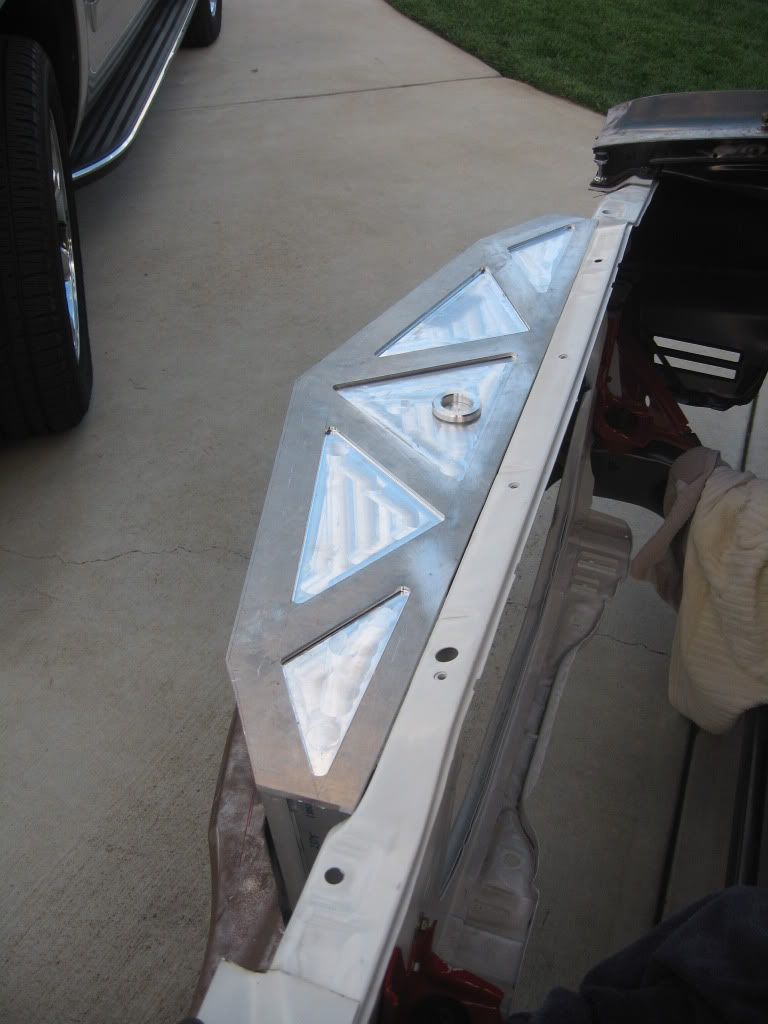

i was back to feeling like crap last week but doing better today again. so heres the newest addition. its still a little rough but this is what i got done a little over a week ago. it will end up tying both fenders together and going up over the core support. i need to get the radiator mounted to see if that will be covered or left exposed.
one issue needing a solution is the hood latch. the pin should end up going through the piece thats floating in the middle. not 100% sure how i will finish that piece, but its roughed.
i also need to know if im going to use the hook or not since it complicates the plan. i planned on mounting a solenoid that would pop the pin since i took the stock release out of the bumper. the concern would be the solenoid popping the pin while driving and not having the hook to keep the hood in place. anybody else feel comfortable drving with only the pin? ive never had a hood pop to the hook before, but it would be a huge deal if it did without a hook.
