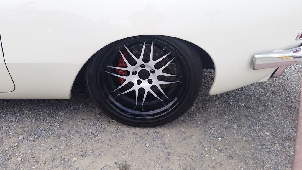

Well after a couple of months of waiting, these sexy bitches showed up at my work yesterday. A couple little issues with packaging from the builder ended up with three wheels not being perfect. Ill work with Jason on that front, not sure what to do.
He did the hidden valve stems on the wheels and although they are super cool just would not work so I picked up some flush mount valve stems to plug the holes and got to work drilling holes in the front lips on my brand new wheels... :cry: Yes you heard that right.
But lots of measuring and prep and they are drilled with some nice clean valve stems in there.
I went out on a limb with the color on these a little bit. I love brown, its such an elegant under utilized color on cars and with the tan/Beige color on the truck with the brown interior I thought it would work well. Jason nailed the color and finish on the wheels they are incredible.
This was just a cool shot....gives you an idea of just how big these are....yes, they are all 18x11's

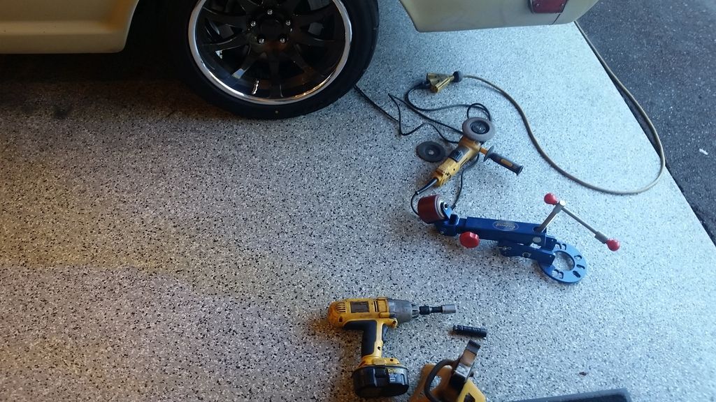

Typical wheel and tire install tools at my house.
Also add to that BFH, SFH, dolly and a couple of pieces of pipe just for good measure.
Just one side done, still needs to finish rolling and pulling the fenders at this point but wanted to see it in the sun.
So with that, I got the other side done. Cut the lips on the rear openings and rolled them in as far as I could. I might need to pull the bedsides out just a touch to clear the tire at full bump, but it has a bit of room in there now.
I pulled the front fenders as far as I could at that point. It is very subtle and looks very clean and nice.

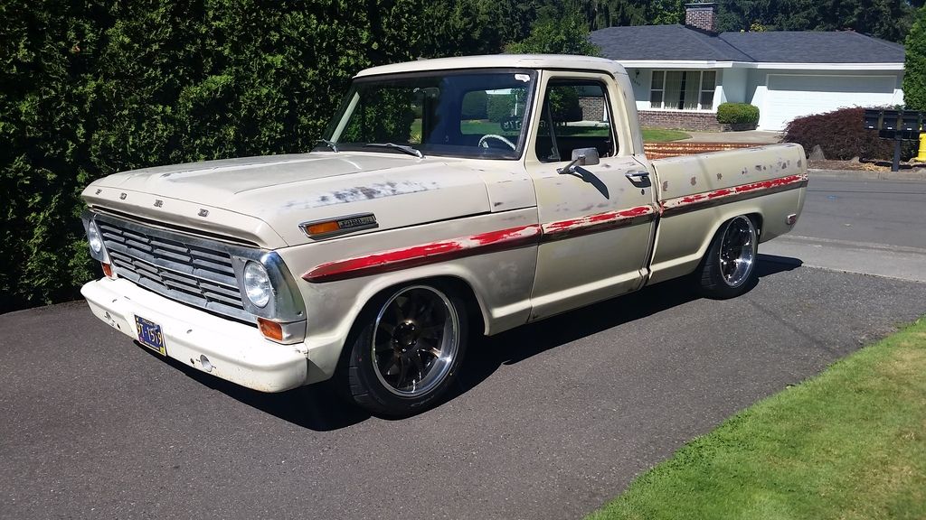

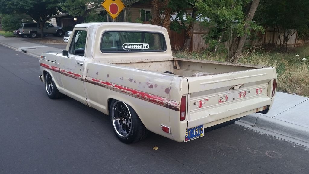

Here is what she looks like, first trip around the neighborhood.
Good shot of the wheel here
All in all its been a ton of work to get them on there but I am super happy and the truck looks mean, just like I wanted it to.

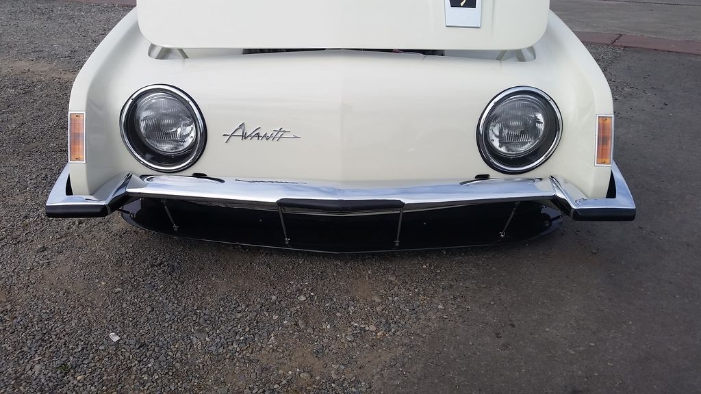

This is an Avanti....yes you read that right.
Just some other neat cars, I shot and thought I would share.

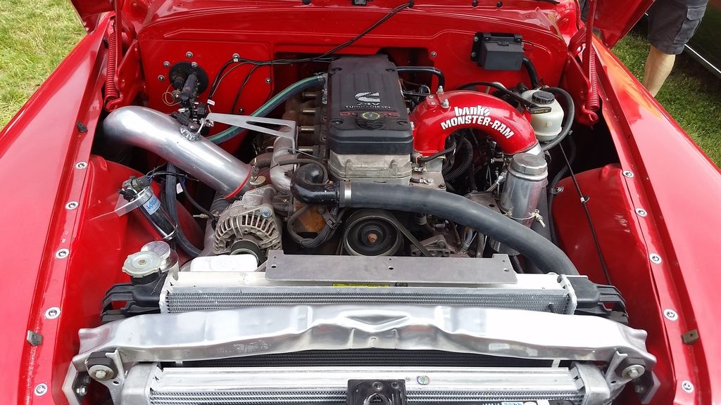

Yes, that is a common rail cummins..
