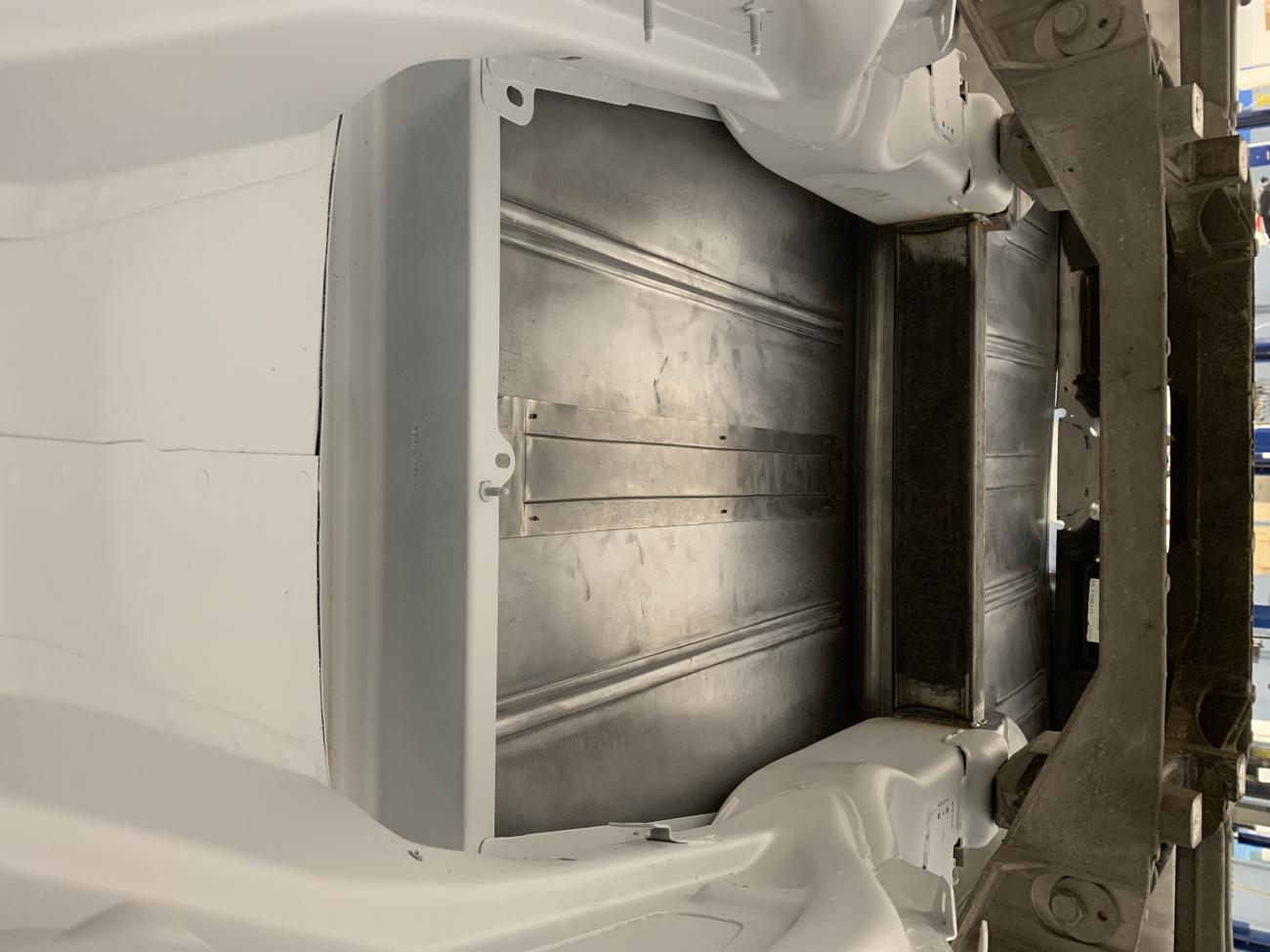

Lots done Saturday. I have two small panels to build and then fitting the rear metal by the tail panel and all the rear tin work will be ready for some epoxy and then welding in.
I went with a bead layout that looked like stock first gen trunk pan after a lot of though and trying to figure out what designs I wanted to put in the metal. At the end though simple is best. I also made a support that goes on the bottom to add some strength to the metal. I also had to built end caps on the floor pan and cut the back parts of the tubs out so I can take the rear upper control arm bolt out. I think it finished off nicely. I'm undecided as to if I'm going to lizard skin everything then factory splatter paint it or just shoot it all with raptor liner and be done with it.
