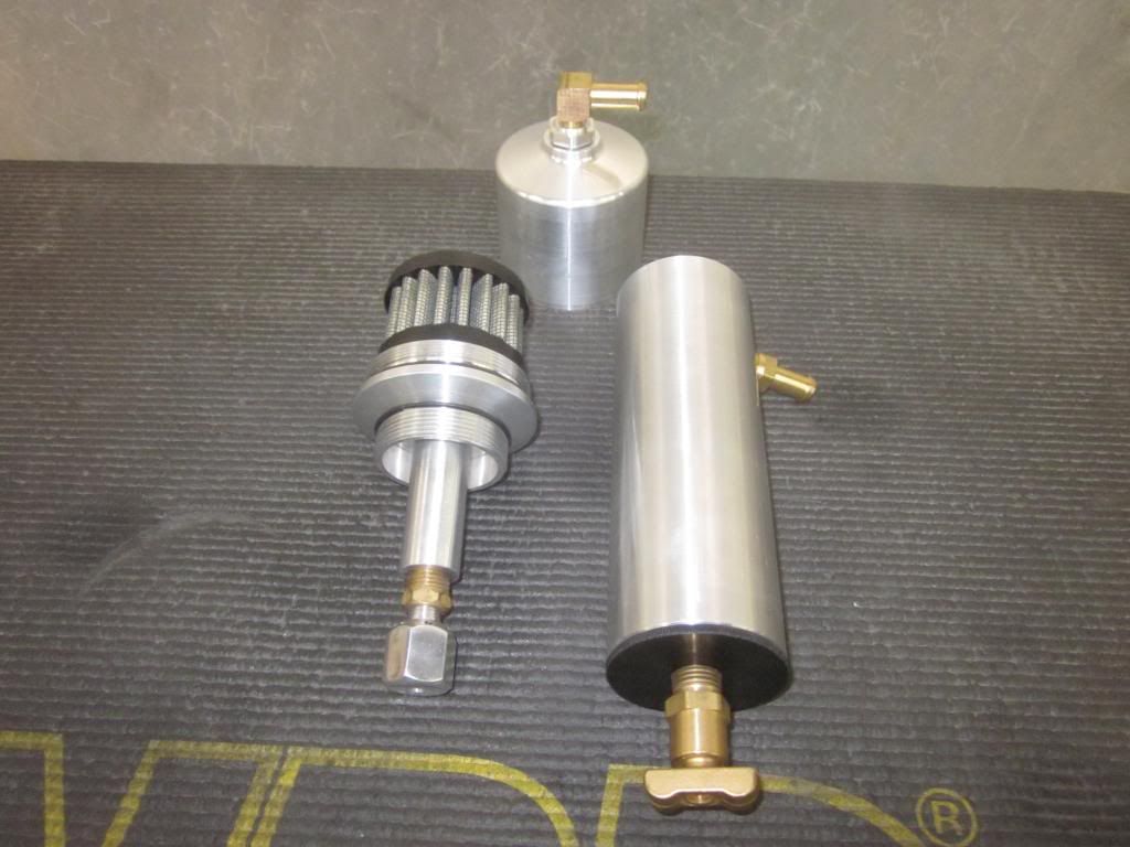

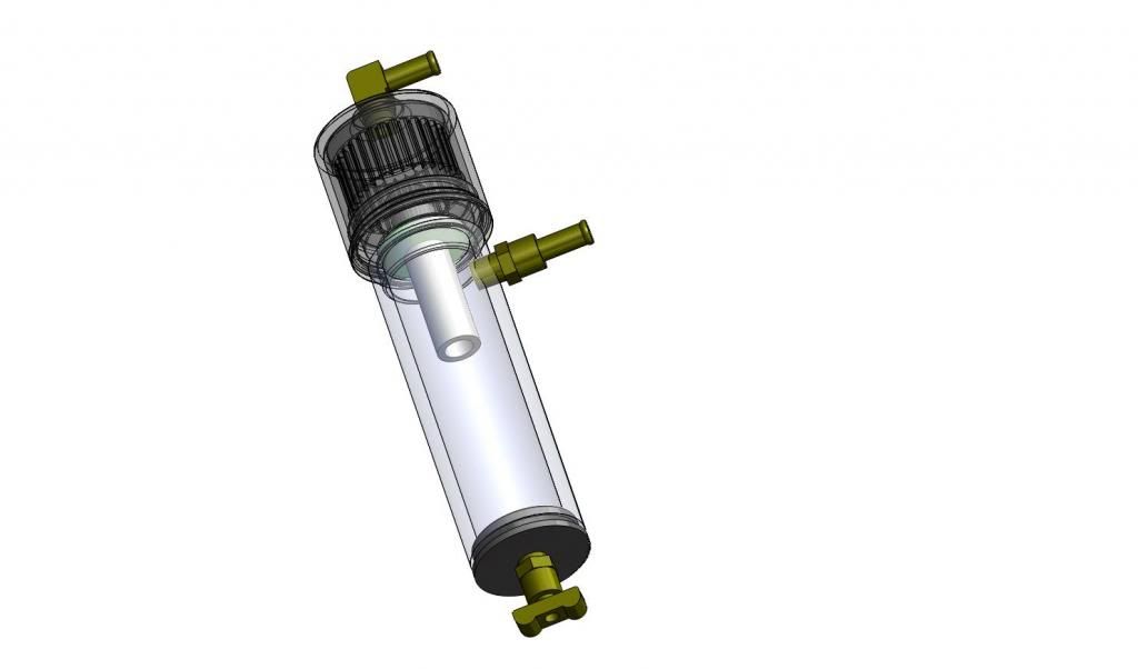

Today I am building one to install on a car to test function... If it works & can manufacture with less cost than what I have into it now... Yes!
Here is pic of all the components..

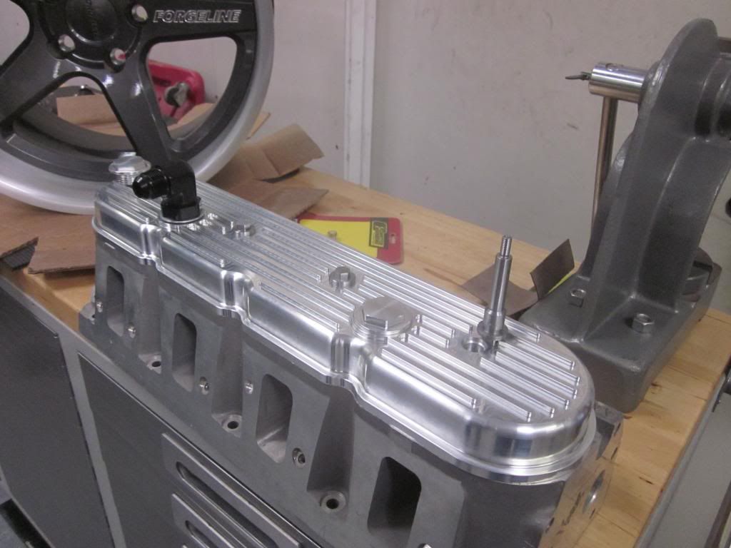

Firebird is almost done! Just in time for SEMA & will be in the Wilwood Engineering booth..
Machine shop brought in the LS valve covers to proof fitment on the 68 Firebird.. All fits good & now off to anodize & fabricate the baffle system inside the cover to keep the oil in engine when breathing from the ports.. All ports are O-ringed & we even made custom stainless mounting bolts..

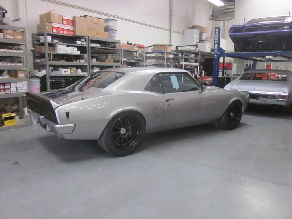

Look forward to meeting ya Lenie! For the last 4 months the car has gotten assembled by the owner & we just support on the assembly where he needs our help.. The interior has so many cool little items that have been designed & machined..
Exterior view..
