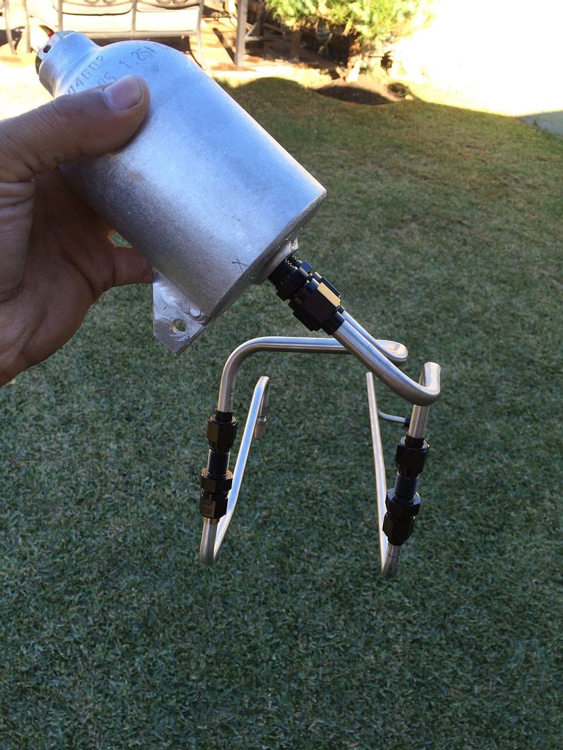

so my NOT MUCH https://lateral-g.net/forums/showthread.php4?t=51749 breather is finished and installed.
phase 1 is complete all liquids are in ,wiring , weather stripping etc complete car all done . I wanted to build it completely down to every molding , weather stripping etc to make sure it all fits as it suppose to . so i have a few adjustments on the list already.
cranked it up ( let it idle for a while ) a few days ago sounds great ,clutch engagement is dead on , no leaks after heat up cycle . all lights work properly. everything looked good until 2 days later when it would just turn on for a second or so and died . so after getting on the phone with PSI found out its not getting +12v at MAF . fuse that feeds it good so its loosing signal somewhere in between. well figure it out hopefully without major surgery .
My plan is to drive it the Long Beach High Performance Swapmeet on 01/31/16
don't mind those ugly welds they will get redone[URL=http://s1232.photobucket.com/user/frankv11/media/Mobile%20Uploads/IMG_6549_zpsre0qknsg.jpg.html][/URL

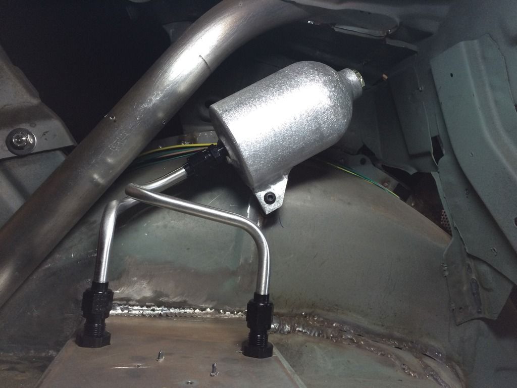

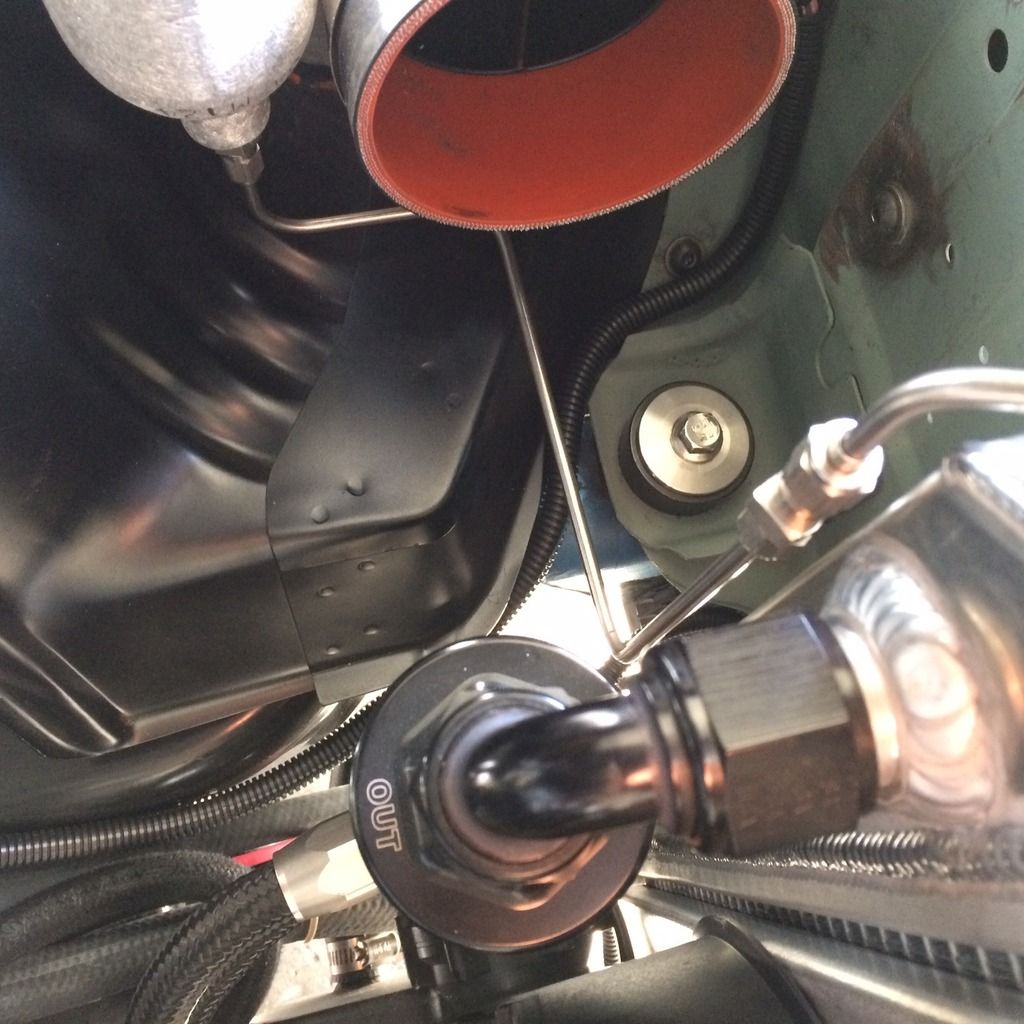

another CO2 tank sacrificed for overfill tank made this line because a standard fitting would not clear intake

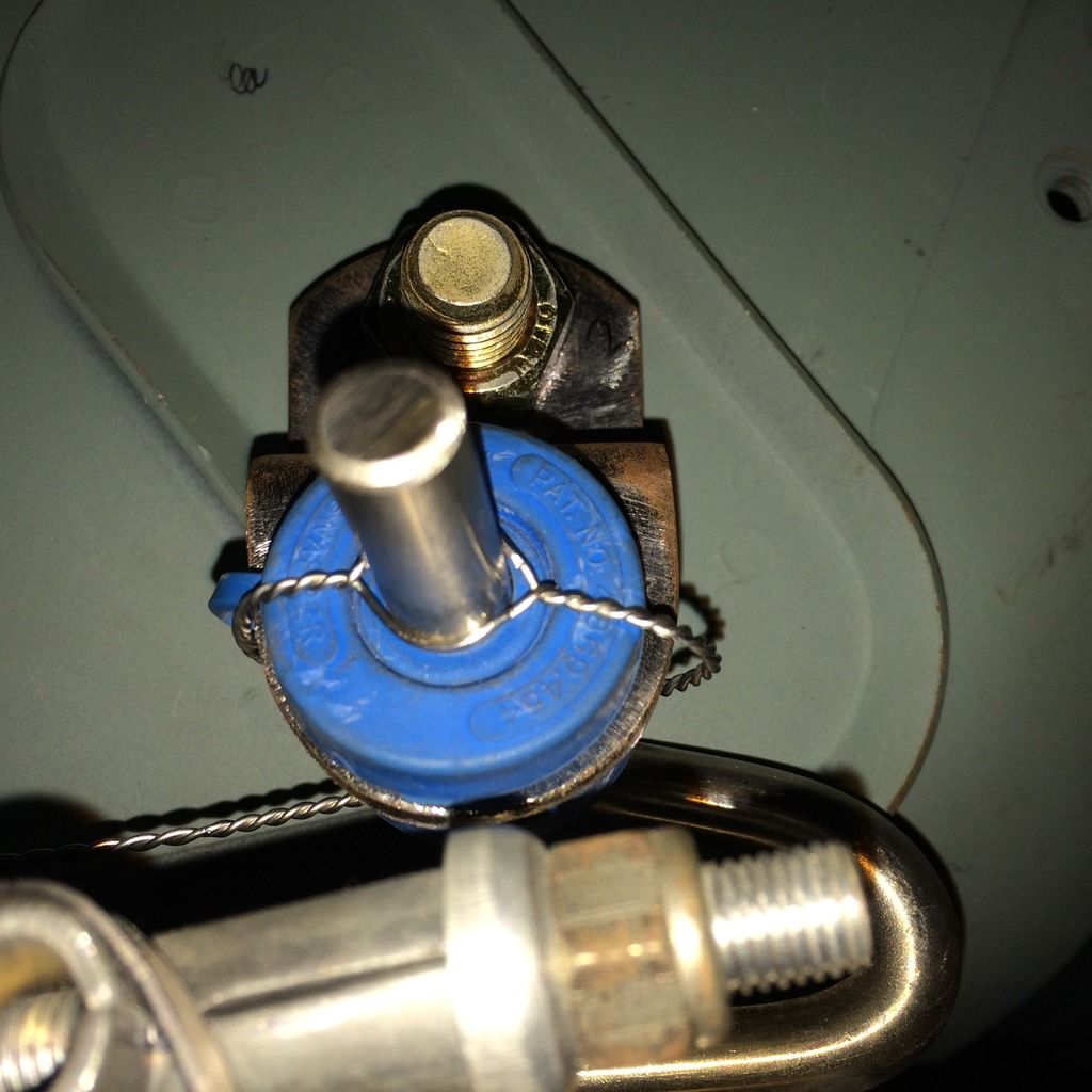

safety wired those exhaust grommets to keep them from collapsing while let exhaust expand/ move

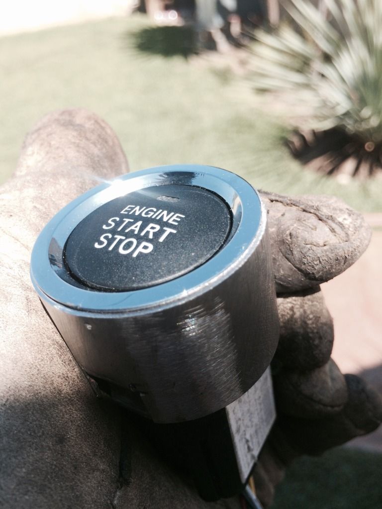

Frank I am glad to see you are still making progress,we need more progress pics.Which push button start kit did you go with?

[QUOTE=tubbed69;628257] frank I am glad to see you are still making progress,we need more progress pics.Which push button start kit did you go with?[/QUO
2 kids later and still going at it , had to add space to pull wagon .

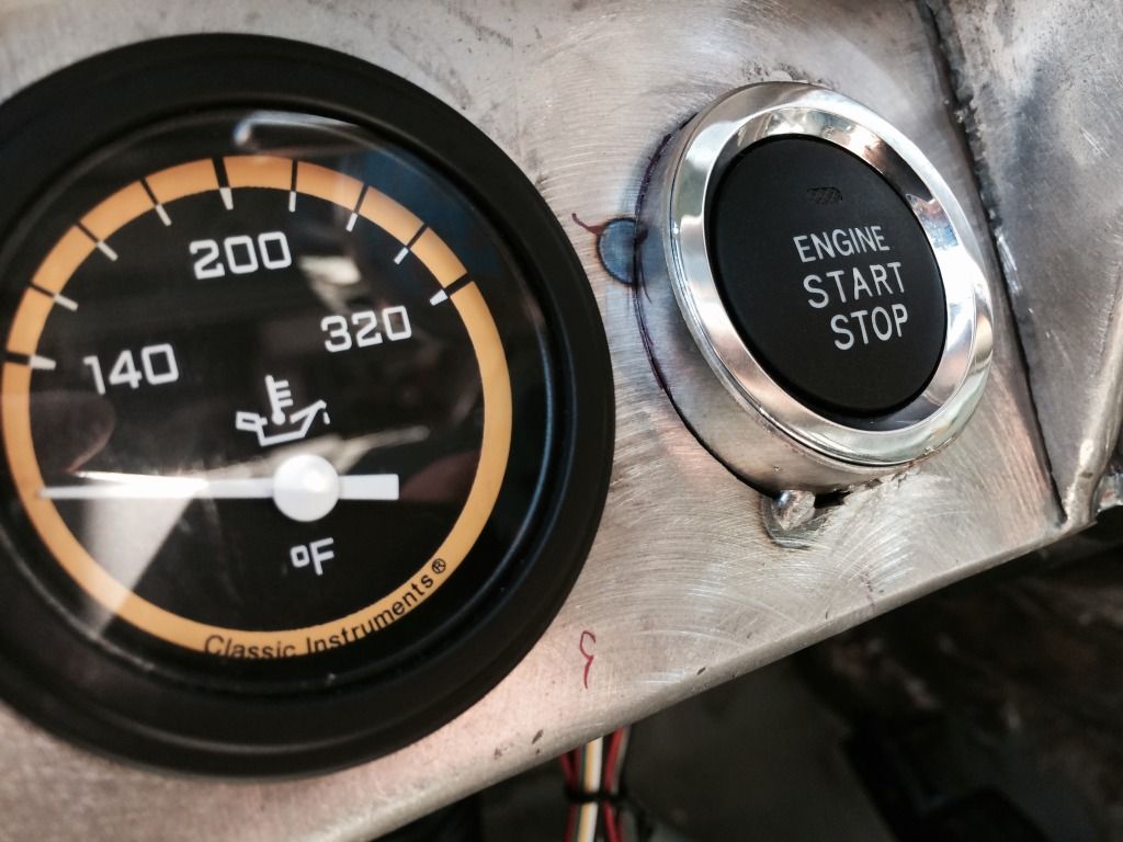

i went with guard dog everything is hooked up but its isolated( not in service ) ran a regular ignition switch in parallel for start up purposes , just to eliminate any other variables . once I'm happy with how everything is running , ill post up a review on it.
