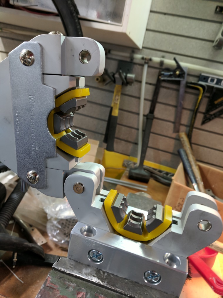

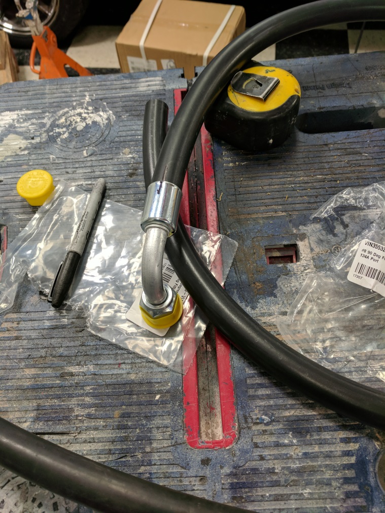

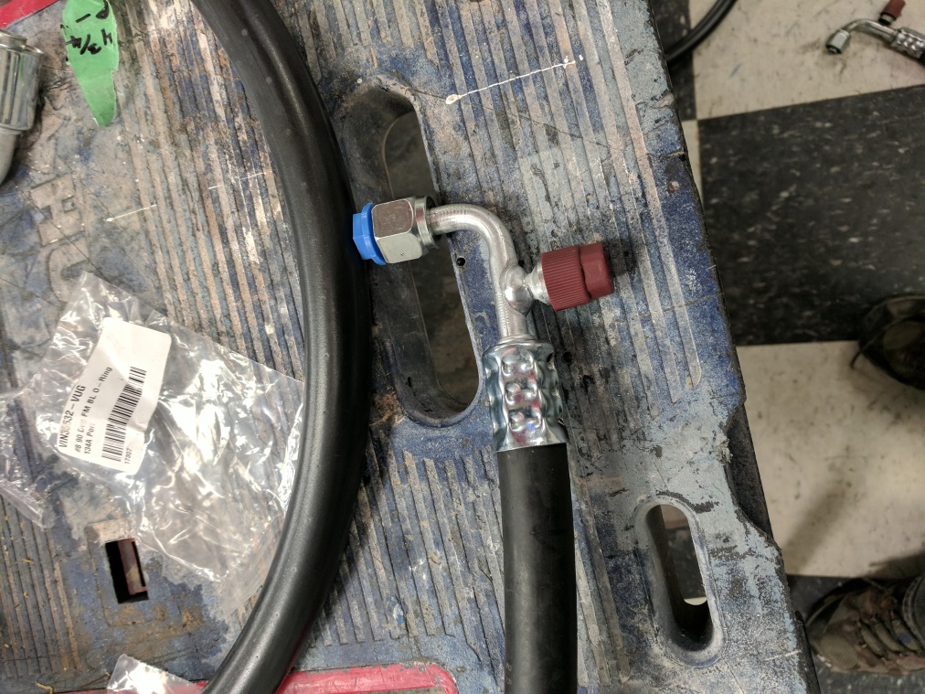

I know it's not high performance related, but I have a/c on my car that was not working for quite a while. since I swapped the engine. I wanted to also relocate the a/c lines a bit.
I picked up my kit today, and got to work. Things went well and I just have to test and fill the system now.
