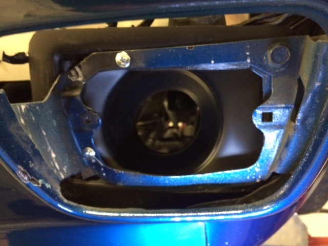

I finally got the wiring back in for the fans and relays
Mounted the Vac res tank and then did one of the
Brake ducts
Bob

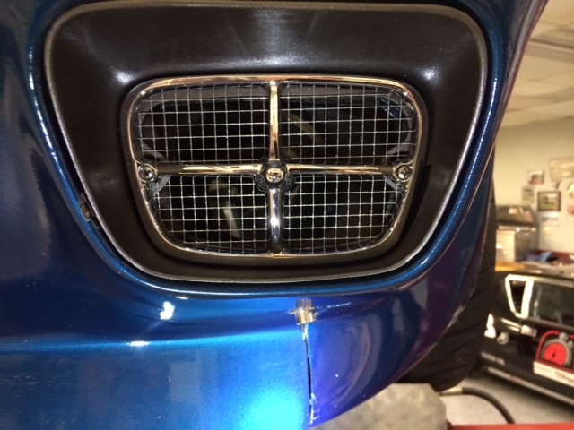

Default Dreamin Tas
Finished Brake duct
Bob

Default headlights
Were the headlights made for any F-body or were they a universal number?
  #286
Old 02-16-2016, 02:18 PM
Panteracer's Avatar
Panteracer Panteracer is offline
Join Date: Oct 2013
Location: SF bay area
Posts: 1,194
Thanked 335 Times in 131 Posts
Default Dreamin Tas
Headlights are Summit racing.. 7" diameter I believe.. like $70
for the pair.. its a racecar not a show car... but trying to make
it look somewhat showy and I needed a place to put the turn signals
Bob

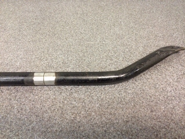

My buddy gave me a brace so cut it down
and then had my buddy weld it up

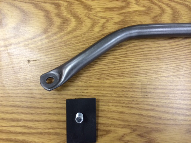

Default Dreamin Ta's
Painted it up and Fabbed a couple of plates to sit inside
the frame rails

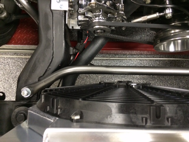

Brace bolted in place

Nice! I have one that goes under the car. Looks almost like another sway bar until you realize it's welded in.
