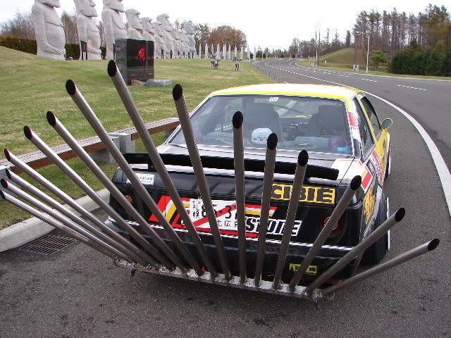

Originally Posted by Payton King View Post
Tim,
A picture speaks a thousand words. You know Ron only looks at pop up books. LOL
Payton, I don't have any pics of my old engine's venting and it's since been dismantled. Deb's car is not near me right now to snap pics so Ron will have to just use his imagination

Well.... that could be a new issue.

Gw I think that's plenty of venting for the engine!
so many WTF's in that picture.
I believe its well spelled out Tim. i found a diagram for you Ron. : )

Originally Posted by Ron in SoCal View Post
Thanks for the laughs and suggestions fellas. I just got back from a work trip this evening and will get in the garage tomorrow and look at my set up and describe it to you. I think I have a 'path of least resistance' fix in line with Tim's post (sort of) and will post up pics and my thoughts in the morning. Happy to have your feedback ...
woops, I posted that diagram is upside down. Make sure you turn it 180 or else it won't make any sense.
