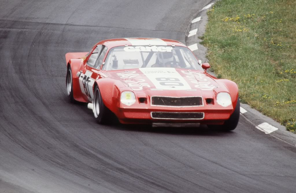

Not a bad photo there, Mr Forvette.
I've seen better
