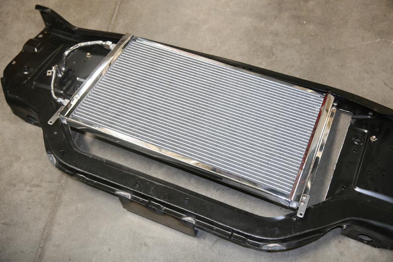

Radiator & Radiator Support
Here is the new Air Mobile large core billet alluminum radiator for a big Block Chevy Camaro and I will have these in stock and ready to ship if someone out there needs one.
I can send you the radiator and support ready to be installed or you can modify your stock one to fit the radiator and install yourself.

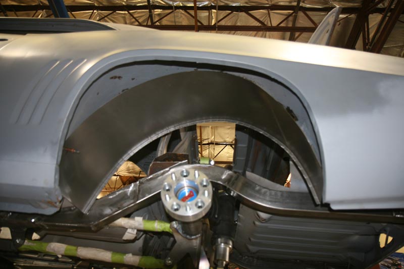

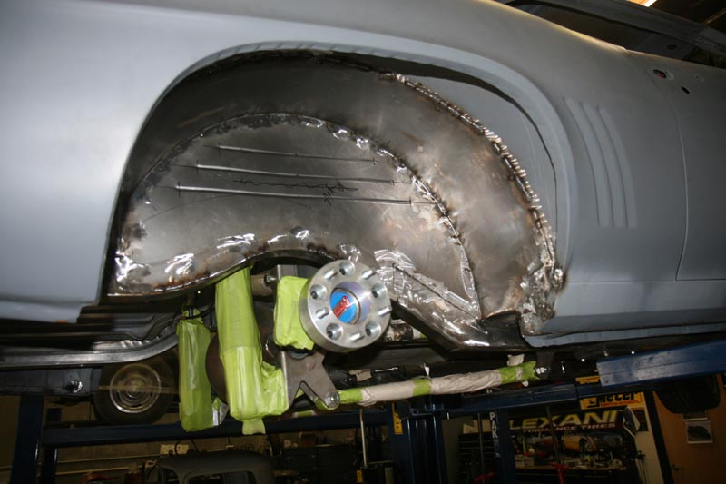

Default Fesler Built new 1969 BB Camaro project update 10

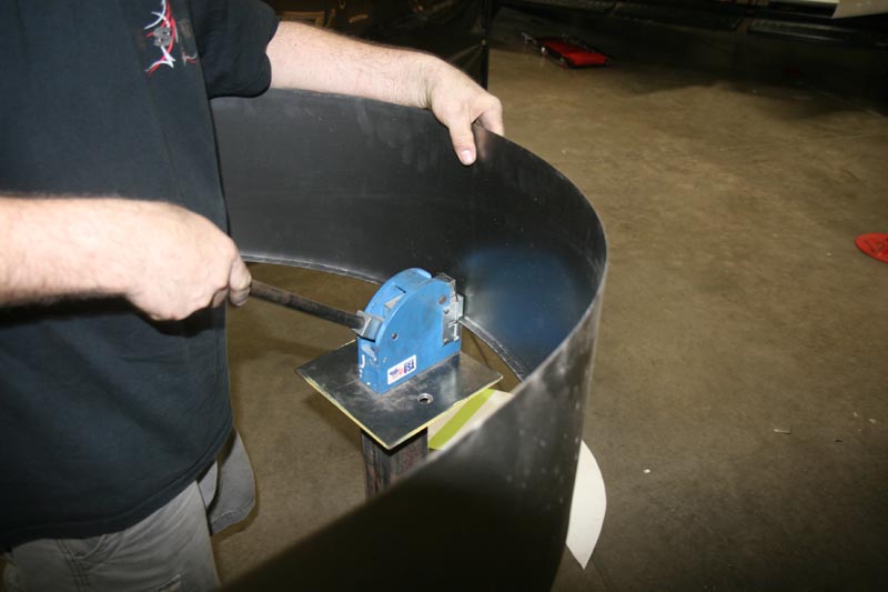

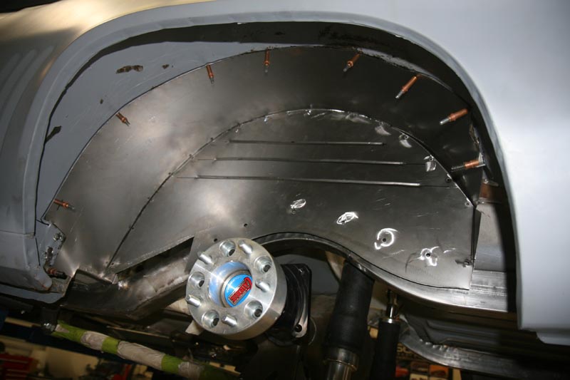

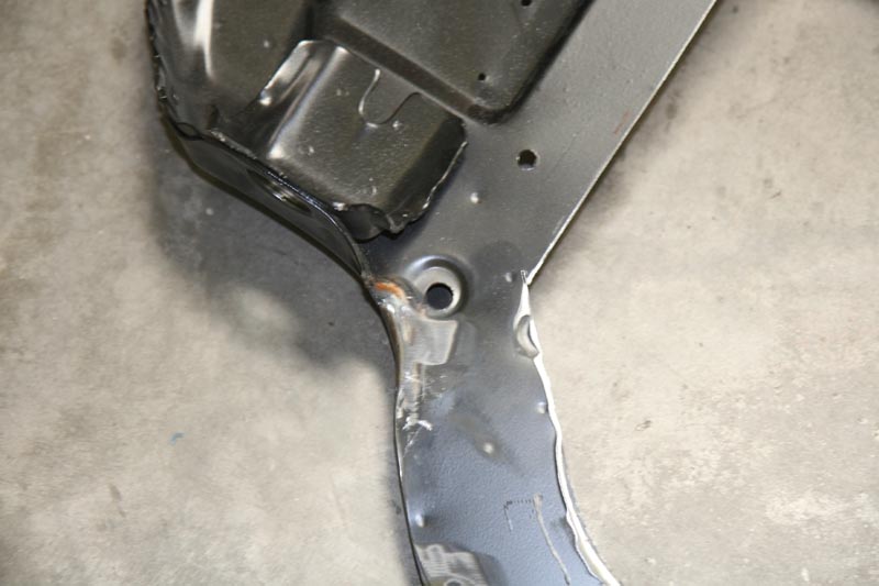

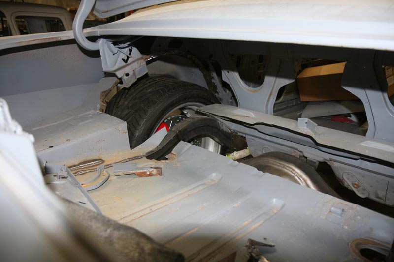

Tubs anyone

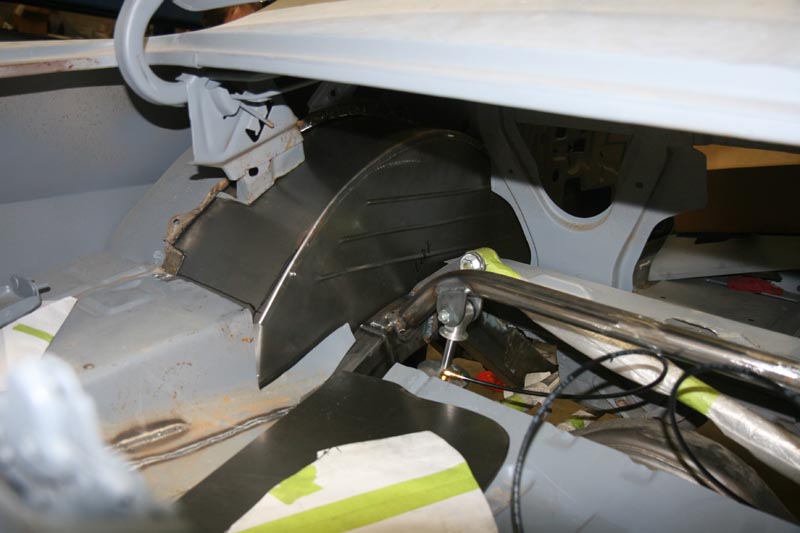

Here are the tubs we built for the new 19X12.5 wheels in the rear, we figure its better to build them to the car then it is to buy them, you get a much better fit and look when completed.
here we start by taking a flat sheet of 18gauge steem and rolling it to fit the inner fender, this will get cut perfect and welded with a clean edge so you cant tell where they start and end.
The cardboard template really cuts down on the cut and re cut time
this is half done now and will post more to show you the rest of what we did to get these this big.
Chris Fesler
Fesler Built - Scottsdale, AZ

Default Fesler Built new 1969 BB Camaro project update 10.1
Tubs
finishing the install and building a cover for the rear suspension
Chris Fesler

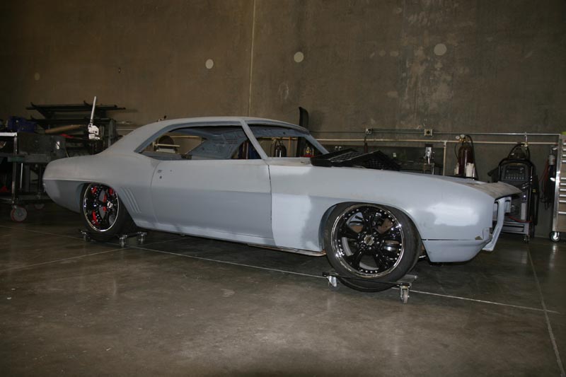

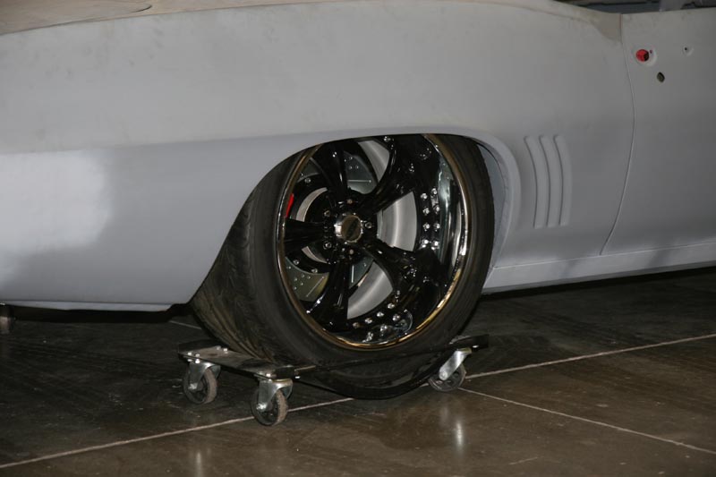

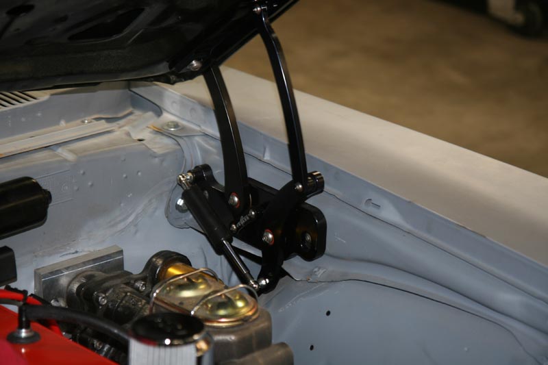

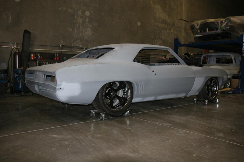

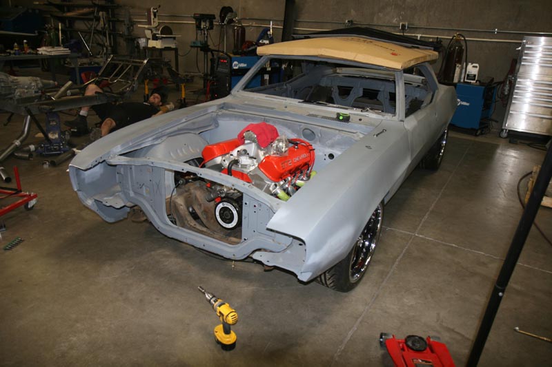

Default Fesler Built new 1969 BB Camaro project update 11
Low Stance
now you have an idea of how low this car will sit, notice that its sitting on a set of wheel dollies so it will sit a lot lower
Check out the new black Fesler Billet hood hinge and yes they are shipping if you are looking for some.

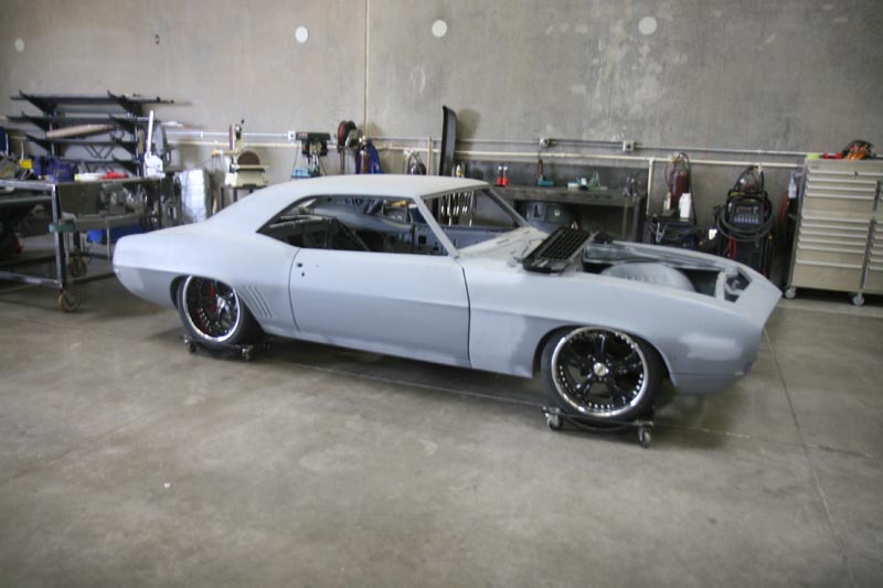

  #28
Old 12-07-2007, 04:43 PM
fesler's Avatar
fesler fesler is offline
Location: Scottsdale, AZ
Posts: 2,027
Originally Posted by HRBS
Looks great Chris..... but,
Is that a 2nd Gen. RS Split Bumper in the background ?
Yeah we have a few 1st gen and 2nd gen Camaro builds going now, I will post the 2nd gen stuff soon for all to see.
Chris Fesler

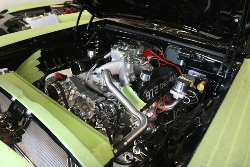

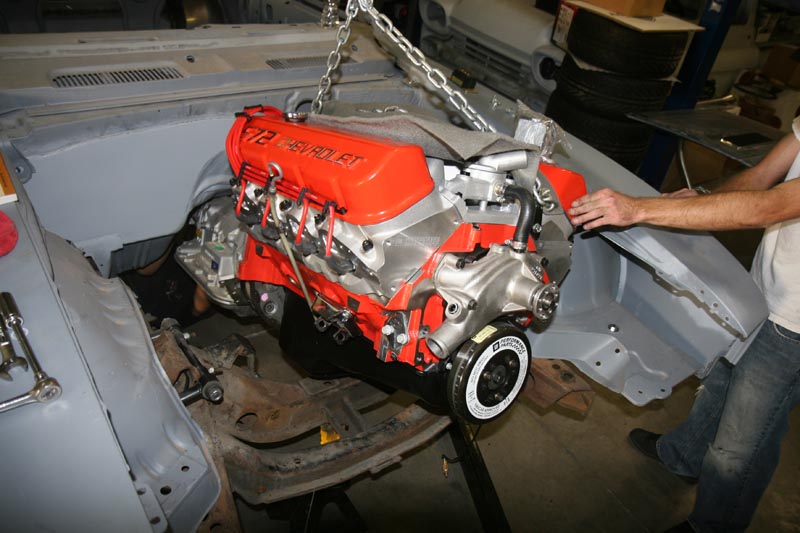

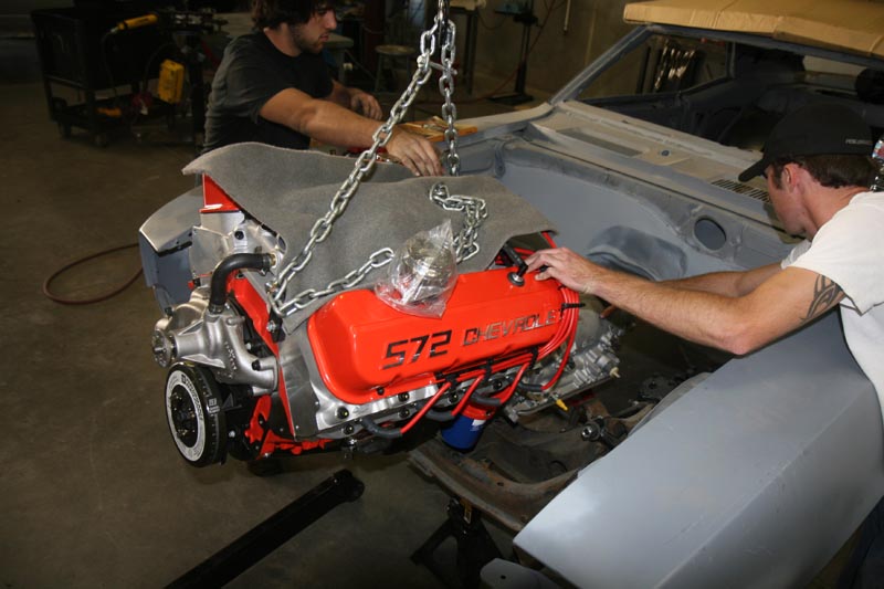

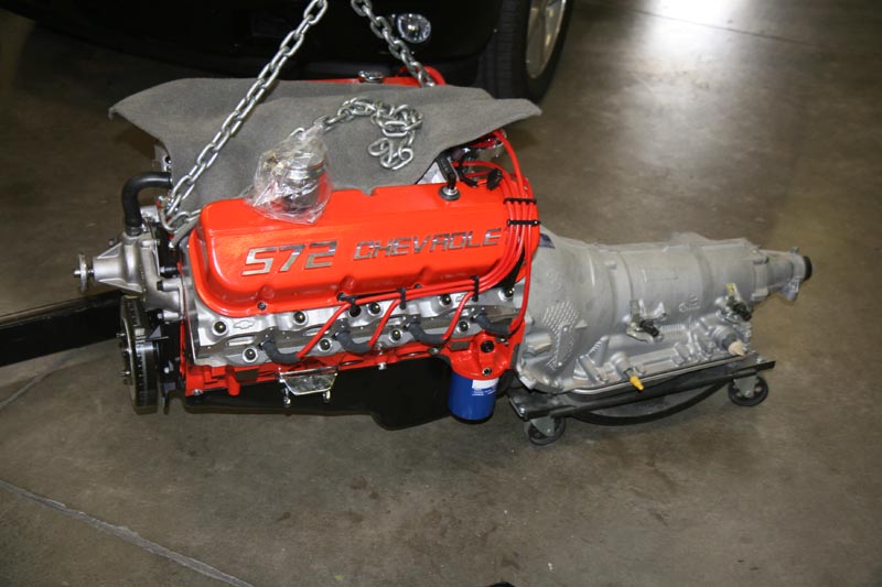

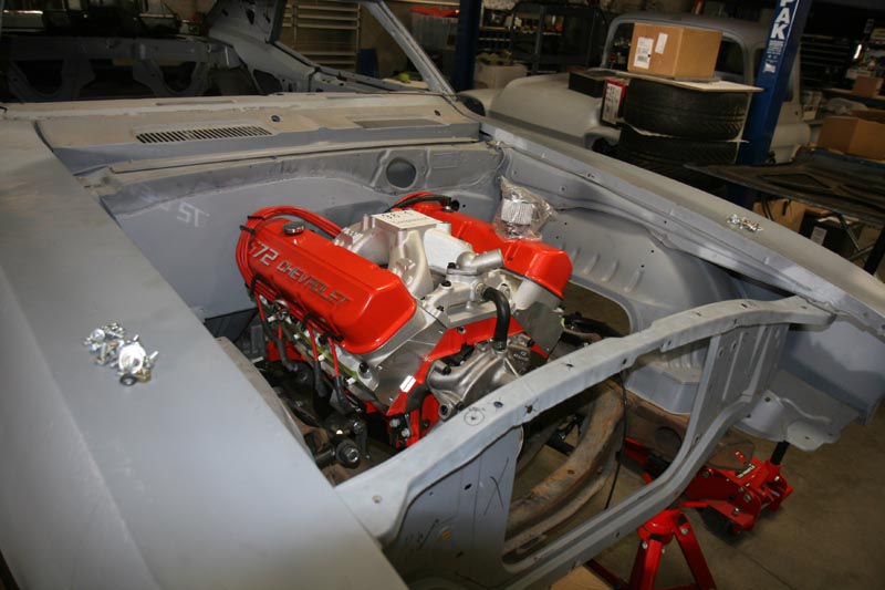

Default Fesler Built new 1969 BB Camaro project update 12
572 anyone
Here is the massive 572 GM Crate engine going into the car for final fitment before paint, we have to do a little mods to the fire wall so it will fit the dist with no rubbing problems
with the 4L80E tranny it huge overall and fits perfect well not perfect we have to do some more work to the firewall to fit it just right and I will post those tomorrow we are doing that right now.
Chris Fesler
