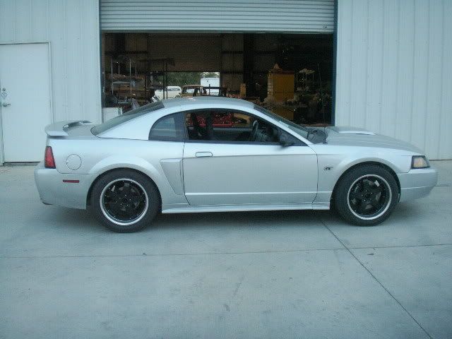

I have an '03 GT that I've upgraded the suspension for road racing!
I went with Maximum Motorsports Max Grip Box and I coouldn't be happier! Your project looks great! Good Luck and update often! I'll be following this thread!
John

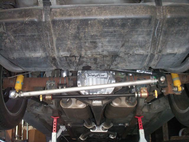

There you go... there is the Maximum kit. It is basically the same for the fox chassis; I think the only diference is the width of the rearends and front struts are shorter on the fox cars.
Both Griggs and maximum Motorsports are excellent companies, but you will definately pay more for Griggs. For a weekend warrior; you will be just as happy with MM.
BTW, I don't think I said it, but those tires look great stuffed under the back of the Cobra.

Looks like a killer project, and wow those are some meats on the back!

Looks like a very complete kit, but wouldn't I still be in the same boat as far as front tire width and wheel backspacing issues? I am sure it makes for an aggressive package even if you ran smaller front tires when road racing, but i think i would still have clearance issues with my tires and wheels. Can go with any different wheels given I have already paid some $$ to have the rear's widened and tires mounted.
Talked to rep at art morrison, and they have the IFS kit in stock on the shelf... tempting...
