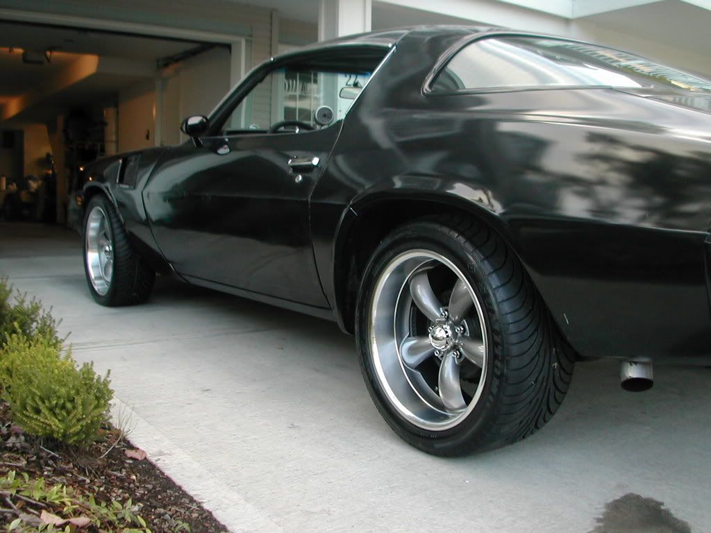

is that true that tubbing = no stock rear seat?
And Ric when you going to sell me the parts
depends on how wide you go.
335 - then you lose 6 inches
315 - you lose 3 inches
305 - you lose 1.5 inch but it's a lot of money for a small gain

so what size = no stock seat use?

you just have to narrow the stock seat.

2 in entension in the wheel house without putting in a full tub
18x8.5 front 245/40
18x12 rear 275/30 /
no rail mods

245/45/18 front
275/40/18 rear
81Z28 protouring project. LQ4, Baer brakes, Global West suspension.

what's the rim width on those?
8" and 10" or?
8" and 10" or?
Front 8" , rear 9.5 "
