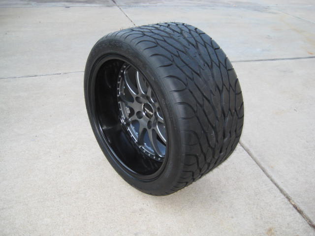

Here is a better picture - outside, that shows how the satin black outers give the tire a thicker look...

Here is a better picture - outside, that shows how the satin black outers give the tire a thicker look... Simply Bad Ass! I can't wait to see this car done. thanks for putting our wheels on it
