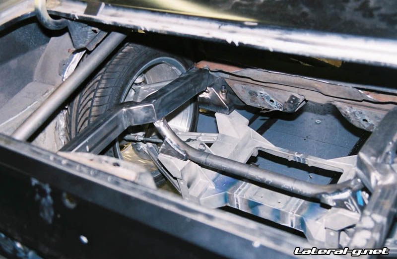

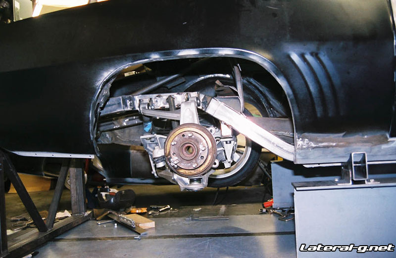

This is not a simple bolt in. I'm guessing a vast majority of that price is the labor.

I don't think it is all that bad for what is required to make that a roller. You have to narrow an aluminum cradle, make new rear frame rails, sheetmetal, etc to package it all in.

Badass! Simply Badass!
I really like this setup, very nice install too.

I takes a lot of labor to do this install roughly 80 hours and that’s if it’s a good solid car with no rust issues to repair. Not to mentions that prices includes new suspension components a used diff shorted half shafts coilsovers and the list goes on. All that needs to be done is hook up the dive shaft from whatever motor combo you want to use. We have three cars waiting right now for this install. I just unloaded a donor z06 chassis yesterday day for one of the cars it helps if the price some if you can get salvage parts but then there is also the chance that they my be bent as is the case with z06 chassis the rear cradle is marjory twisted to it that is the gambel you take buying salvage parts.
