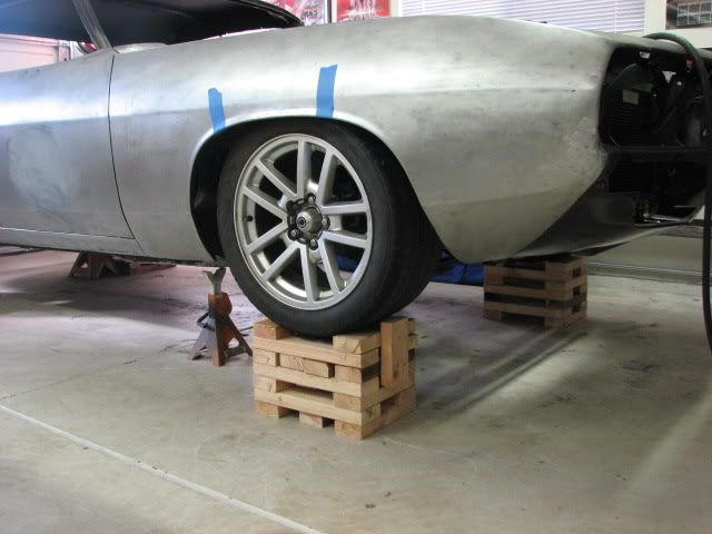

I'm going to do mine 14" x 16"
We are putting a c5 vette on them first, with 305/35/20 tires.
im hoping to get 20" of clearance so we can do a set of headers on the car.

why not just fab some wheel chocks,or just buy some for that matter, and fasten them to the top of the wood stands? Be much safer.
you could also make 2 sets of stands . 1st set to go to max jack height from floor level and second set to you to your working height and then build a stand to put under the jack to reach the working height. It's double work, double money but easy and safe.......enjoy

These 16"s work great the wheels sit in the Hole just right and not putting any bind on tires! and like i mentioned you can set them on there sides aswell for jack stands etc at least for support.

well had enough scrap wood to build 3 out of the 4.. so far, they have cost me not a dime.. Had a bunch of scrap wood left over from my deck from the old railings..
need to buy two more 2 x 4 and a few more nails.

I think I'll turn my boards on edge,,,,,,,, that way all I would need is half the amount of materials! Except I'll need longer nails Hmmmmmm..........

not a good idea. I would think boards on there side could shift and allow car to fall, just doesn't seem that it would be as stable.

I went to the DSE site and your stands look to be the same size. I still think they look (even the DSE ones) a bit small. Cool though.

I made mine last weekend...
I made mine 15x15 in the rear and 12x15 for the front both 7 boards high. I made a "limit" sticking up on one of the front just as one more little thing to help just in case it rolls.....doubt it will and that piece aint gonna hold much back but I figured what the hell..
I'm going to be doing a 335-35-20 rear and 245-35-19 front.
I had a bunch of small scraps so I put one of them into the gaps...same thing...what the hell...alittle added strength
I'm gonna keep jackstands under there just in case......
