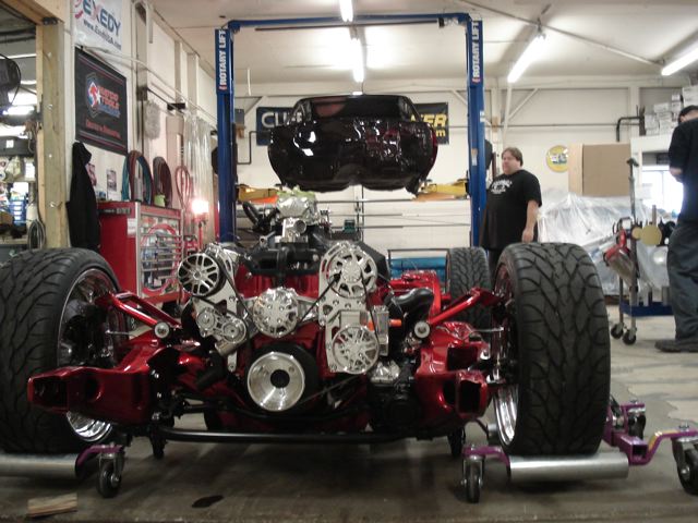

A few more build pictures.

The seats started as Honda or Acura 2000 year range(don't know exactly). We then cut the cages down and made them a little wider too. My leather guy carved new foam to make them look as they do now.

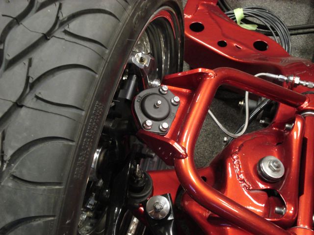

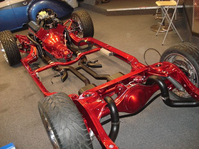

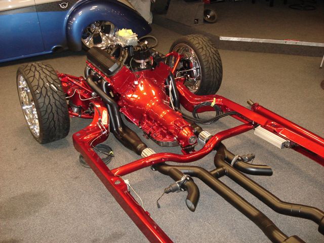

Beautiful car. Those 2 pics of the the frame all painted or powdercoated looks SOOOOO SWEEEEET!!!! I could look at those pics all day. I especially love the black ceramic coated exhaust. Do you mind sharing the color and the place you got them done at? I am going to have my exhaust ceramic coated and would love to do something besides the chrome look. Thanks

Hey Josh, Just want to say you too build some killer stuff. I saw you work over on the 67-72 Forums I have a 68 in the works myself that we built a chassis for and it has one of Nathan's Porterbuilt crossmembers in it 20s,22s, the list could go on & on. But again your work is awesome. On the exhaust I do a high temp powder in black first(bake it) then a black texture on the second coat then bake it a second time. It gives it different looking finish. I just do the headers in high temp black because after doing the texture on headers we found that it doesn't like the high temp. that close to the motor. I use a flex joint on all our exhausts and from there back the text holds up fine. I have been doing it for about 3 years now and we have it down pat. The sky is the limit on the colors we can do to. My buddy Jason at Allegheny Metal Finishing is the one to talk to if your interested.724-695-3233 just tell him you know Curt he'll give you the hook up. Hope that helps. Thanks

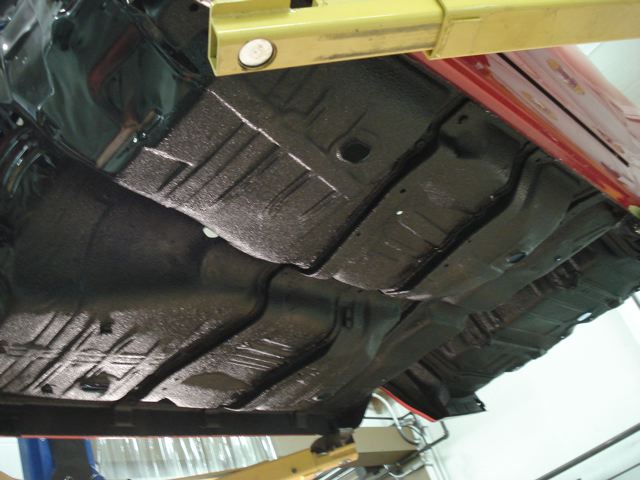

few more pics.
