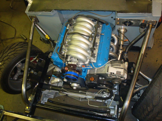

Got a few of the down bar bent and welded.Ron

Got the coil and radiator mounts made,hoping to be making smoke very soon.The cool part about the way the chassis is made,is that I can terrorize the neighborhood with no front clip on the car.Can't wait.Ron

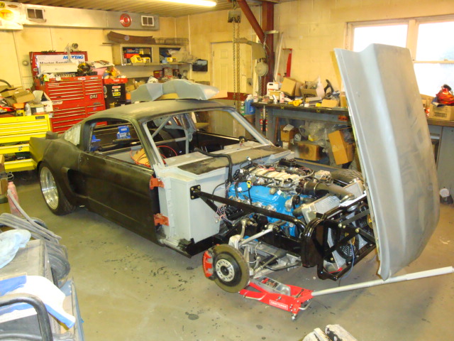

Got the brakes up,getting ready to fire it up,love the way the fenders come off so easy and the hood flips that far forward.Ron

Here are some pics of the cars first blast down the street,still cleaning the bugs out of my teeth. Ron http://troyboy468.smugmug.com/galler...7_HN3dp#P-6-15

Default Ron, you really need to change the title to this
thread. This car is so much more than Muttstang. One of my favorite builds in quite some time.
Mustang/ Corvette hybrid would even give a better description.
So have you hammered on it yet? Enough power?

Yeah Payton,it just blows the tires off.Roads up in the country where I live aren't exactly perfect.I really have to start the beautification process though,until the car has some glass in it I won't get a true sense of how it feels.{Everything feels fast when the wind is in your face}.Ron

Ron,
Thanks for posting your pictures.
Your car looks tough...I like picture #79.
