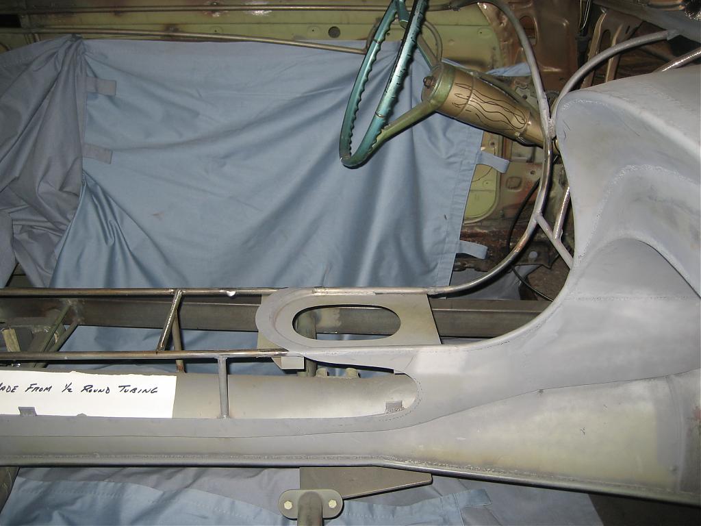

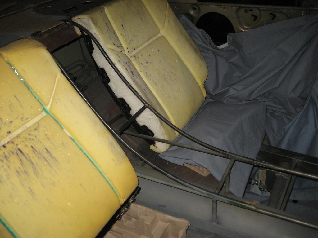

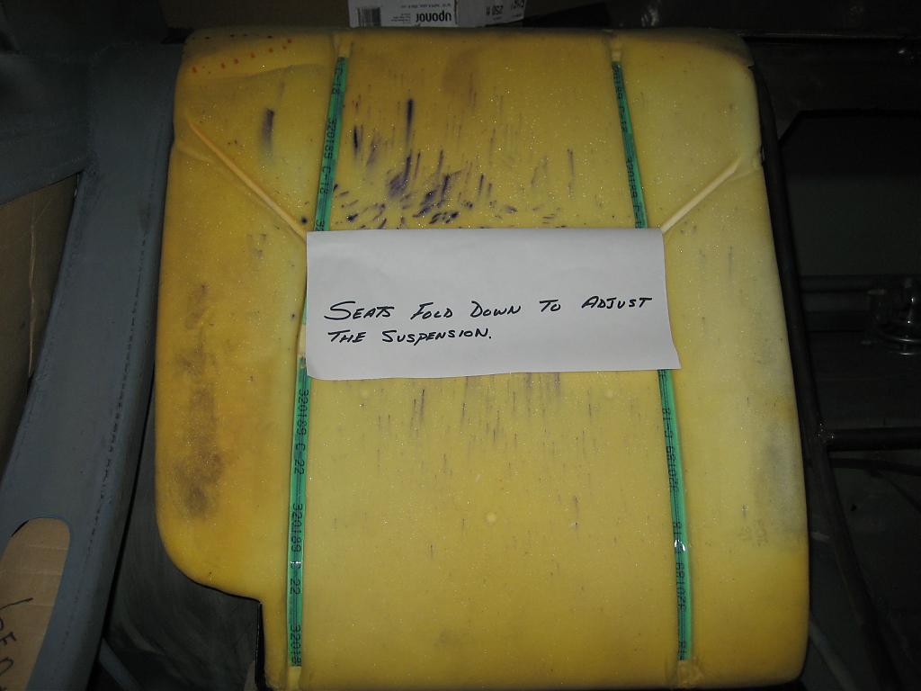

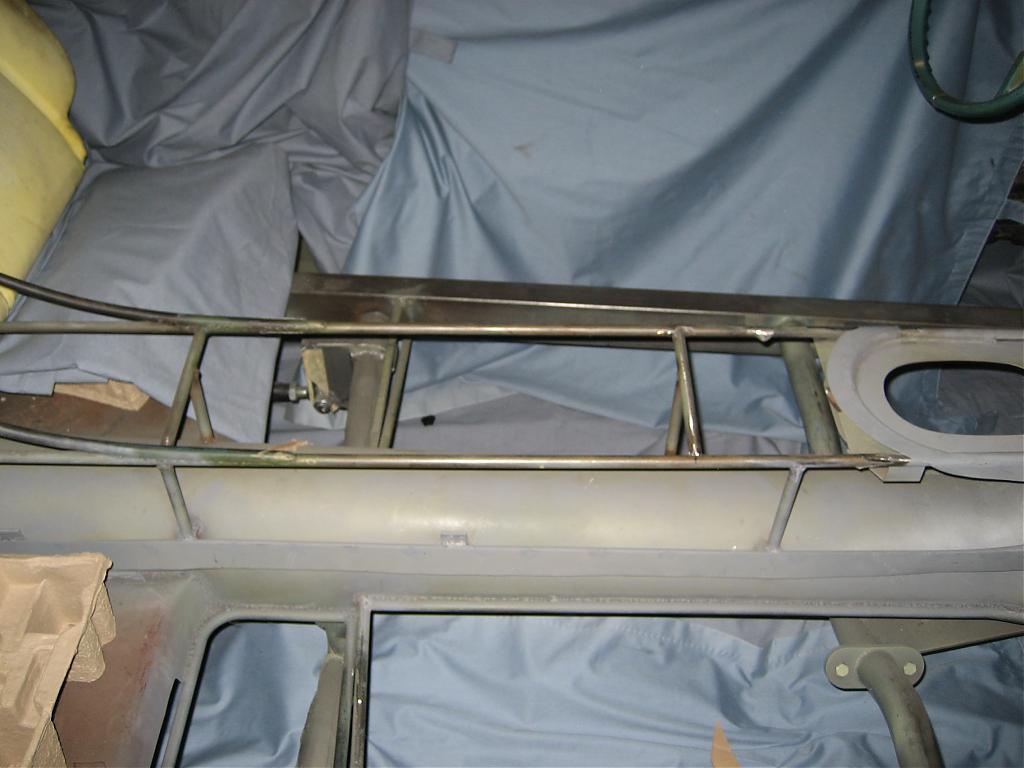

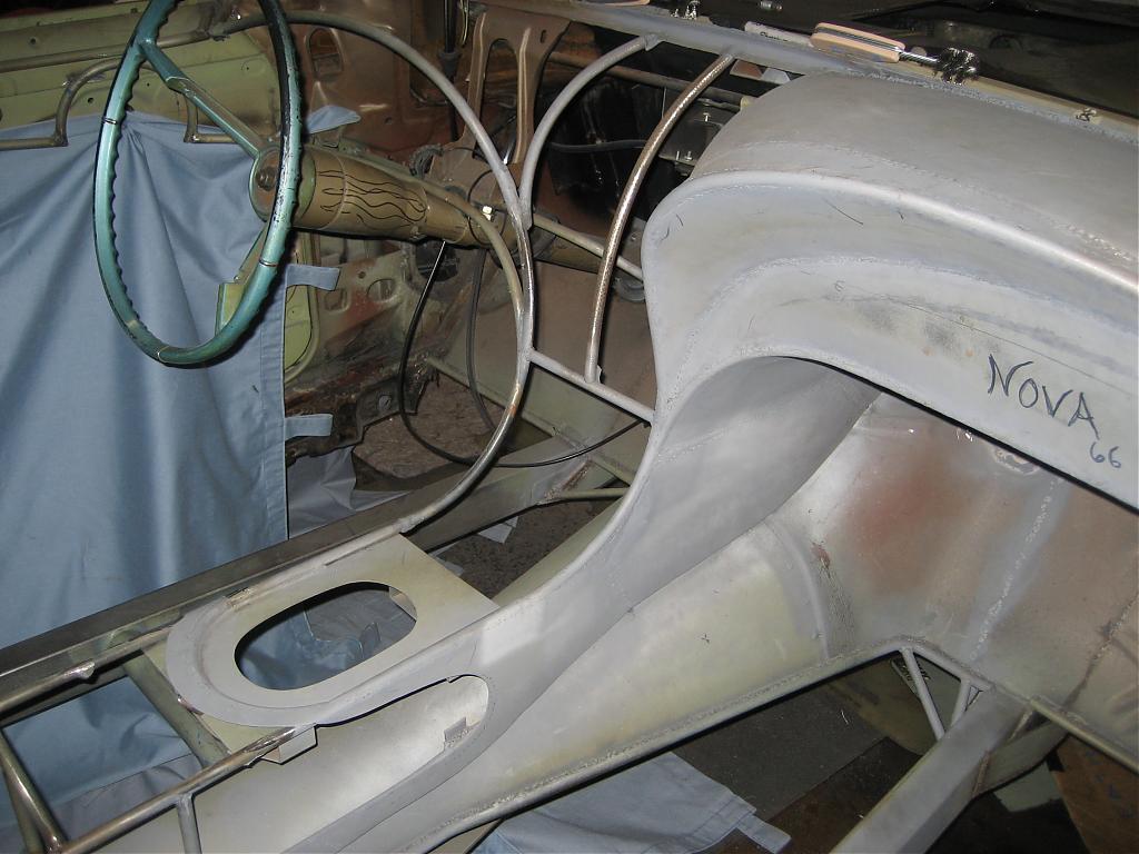

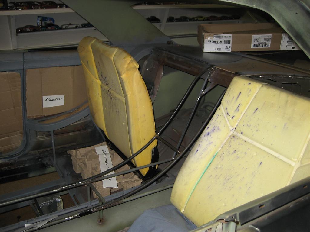

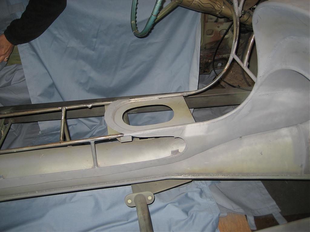

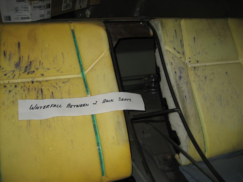

I have received some questions regarding the console and back seats and if they will all flow together. The answer is yes the dash will flow into the console with a waterfall look and thenn flow between the front and back seats and then into the back window deck. The console was made out of 1/2 round tube steel. The 2 back seats will flip forward so i can adjust the suspension and have access to battery. There will be 2 floors so that i can have all the brake lines,fuel lines and battery lines hidden.
The following pictures show the dash flowing into doors and finshing into back side window. Also pictures of the console flowing from dash through the interior into back window deck.
More pictures to follow
