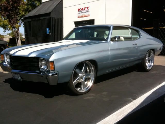

I used all of they're products on my A-Body (Tubular upper and lower control arms, Tubular Trailing arms, Front and Rear Disk brakes and booster/master cylinder, 2 in drop spindles and 3 in rear lowering spings) I also bought QA-1 coil over adjustables and Hotchkis sway bars. All at a very affordable price being that the aftermarket for suspension can be very expensive.
My Chevelle handles like my 09 Lexus is350 and stops almost as well.
