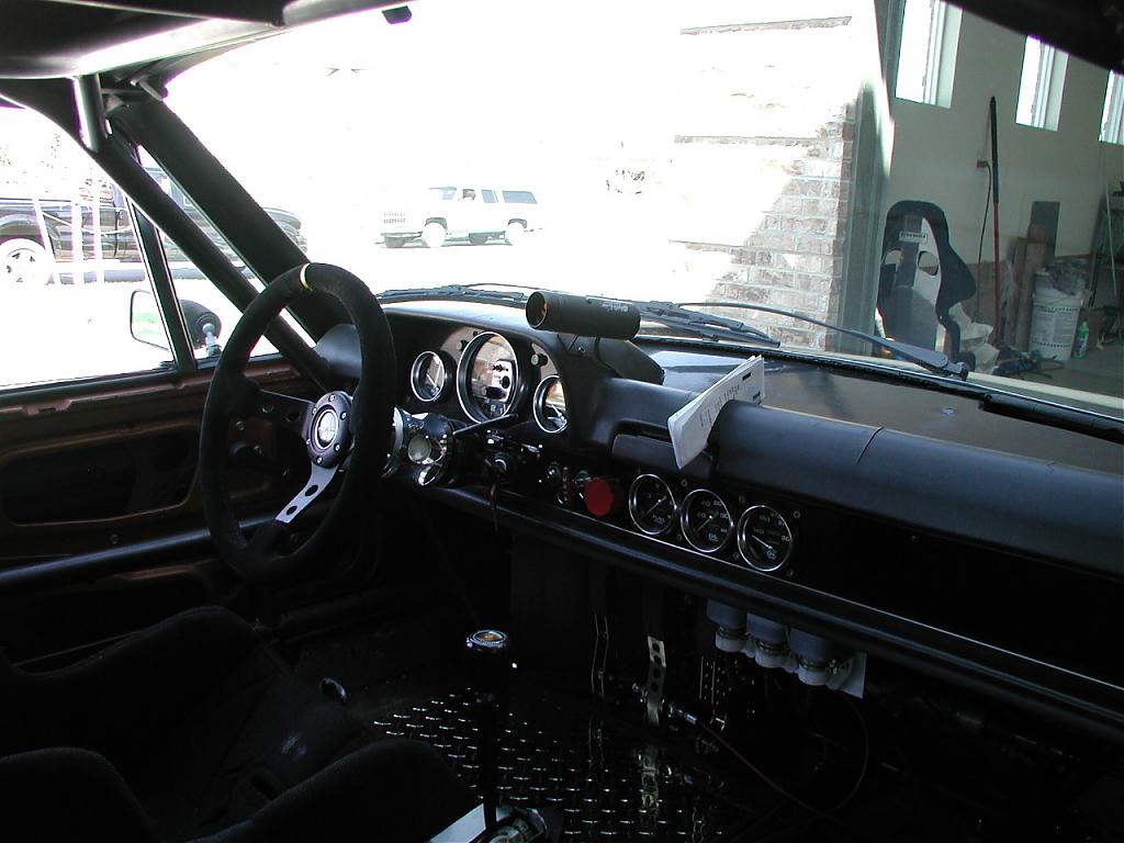

That Tilton pedal set is nice -- but I sure as hell wouldn't have accepted that crap plumbing! What a snakes den of crap that is!
Have to agree, when I saw that car at SEMA last year it was the first thing I noticed since I have those pedals in my racecar. Just wait 'til they have to swap a master cylinder out and the fluid is dripping all over that nice carpeting. The car, otherwise, is freakin' sweet but that is just a last-minute, slap-it-in-there looking setup and they should have boxed the floor in so the masters were accessible from outside.
Back on topic with that set, I can say that they are well designed for heel-toe work - note the spacing between the gas and brake v. brake and clutch, quite nice for blipping throttle for downshifts going into the corners, etc. Here is mine, note they are gold anodize as they were one of the first sets they sold, they are black now as a standard. You have a lot of fab in your car so fabbing the floor a bit to work with these and move the masters exterior would not be unreasonable. They are technically floor mounted but using the master mount location thru a boxed section would add extra rigidity as well.
Don't have the best shots of them here at my work computer but one that shows the wheel really closely you can see how well spaced the brake and gas pedal are - you may note it is better to have driving shoes on cuz the typical tennis shoe can be wide enough to clip the edge of the brake pedal when flooring it into straights.
