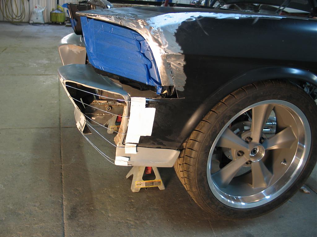

More work done! Got the mini tubs finish-welded, and the firewall metalworked, complete with recessed Hydroboost mount. Next is creating seat mounts flush to the floorpan so I can utilize the electric controls on the Cobra seats. The wire form is to make a framework for Percy's Hyperfiber to recontour the fiberglass facia to match the new profile of the 06 Healdights. will have photos of that process, as well as the solid headliner project Im doing with Hyperfiber as well.... pretty neat product. UV cured, has all the resins already in the weave, and has unlimited open-time as long as it's not exposed to UV.... kicks in moments when brought into natural (sun) light or artificial UV sources such as black lights. More on that later...
