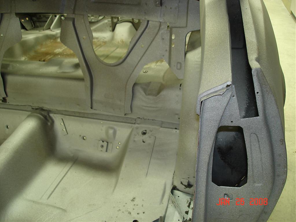

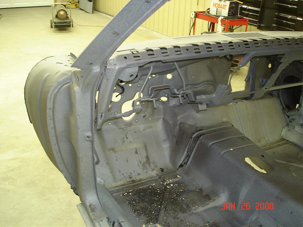

Here are a few pics as requested.
Thanks.
Ron
1969 Firebird, 4-speed Coupe
If GOD is for us, then who can be against us!

So --- looks like you're going to need
Quarters
Inners
Trunk
Rockers
full floor
tailpan - might as well replace while you can
You didn't show door skins - would assume they're bad as well??
Quarters
Inners
Trunk
Rockers
full floor
I have already purchased one Full Quarter, one partial Quarter (but I may end up ordering another Full Quarter instead), Full Floor, Full Truck, and both Rockers.
Driver's side door will need a new skin and the passenger side could be fixed but I will probably re-skin that side also.
The fenders will have to be patched on both driver and passenger side.
Ron
If you have the option Ron, the full quarter is ALWAYS a better end result than the partial. If you can get one you won't regret it.
You may also need the inner wheelhouses and trunk drop offs. When you peel the quarters it will really show what's needed. Best of luck with it.
And if you are doing both quarters and one door replacing the other door only makes sense. If you look at the time required to patch a door skin versus replace the skin, not much difference in time and the full skin will give you a better finished result too. Worth the extra buck for the part in my book.
I will probably go with both Full Quarters that way I know no problems will pop up on me down the road. I actually bought the truck drop offs as well. Once the Quarters come off the area behind can be cleaned and treated.
