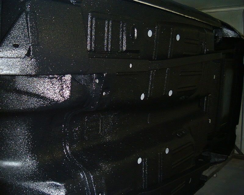

I used a product called MacroPoxy a 2 part industrial epoxy to seal of the wheel houses on my project. This stuff is what they use to seal water towers with and seems to have incredible duarability. Goes on via a roller or spray can be thinned, or tinted. You can pick it up at Sherwin Williams.
The flash from the camera throws off how uniform it went on with a roller. How ever i would spray it on for the best finish. It can be topcoated also if you need.

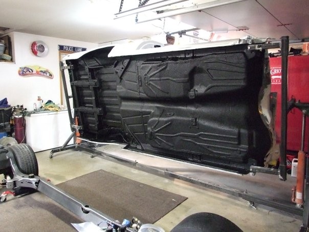

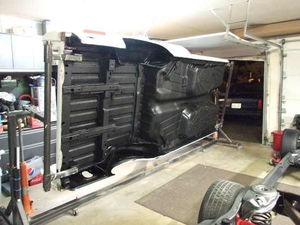

I used Line-x on my El Camino. I shopped around at several of the shops in my area and found a big difference in price. The shop that did it was the best price and showed the most attention to my needs before and during the process.

I went with Line-x and masked and painted the rails. It was a total bizznatch even on a rotisserie! I had something like 6 hours into masking alone. I really liked the way it turned out though and should be bullet proof for a long time. I blasted the bottom with a pretty course grit just to give the material extra bite. You have to be careful with drainage though.
