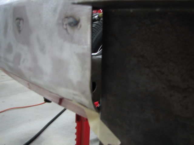

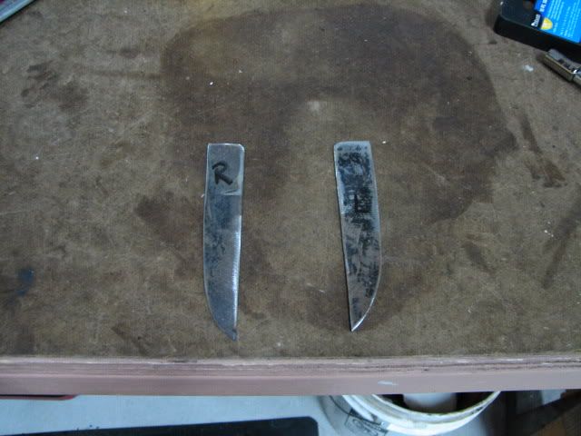

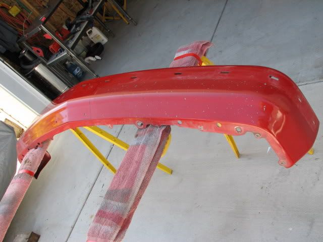

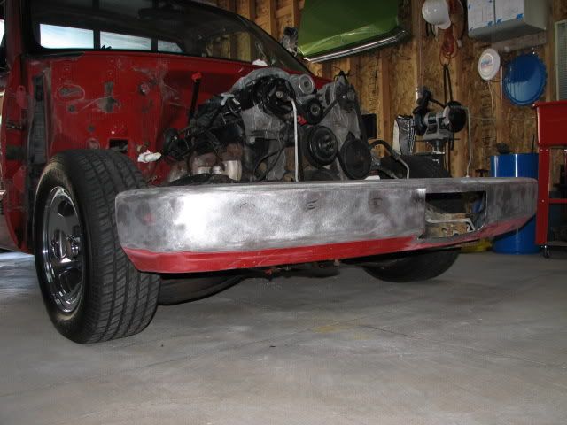

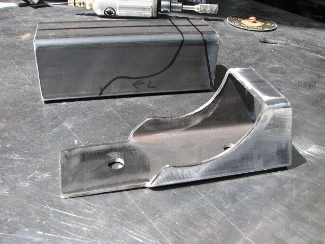

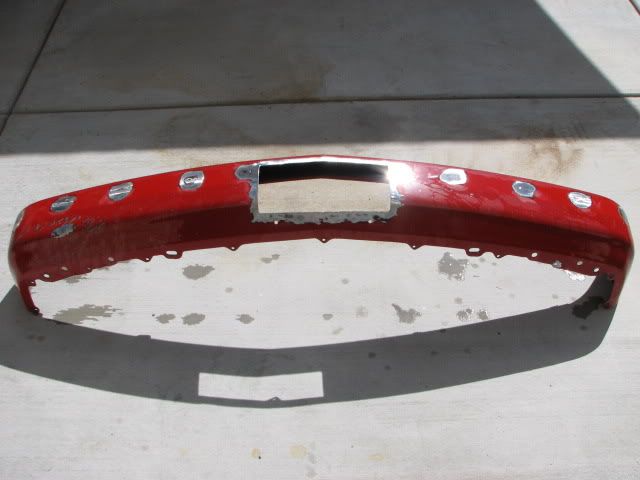

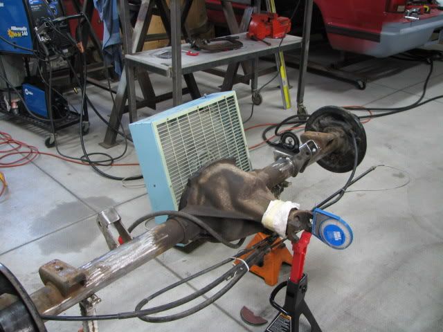

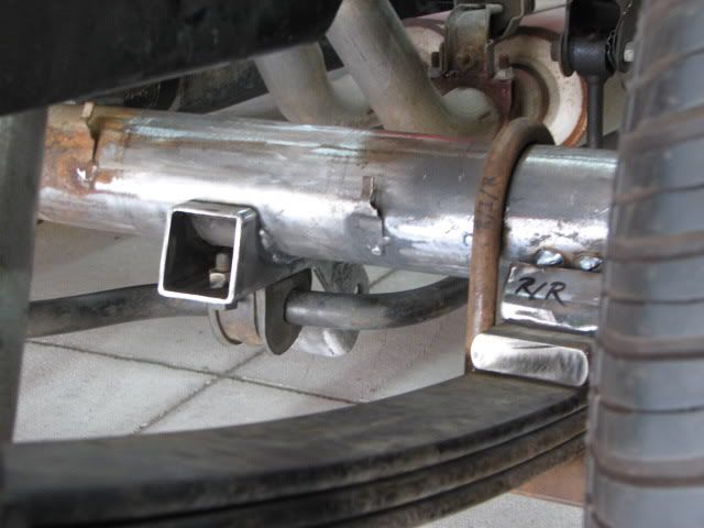

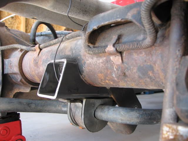

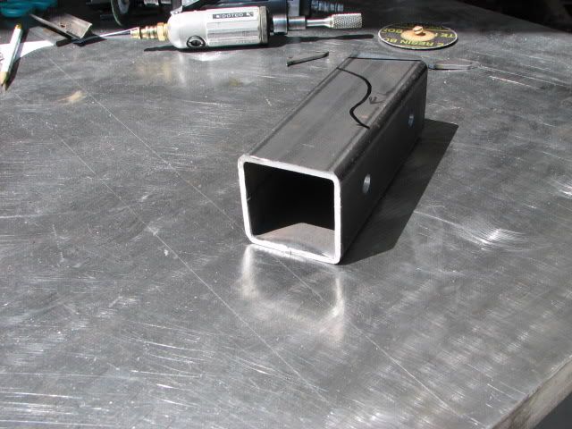

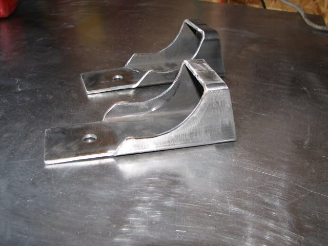

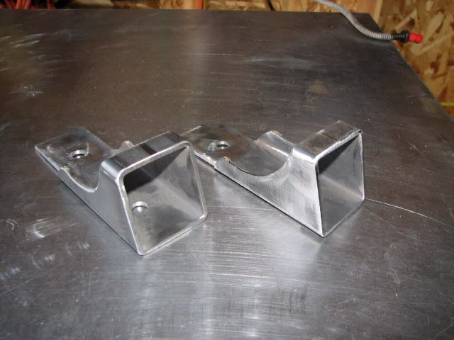

I worked on brackets for the sway bar last week end. I was also going to purchase and install a smooth front bumper w/recessed license plate, but decided to just smooth mine and recess the plate. Saves me a couple of bills, and I don't have to store the old one. Here are a few pictures.

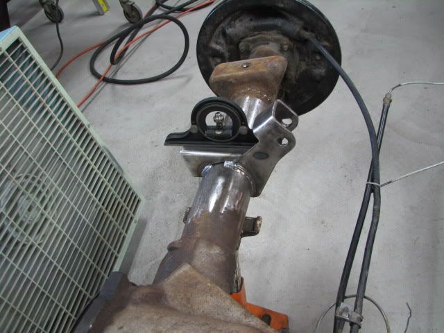

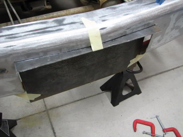

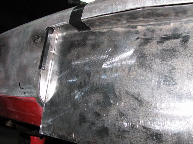

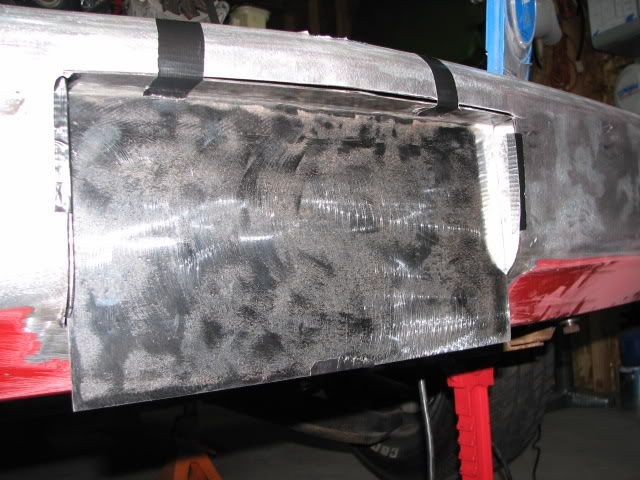

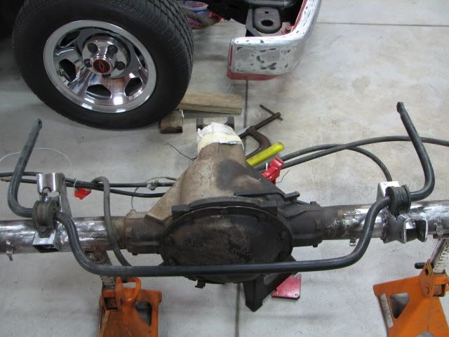

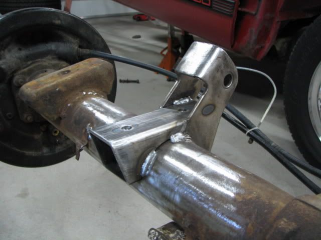

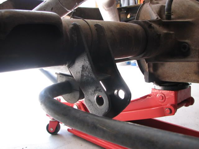

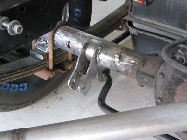

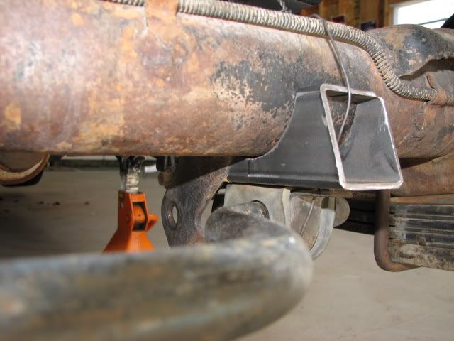

I worked on the front bumper & rear sway bar mounts, Friday night & Saturday.
I still need to radius the lower corners and punch the holes for the plate.

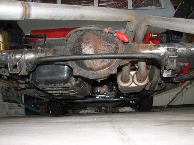

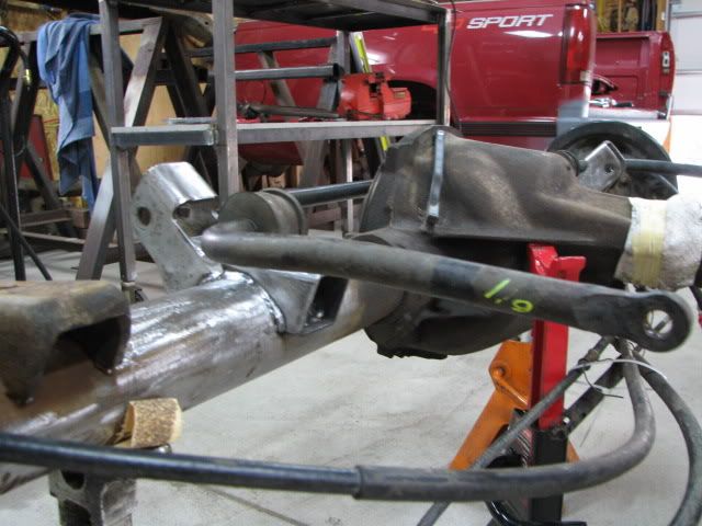

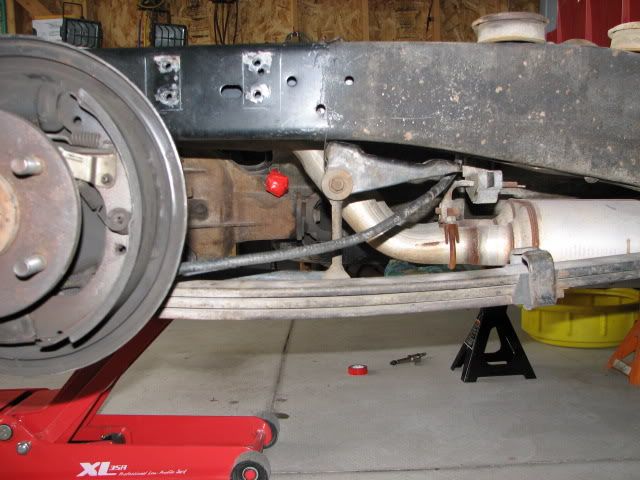

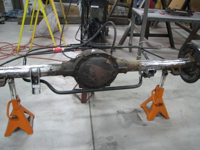

I put the rear end back in place today to locate the new spring perches, and bolted up the sway bar to make sure everything fit right. Remember I am doing the mock-up on the old frame before I xfer everything to the new (old) frame. The old perches had the rear pinion pointing 5 degrees up. Everything seems to fit really well. Now I can get the cab off and really start getting after it.
