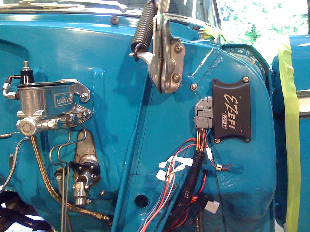

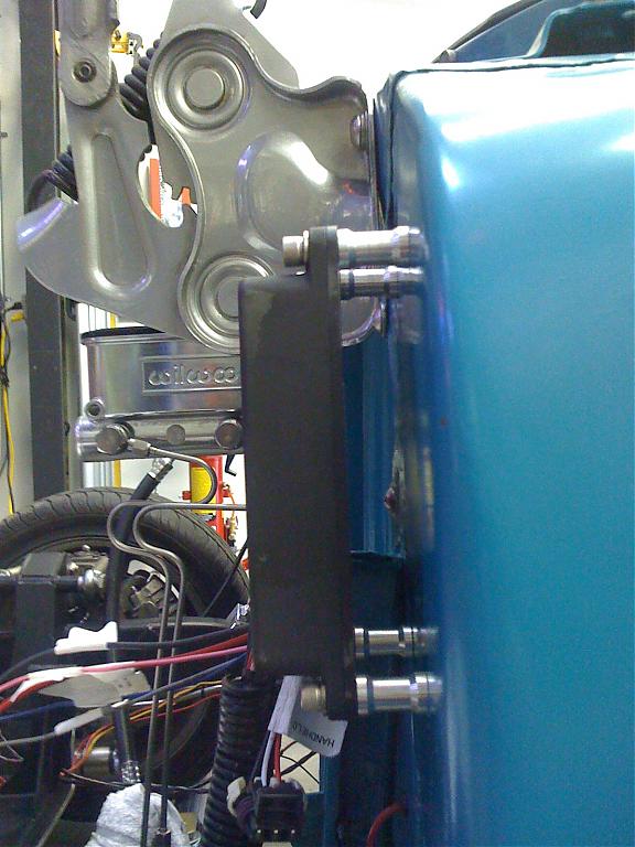

Here's a couple of pic of it on the dyno:

zc --
All my doubts have been erased... never in my wildest imagination did I really believe it was going to run this fine that quick...
I've spent THOUSANDS of dollars on EFI stuff and TUNERS.... NEVER AGAIN... The ECM / harness set me back a lousy $900.... bingo -- done.
