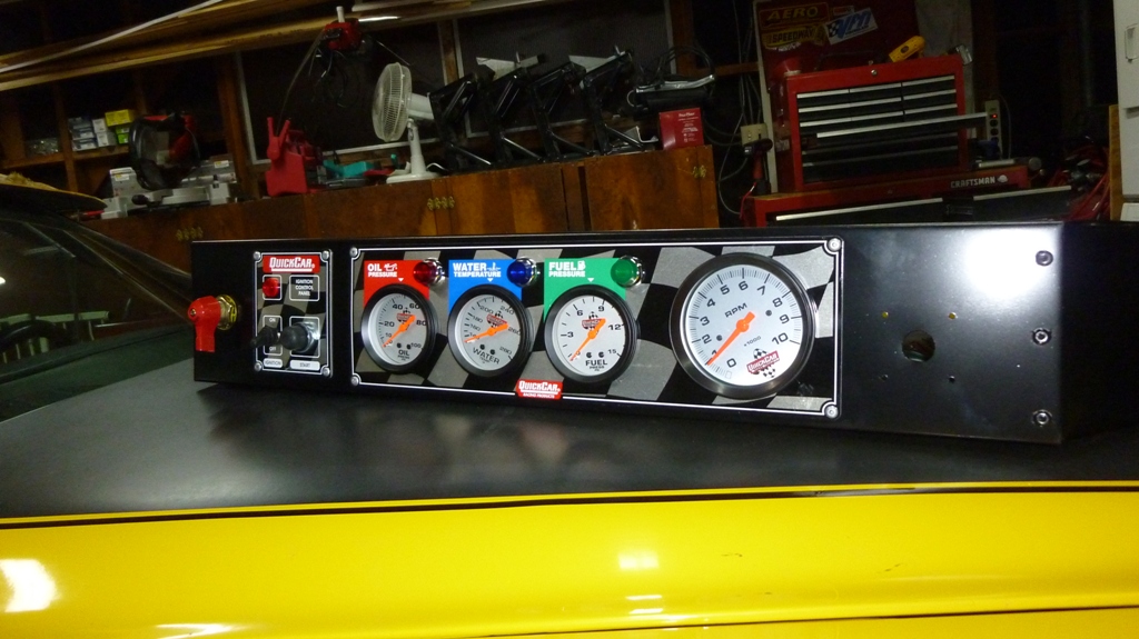

You really got everybody off of de-caf in the last vid.! BTW Is that .040 aluminum in the dash?

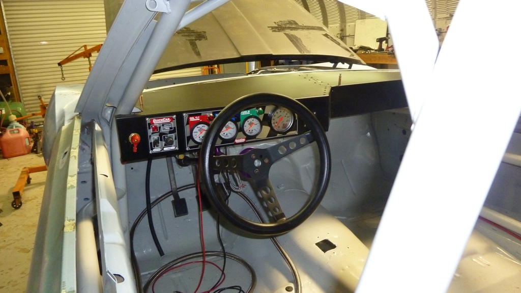

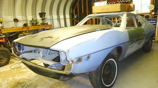

basically finished the dash and hung the fenders/hood on the car. need to fab some kind of grille setup. Don't know when I'm going to be ready to race. I'd love to make the March date but we'll have to see how things go.
more pics and another time lapse at: http://asifnyc.com
oh, and not sure what thickness the aluminum is. it's what the dirt modified guys use for body panels...

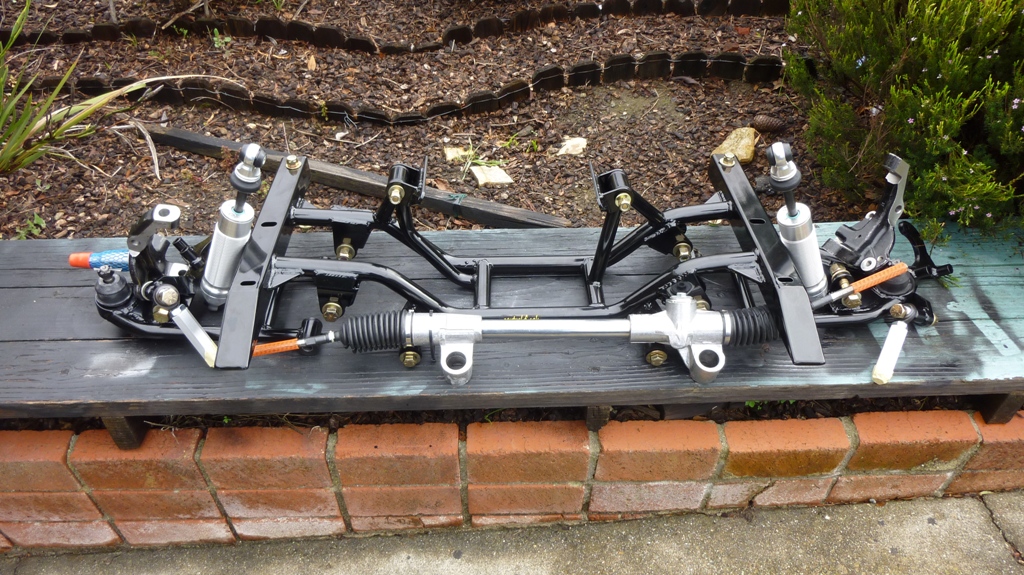

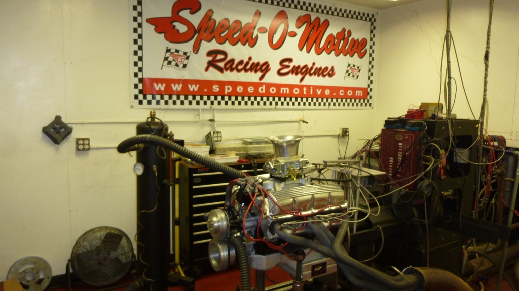

got some big parts today. The IFS I've been waiting months for arrived and the trans I had Astro Performance build me showed up too. and next Friday I'll be in West Covina at Speed O Motive for the engine dyno session, then I bring it home! More updates on the blog. Here's a couple of pics:

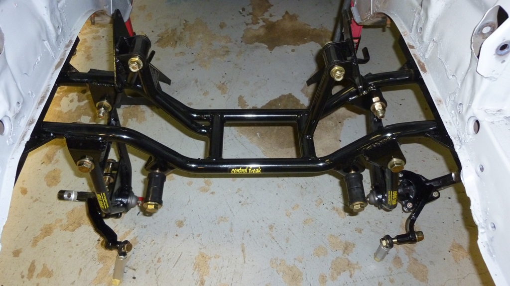

thanks Scott. got most of the IFS installed yesterday...

Frt. suspension pc. looks very well built.I love these humster AMC's.Keep the update's coming. Scott

and now I've got a motor... I'm hoping to get this thing on track in early May... once I drop the motor in I can really get some plumbing and wiring done and figure out the steering linkage... more at: http://asifnyc.com/?p=955
