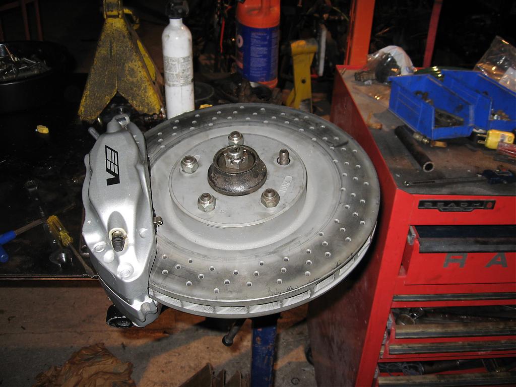

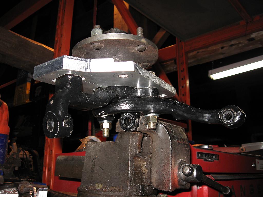

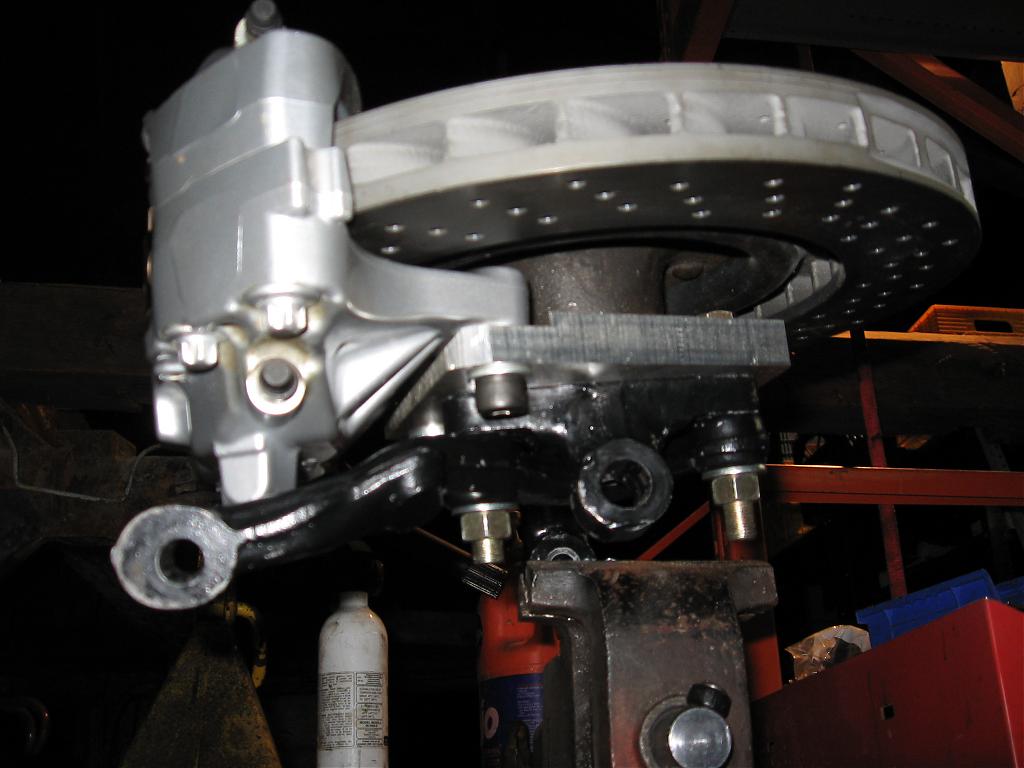

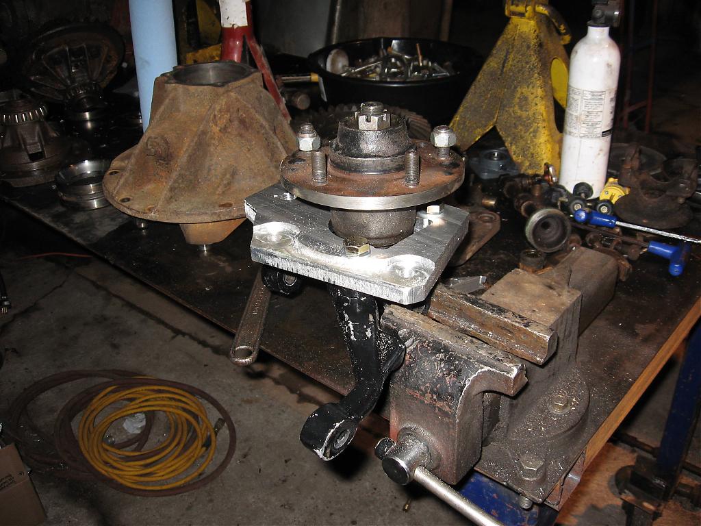

Originally Posted by 67rsssls View Post
Car looks great! Do you have any more pictures of the front and rear brake setup you built?
I can't seem to find pictures of the finish product, but found some of the first rough cuts for fitting in the front
Don't have pictures of the rear. Car put away now, but next time I pull the rear wheels off, I will try and remember to take pictures and post them.
