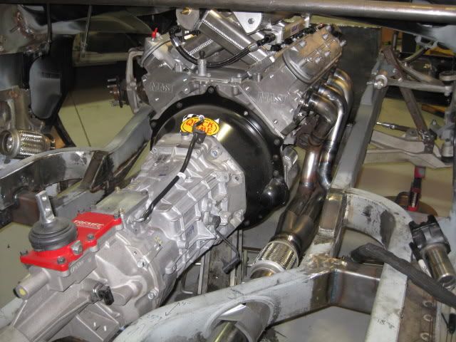

Weve been crazy busy lately and haven't had much time to post new pics, but our Mast Black label 416 LS3 is mounted up
Headers built....
Motor mounts built.....
Oh yeah and we dropped the whole center of the frame down (possible due to dropping rockers 3") to give some headroom and a much more ergonomic driving position......
Trans mount.......
the rack mounts were rotated to provide clearance for power steering pump.We also dropped the crossmember for crank pulley clearance.
