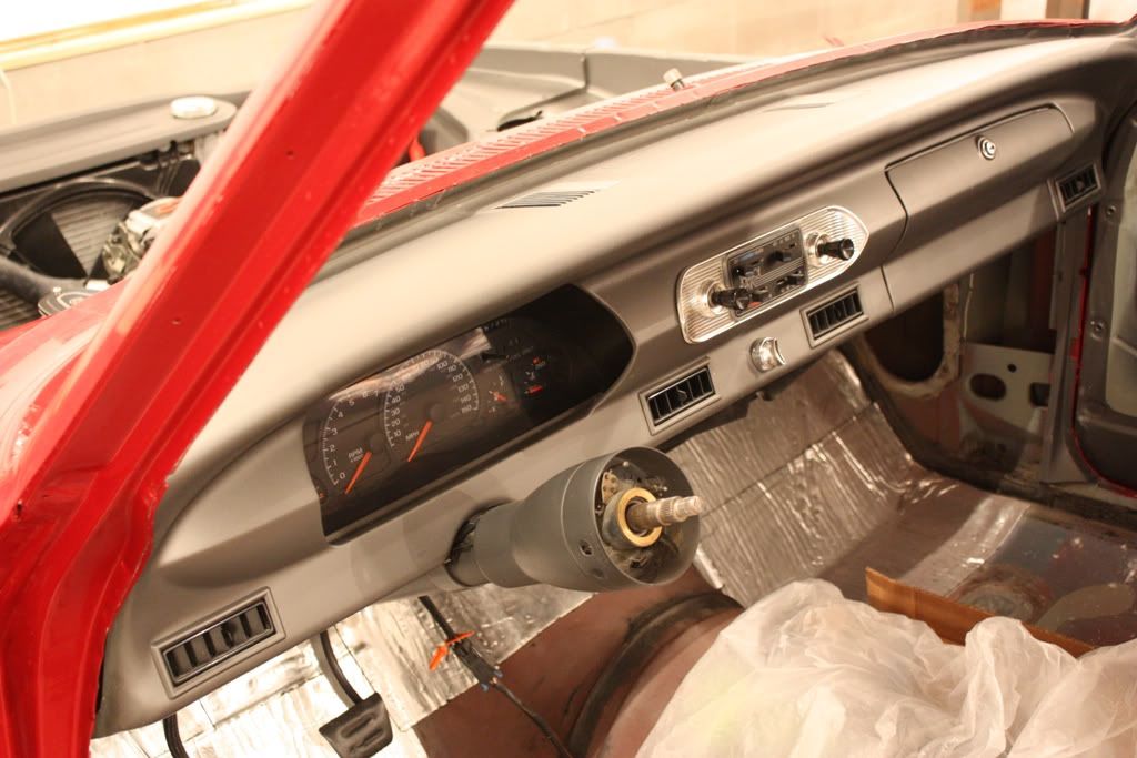

Finished dash and gauge cluster installed.
Radio removed and replaced with Vintage Air control panel. In place of radio control knobs are the light and wiper switches.

wow that looks pretty cool!!!
I'll admit when i say the first pic and the text that you were gonna use a 4th gen camaro cluster i said "oh no" lol but seeing in there it looks awesome!!

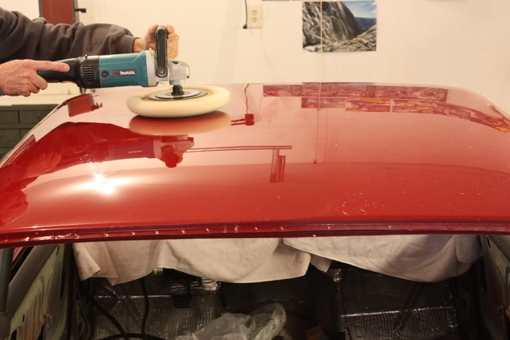

Paint system is BASF Glasurit base/clear. Finished sanding the clear coat. Sanded 600 grit 1st to flatten any spray texture. Then 1000 grit, 1500, 2000 and finally 3000 grit.
Here's after 3000 grit:
Starting to buff with Mother's Rubbing Compound:

A few shots after Mother's rubbing compound using wool pad:
After rubbing compound will be polish with foam pad.
