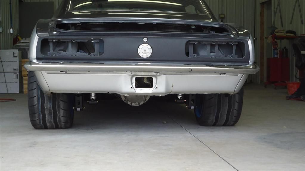

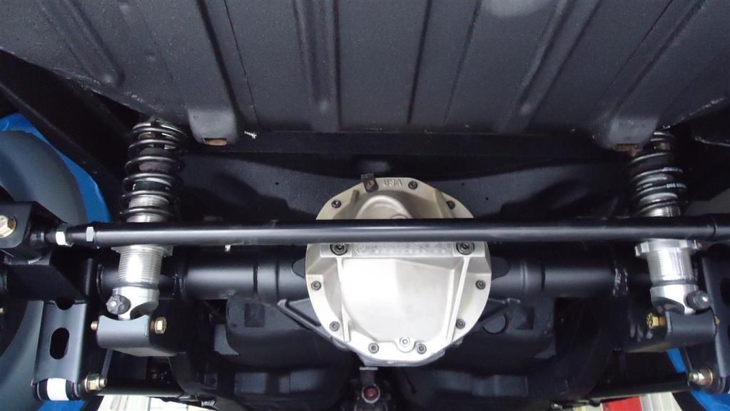

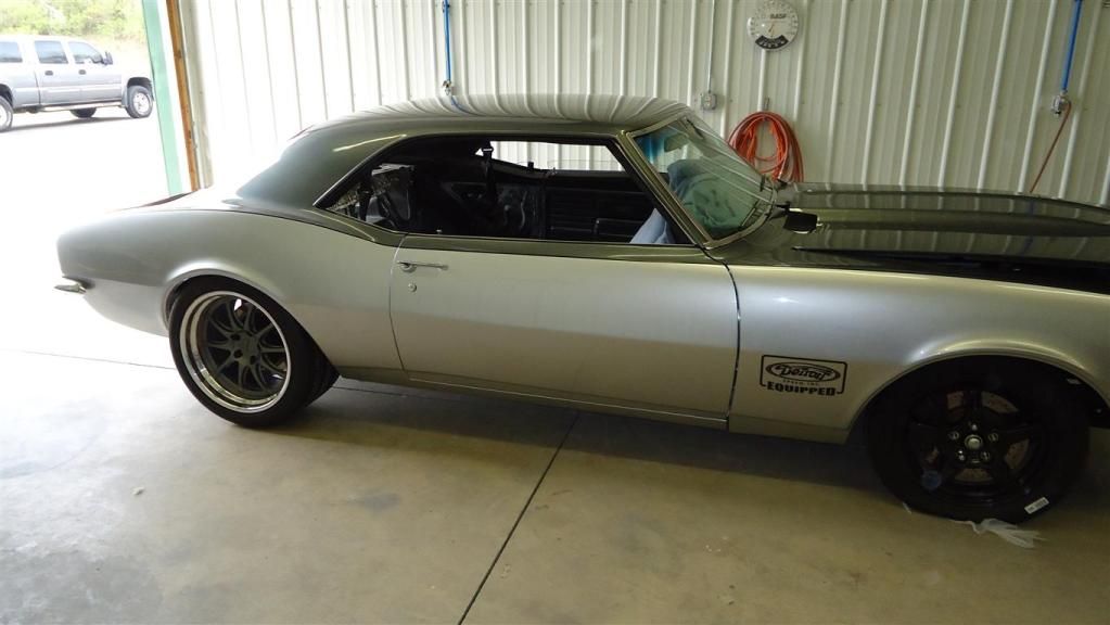

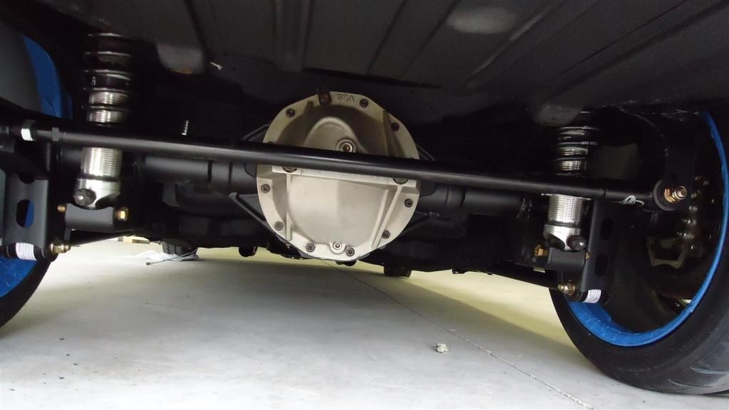

Went down to Joe and Paul's shop this morning and we got the axles in the rear end and the QuadraLink back under the car. This is the first time the car has been on the ground since it was a leaf spring car last fall.

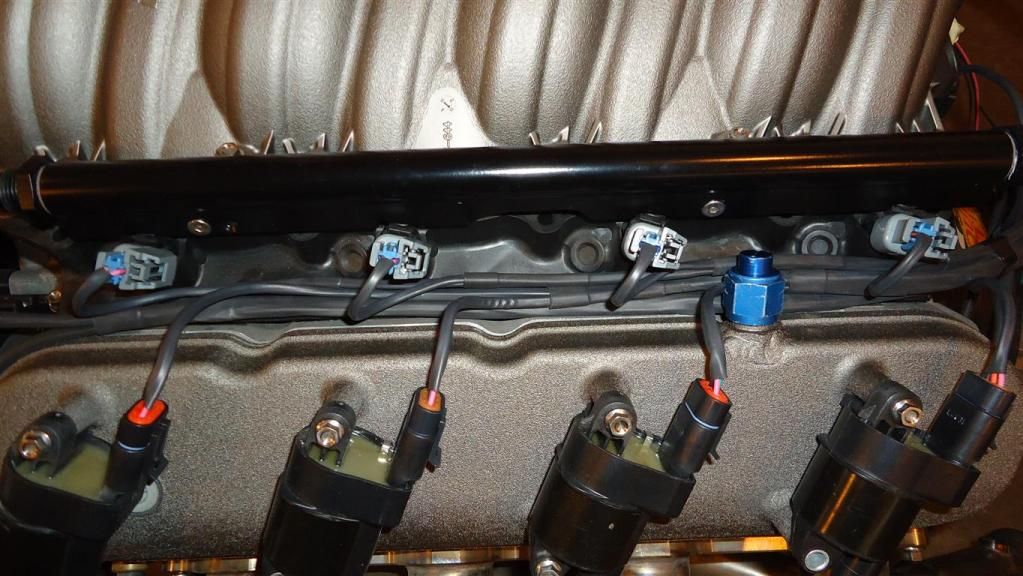

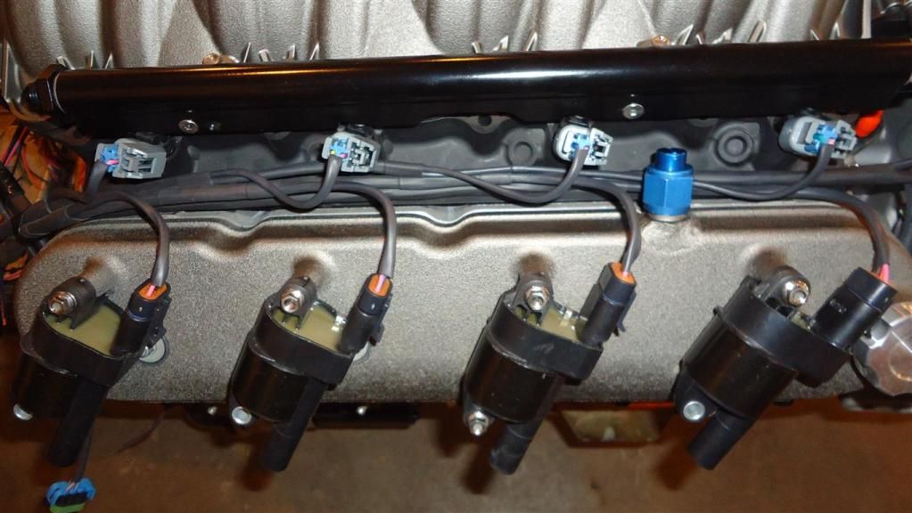

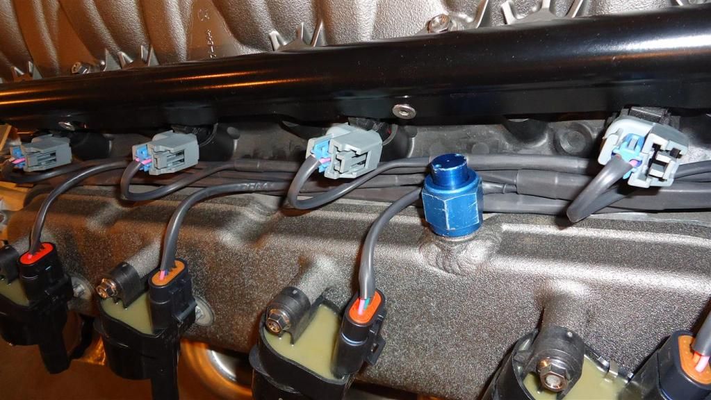

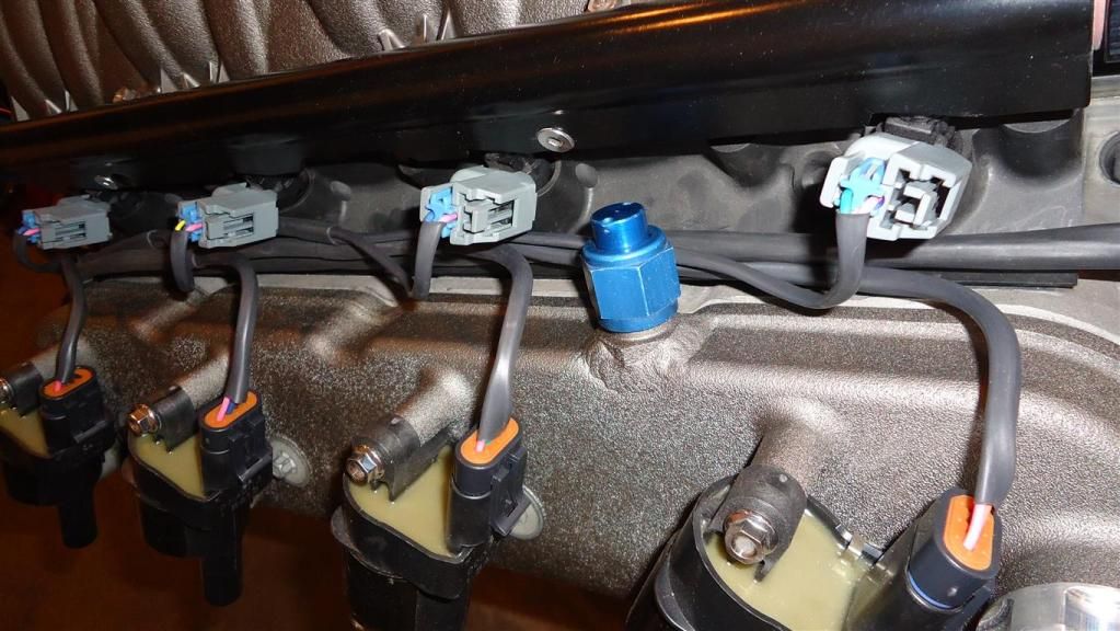

Here are some more pictures of Paul's engine harness. It is coming a long really well. I'm hoping to have the engine side of the harness done by Wednesday.

Thanks a lot. I ordered the connectors to make this a two piece harness yesterday. I'm hoping to have the harness done by Wednesday. With any luck I'll be able to post some pictures Wednesday night. We are using four 16 pin GT150 connector to connect the two halves of this harness. They aren't the firewall bulkhead style. They will sit just above the bellhousing and with the engine in the car you won't see them at all. I'll get some good pictures once I have it together.
