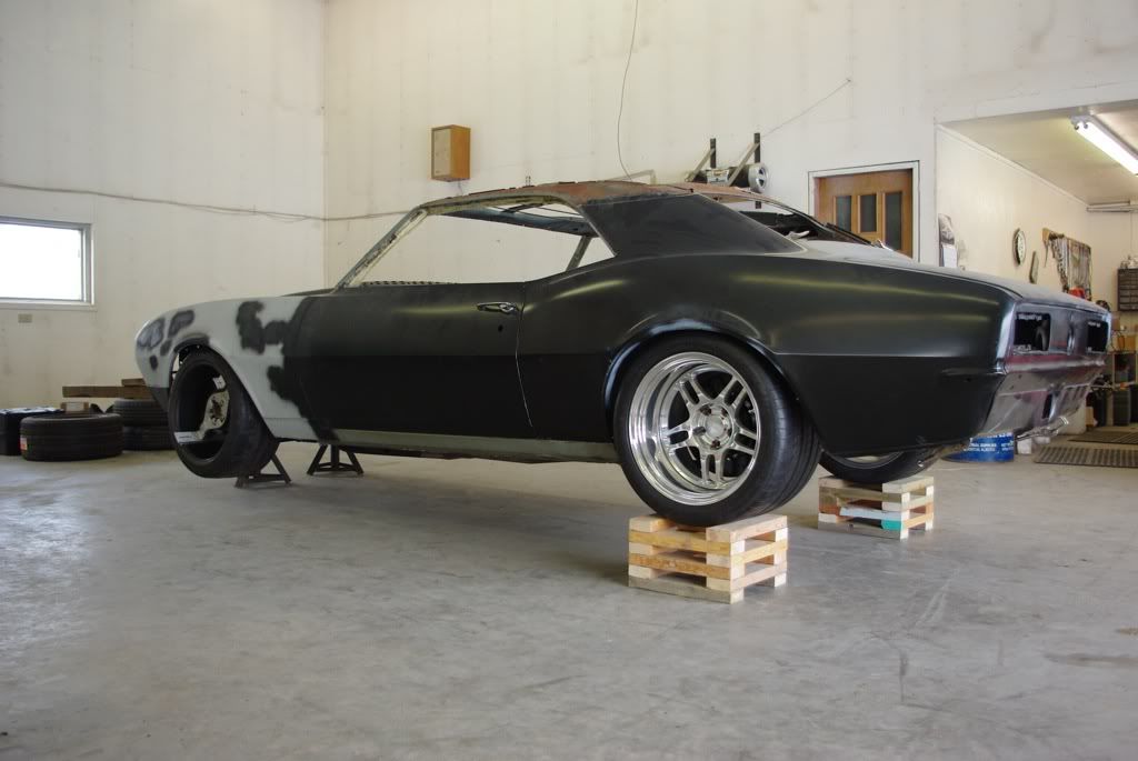

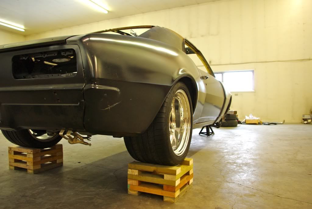

Here is a small update. I was able to get my rear end installed to see how everything fits, so far so good. I have lots of room, it should sit pretty low, and nothing will hit when I have people in the back, or am cornering hard.
Next I have to measure my off set for the front. I wanted to try and fit a 10" wheel with 275's but I think I will have to stretch the fenders a bit to do so.
I am undecided of what to do there.
Kevin Carter

Will the car go any lower than it is now ? Did you mod the outer 1/4 opening for clearence ? Are you using coilover shocks and 4-bar in the rear ?
Sorry for all the questions .....! What you are doing is what I am wanting to do to mine.
The car looks great so far !!!!

I could probably set it down another 1.5" with not to many problems but then the subframe will only be 2.5" to 3" off the ground. The way it is now when it is on the ground my knees are level with the body line through the middle of the door, and I am only 5'8". I have not trimmed the quarter lip yet, I am going to cut about half inch off of that, and I am using a DSE quad link with their double adjustable shocks.
