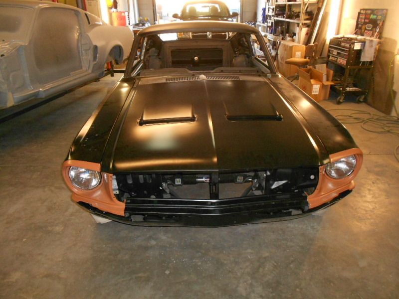

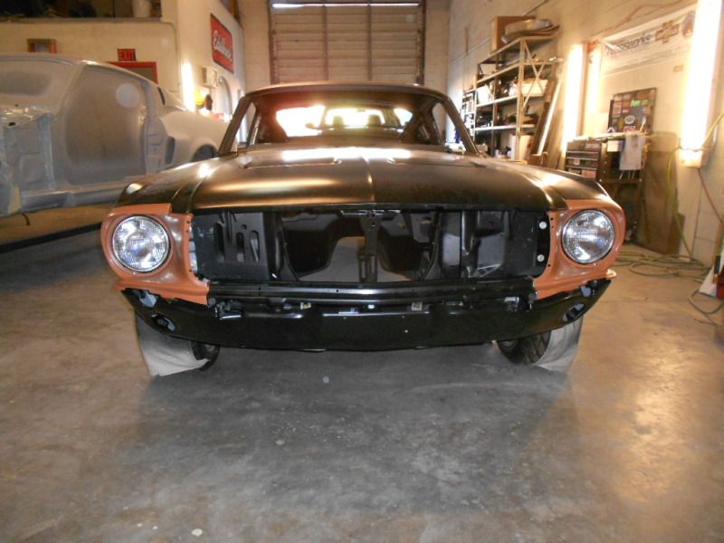

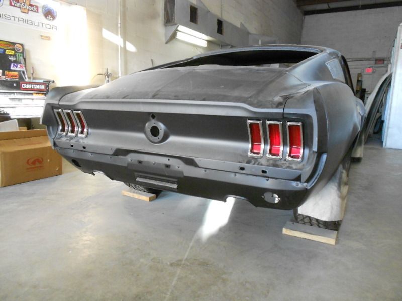

Something fits with just a little modification
The taillights fit after trimming the rubber seal a little
Once the holes on the fenders were elongated the headlight buckets fit
The amazing thing was after all the work on the door gaps the edge of the hood lined up with both headlight buckets from CJ Pony Parts. The Dynacorn headlight buckets have been on back order for over a month and I was told probably another two months before they would be available so we got them from CJ's. They are a little ripply and will require some blocking but they fit.

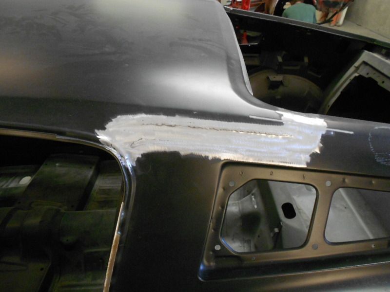

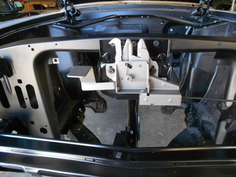

We have been working on a couple of things I can't show at this time. A modified lower front valance and a future story in Modified Mustangs & Fords magazine showing a period correct looking hood latch with an under the dash hood release.
But I can show this

I confess I'm not sure what you are showing us there - is that where you replaced the normal leaded seam with a flush welded panel ?
Yes so I don't have to use 1/4" of filler

This is what Brian has been fabricating. It is an under the dash hood release. The hood required a lot of fabrication along with this latch that came off of another Ford. To find out all the details you will have to read the build story in an upcoming issue of Modified Mustangs & Fords magazine.
